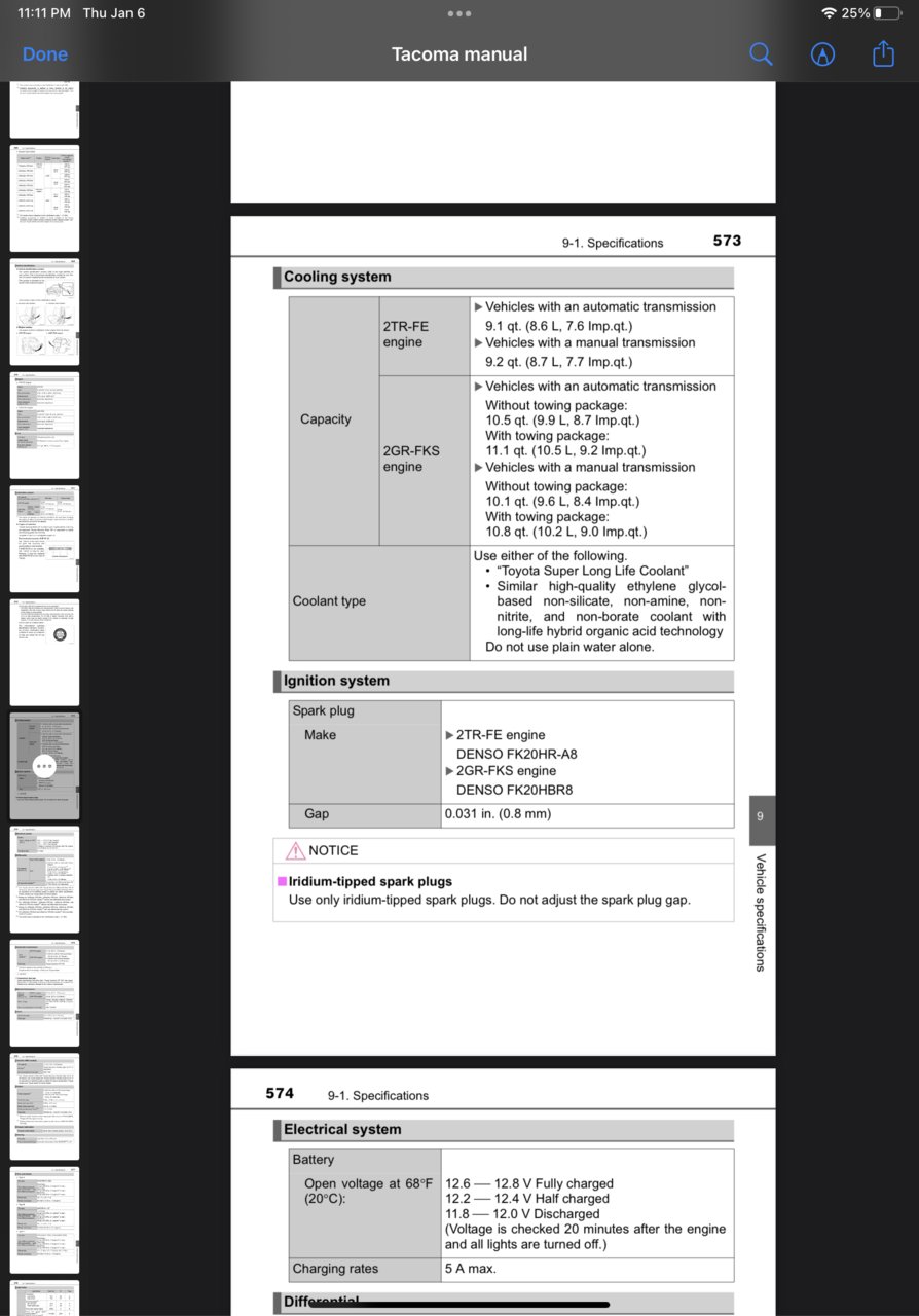

    2016 Tacoma 3.5L. What brand and gap plugs? Also, air filter replacement?

    Just did my spark plugs today, used Denso OEM plugs, take the air intake out for the passenger side and for the driverside you honestly just figure it out, unbolt a few brackets, unplug some connections and shimmy out the ignition coils, pretty straight forward, as for gap I didn't worry about it I just threw them in, truck runs great! Also I didn’t check the manual before but seeing it now it says to not adjust the spark plug gap?

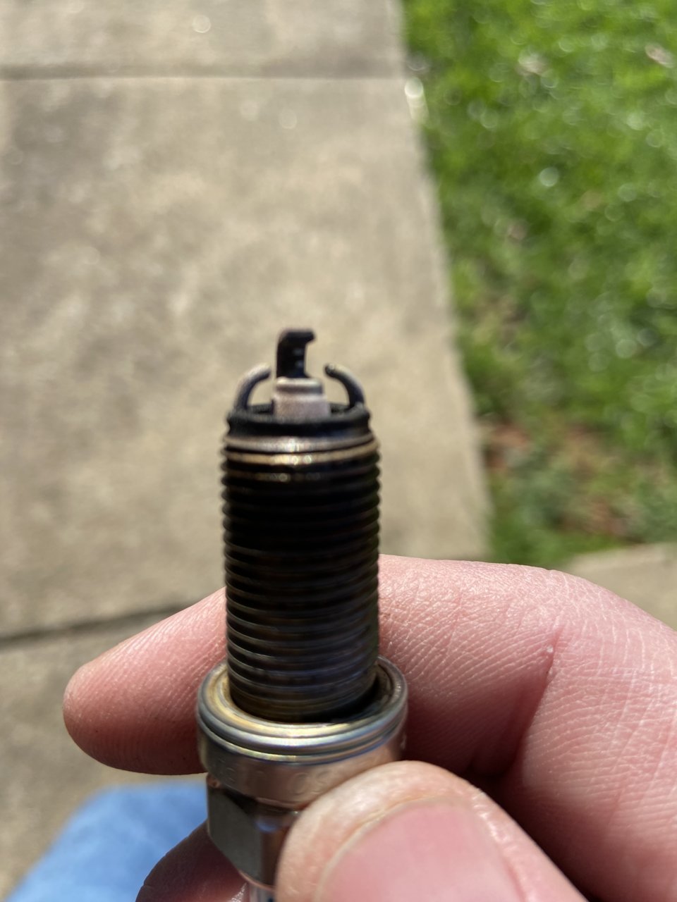

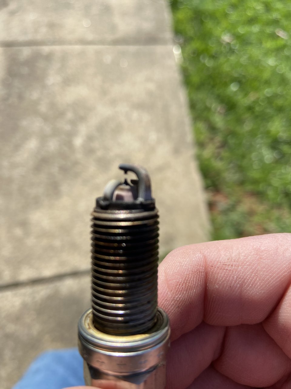

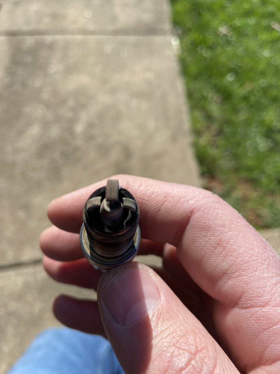

    I took one of the easier to reach plugs out of the passenger side. I know the picture quality isn’t the best (couldn’t focus close up because I have a shit phone) but does it look like it’s time for new plugs? I have 116,000 on the truck and have no idea when they were changed before I bought it, 10,000 miles ago.
