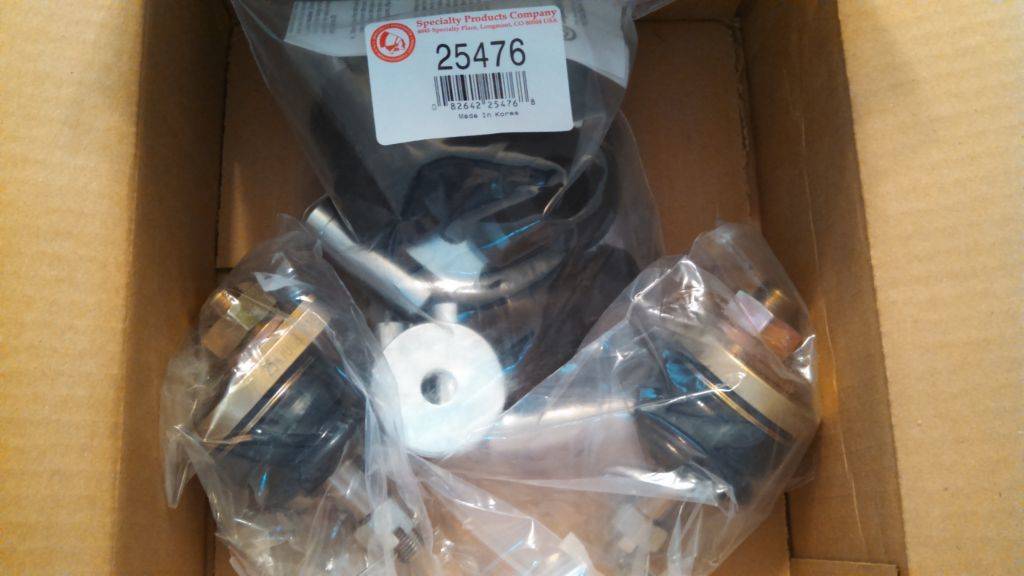

    I had a similar experience after finding my pass.side bushing was shot (original, not SpecRide bushings). Called SPC and was asked to send them an email with my info., also expressed concern about the Ball Joints since they are likely not far behind.
    Received an email with a tracking number and these showed up today:
    New SpecRide bushings for both sides and (2) new ball joints. Fantastic customer service from SPC!!!
    I will continue to run these as long as I can, and recommend them to everyone who needs (non-uniball) UCAs :cheers:
