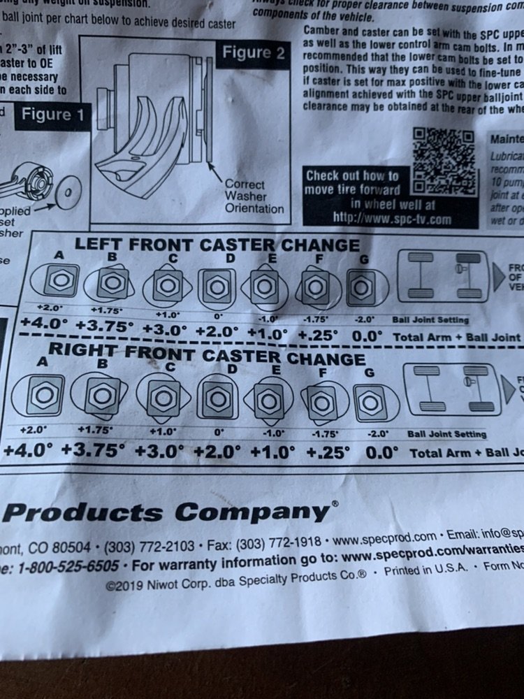

    Set your SPC's to "F" or "G" and have them do the alignment. When they tell you they can't get the Camber, tell them to use the Sliding feature of the SPC to get the camber.
    The thing that almost all UCA manufacturers have been getting wrong all these years is the addition of "CASTER" You only cause problem when you add Caster!
    When you lift your truck you loose the CAMBER! "G" setting on the SPC is no additional "Caster" "0" I believe "F" is like adding .25* Caster. This moves your tire away from you Cab Mounts. You will need to trim to from fender liner and minor trimming of the lower bumper plastic.
    So when these Companies build UCA with higher Caster essentially they are creating more of a rubbing issue on the Cab Mounts. Which then require CMC to be done or Cab Mount relocation. So their so called "solution" UCA's are actually causing additional problems! (unnecessary issue)
    This why I now Only recommend the SPC or the Icon's (But to adjust the Icon UCA correctly???) Your alignment guy need to be a JEDI Master!
