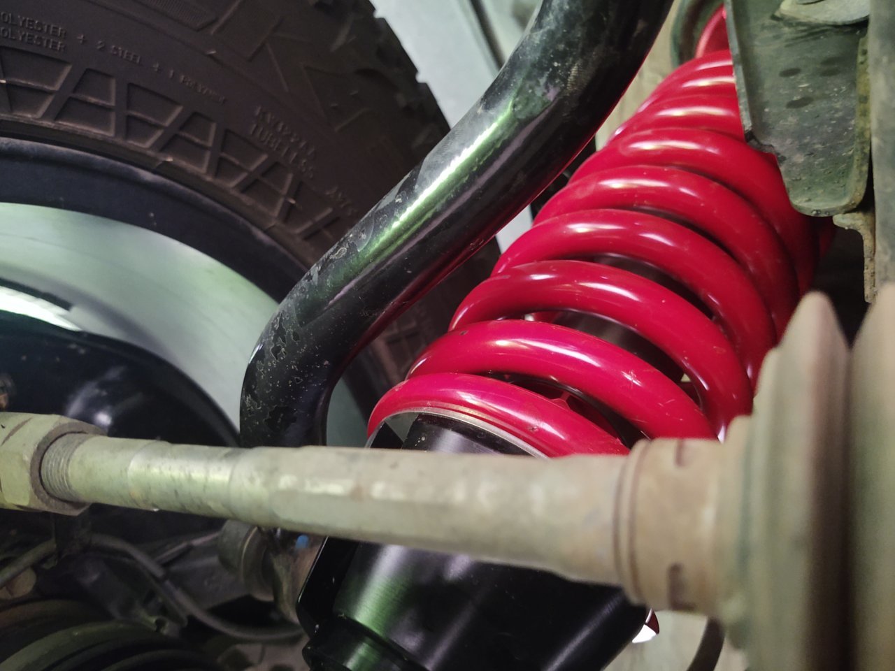

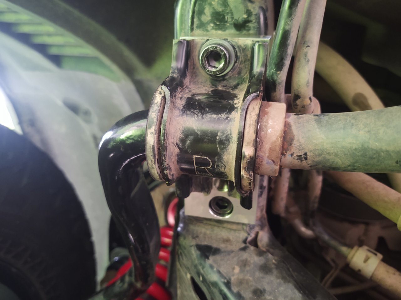

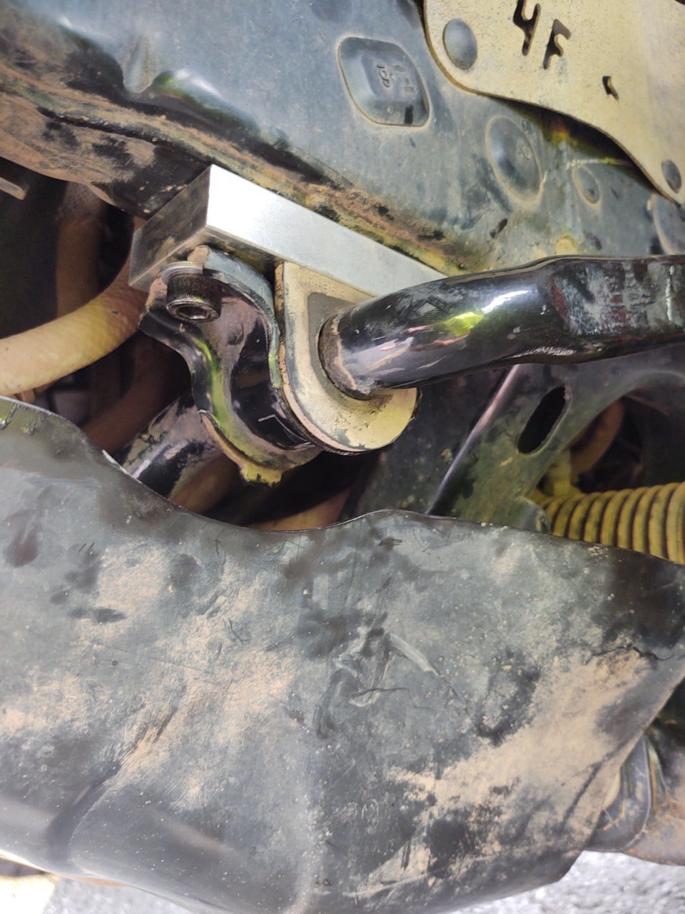

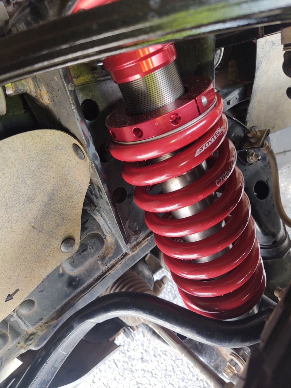

    Saw this thread, and had the same problem. Talked with the techs at toytec, and they said with 3rd gen tacos, you need to flip the original mounting bracket 180°. So the spacer goes so that the original bracket will face as far forward as possible, then take your original bracket and flip it, then mount it, this should give you an extra 1/4" on each side... Or so they say... I haven't flipped mine yet, but will when I get home, I'll post pics too if you want.
  13. Sep 29, 2020 at 3:54 PM
    JordanJake25
    JordanJake25 Well-Known Member
    May 8, 2019
    #292723
    61
    Jordan
    2019 tacoma
    Update: techs were right. Flipping the original bracket works fine, added maybe a 1/4" of space. The first pics are before, 2nd set is after.
