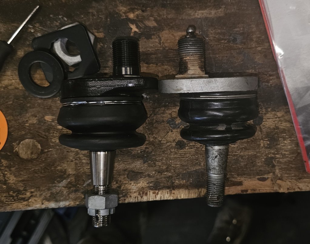

    Recently my SPC ball joints had a little bit of play in them and I had a small tear in one of the boots. I got the new design ball joints from SPC. I installed them yesterday. I like the the new sealed design.
    New vs Old
    th3clara, hyrule_trd, NABeast and 3 others like this.

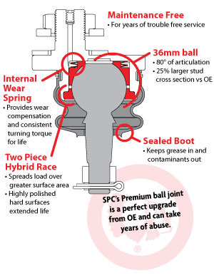

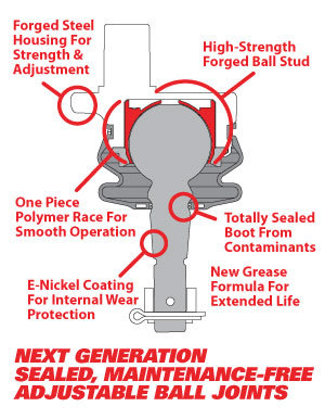

    I emailed SPC to ask them the difference with the new design and they shared with me the following response and attachment. I thought I would share.
    "You can see in 25001ill.jpg that it was a bit of a complex critter, and if one part is a little off it’ll throw the whole thing out of whack pretty quick. The greasable iteration was prone to contaminants getting in through the weepholes in the bottom of the boot. While a great piece of engineering they were just a little difficult to replicate on the scale we found ourselves producing them in.
    The 3510X series is a much more straightforward design, like I said Toyota and a couple other OEs produce their ball joints using similar, if not the same, methods. The nylon race is baked on to the ball to ensure the best fit, the assembly is swaged into the housing, and that’s it. K.I.S.S. in action."
