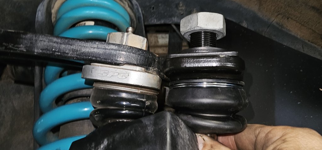

    SPC came out with a new ball joint that was released June of 2024. In the picture below the ball joint on the right is the new ball joint. The one on the left is old style. According to SPC they have not warranted any of this new style ball joint. That's only 8 months so it could be too early to know but so far so good. They are covered under warranty and are super easy to change out. It's a lot easier to change the ball joint out than it is to replace the whole uca.
    I really like this new style and not having to put any grease in it and it never leaking out. I've put around 6K miles but have been wheeling hard on all types of terrain and zero issues. I would recommend them

    If you are one year into your replacement set then you do not have the latest ball joint because SPC told me that they released their most current version in June of 2024

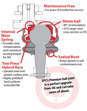

    They switched from greasable to sealed in Nov 2023. I got my replacement in Dec 2023.
    I'm not 100% sure what the difference is between those and the painted black version now. I'm guessing the ones I got were just the same greasable unit with the holes plugged. Kinda looks like they switched to a solid top bolt now instead of the hollow one with a plug in the top, and changed the torque specs on that bolt. And it also kinda looks like they went to painted steel instead of aluminum or whatever the original material was.

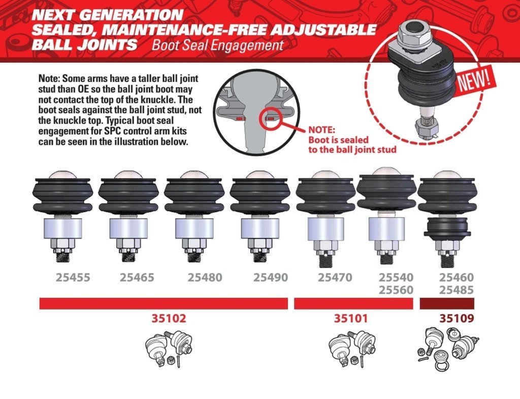

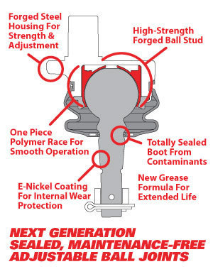

    Yes so the ball joint you have is sealed and non-greasable but it is basically just the same ball joint on the inside from previous years but they made it to where it has a sealed boot. The ball joint that was released in June of 2024 is a complete redesign on the inside and more like OEM.
    Below is a link to the most current ball joint. The old ball joint is still available and is being sold as a complete UCA but I would not buy it. My recommendation to anyone that wants the SPC make sure it has the new style BJ part# 35101 is for Tacos
    https://www.summitracing.com/parts/SPS-35101
    The newest/ latest SPC bjs

    This is very interesting, I’m glad they are seeing the failure rate and addressing the problem. The last “maintenance free” set I bought were the same , they just had plugs instead of zerk fittings. I swapped the zerk fittings and put grease in them anyway.
