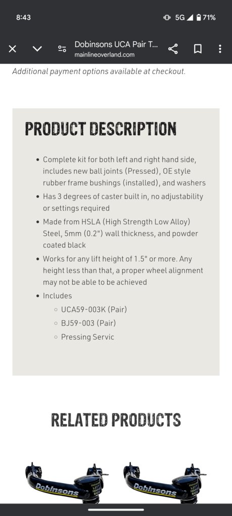

    is says 3° of caster built in, with no adjustability. Do you have a link?
    Also is this caster towards the firewall or caster towards the front of the vehicle? Caster towards the firewall is the same issue as the JBA, where as the SPC can push the ball joint forward (a long with moving the LCA and lower ball joint forward) and clear the firewall.
    If the caster on the upper ball joint moves towards the firewall, and you have to max the lower control arm forward towards the front of the vehicle. Does my hub move enough forward to clear? Does the cam adjustment with the LCA allow for enough movement to clear the body mount, and allow the caster to remain in spec due to the 3°?
    You gain Caster on the strut yes, but does the hub and subsequent wheel move forward in the wheel well, because if it's just adjusting the caster and not moving the wheel hub assembly forward then it pretty much defeats the purpose of clearing larger tires. Granted that might be why the SPC exist, because otherwise that's impossible.
    Unless I'm just grossly misunderstanding something here. You can't move the UCA ball joint forward because they don't have cam adjustment bolts like the LCA.

    No not that one. This one.
    https://exitoffroad.com/product/dobinsons-billet-aluminum-ucas-toyota-tacoma/

    Yeah they look like one of the best adjustable control arms on the market. Quite expensive. They were not available when I was looking for a uca but if I could go back I may have got the Dobi instead.

    Unfortunately looks like they might not be available for a while. Wonder if anyone else has a similar adjustment UCA, kinda makes you wonder why SPC didn't do the same style of adjustment.
    Looks like quite a few manufacturers make similar UCA's notably ICON and Dirt King
