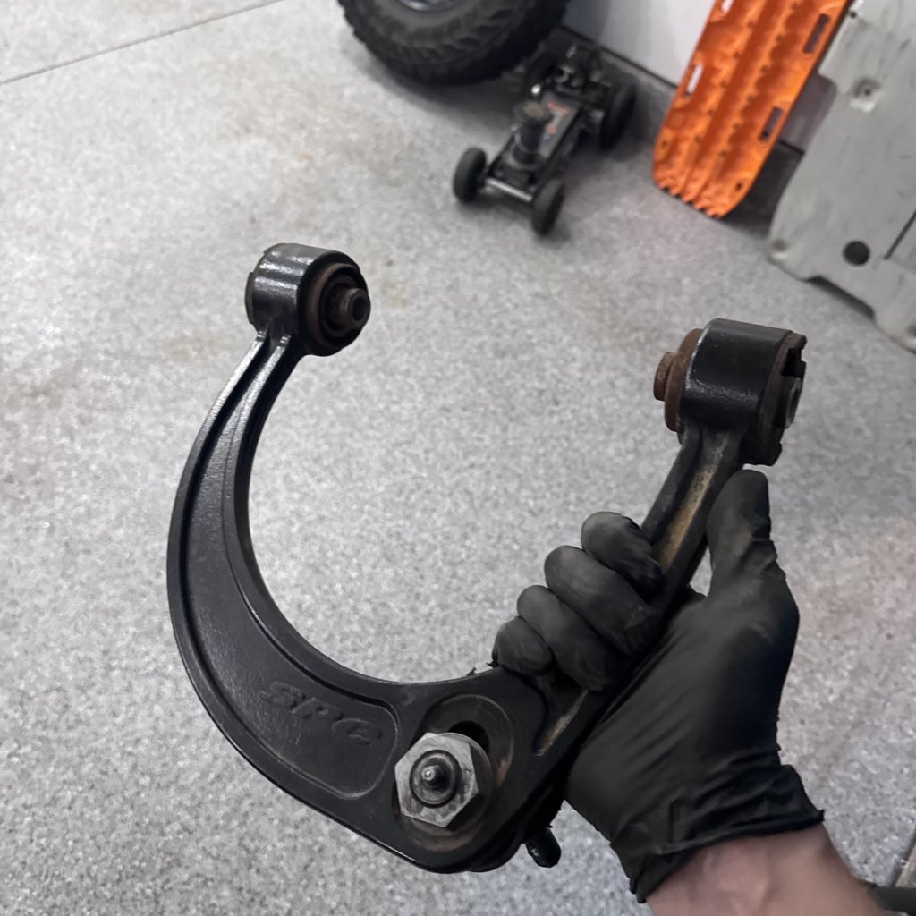

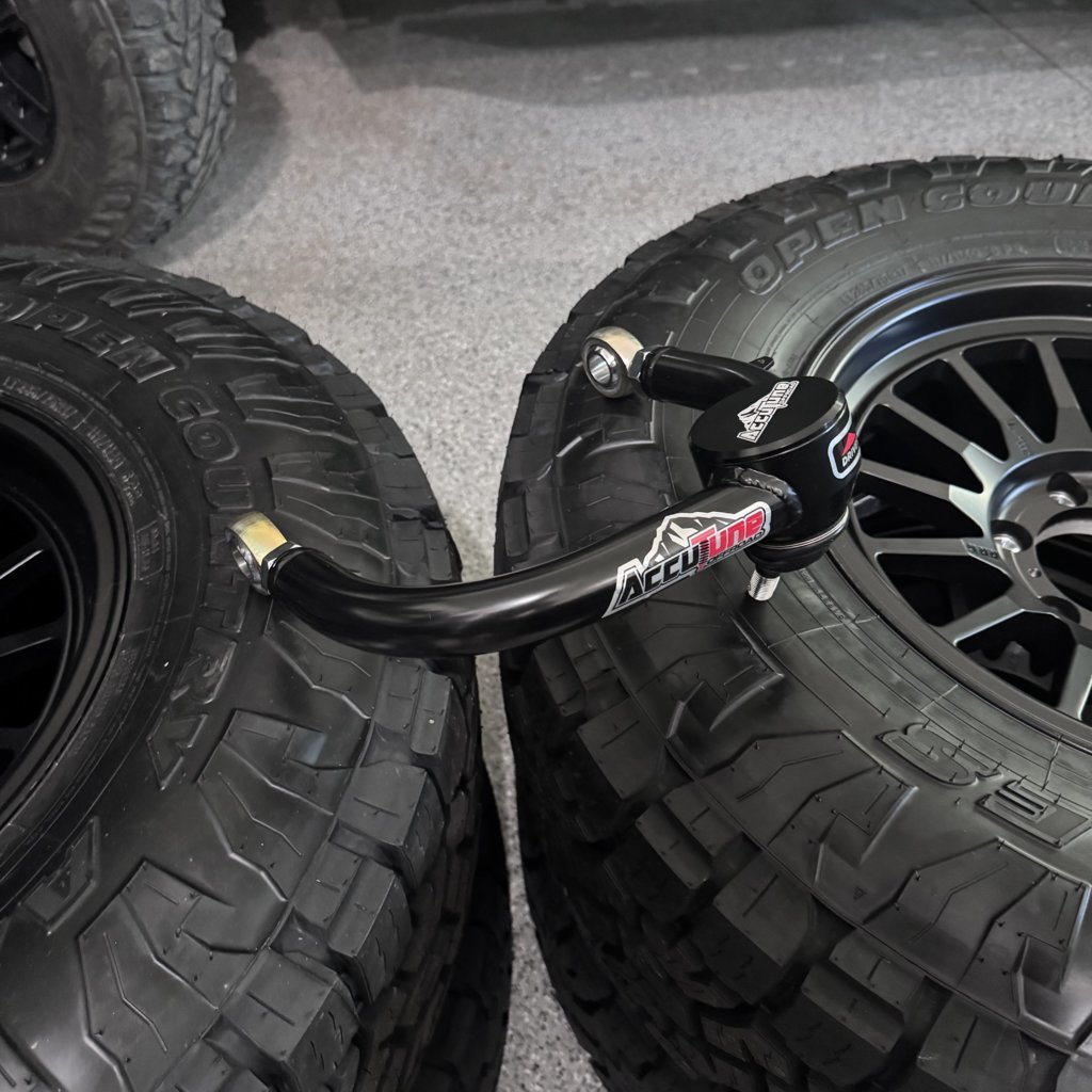

    After 2.5 years & 20,000 miles I removed the SPCs from my truck. Ball joint was still good however the x-axis joints were clunking pretty bad and had quite a bit of play. I purchased them new ~4 years ago so I wasn't able to warranty them. Decided to switch to AccuTune upper control arms.
    AccuTune Offroad likes this.
