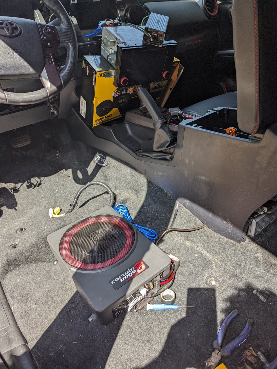

    Sub: Cerwin Vega 10". Actually mounted under the driver's. I poured through as many reviews as possible, and for a not-so-hot brand it got surprisingly good reviews. And the experts were right. No underseat will be great, you just can't cheat physics, but this one really is surprisingly good. It can punch out a wide range of tones and has decent response and volume. It can put out a solid low tone or it can rapid fire a drum solo, and it can even almost thump. It tries hard. I'm surprised. For someone who wants a full balanced soundstage and not a booty blaster, it's a great choice.
    Amp: key 200.4, mounted directly behind the climate controls, deep within the dash. Another cheap component that the reviewers love, and I agree. It's a fantastic little piece of kit. The dsp calibration using the included mic and "pink noise" file, fantastic feature. It really is the star of the system.
    Picture showing amp and sub: forgive the dog hair, I was vacuuming as I installed.
    Cool thing about that location, it's real easy to hide the sub control knob in the center console- keep it all discreet. And that's another praise for the key amp- once I got it all dialed in, I really don't have to touch this knob at all. The music is consistently balanced.

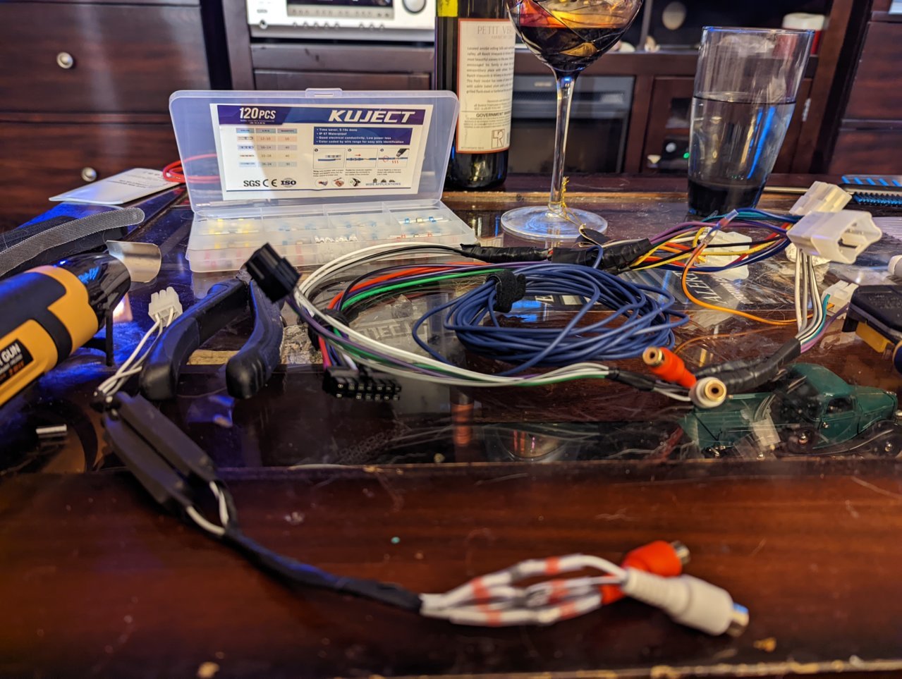

    Wiring harness: ho-made . I used this guide (2016-2019 my only):
    https://www.tacomaworld.com/threads/tpp4s-no-nonsense-guide-to-kicker-key-t-harness-16-19.642415/
    For 2020 on, it's much much easier, you can buy the harness on Amazon for 13 bucks and then cut and connect to the kicker. https://www.amazon.com/dp/B09DTY8PMD
    https://www.tacomaworld.com/threads/kicker-key-in-a-2020-with-8-entune.641008/#post-22145143
    I will say that self-soldiering connectors are the way to go. Highly recommend.

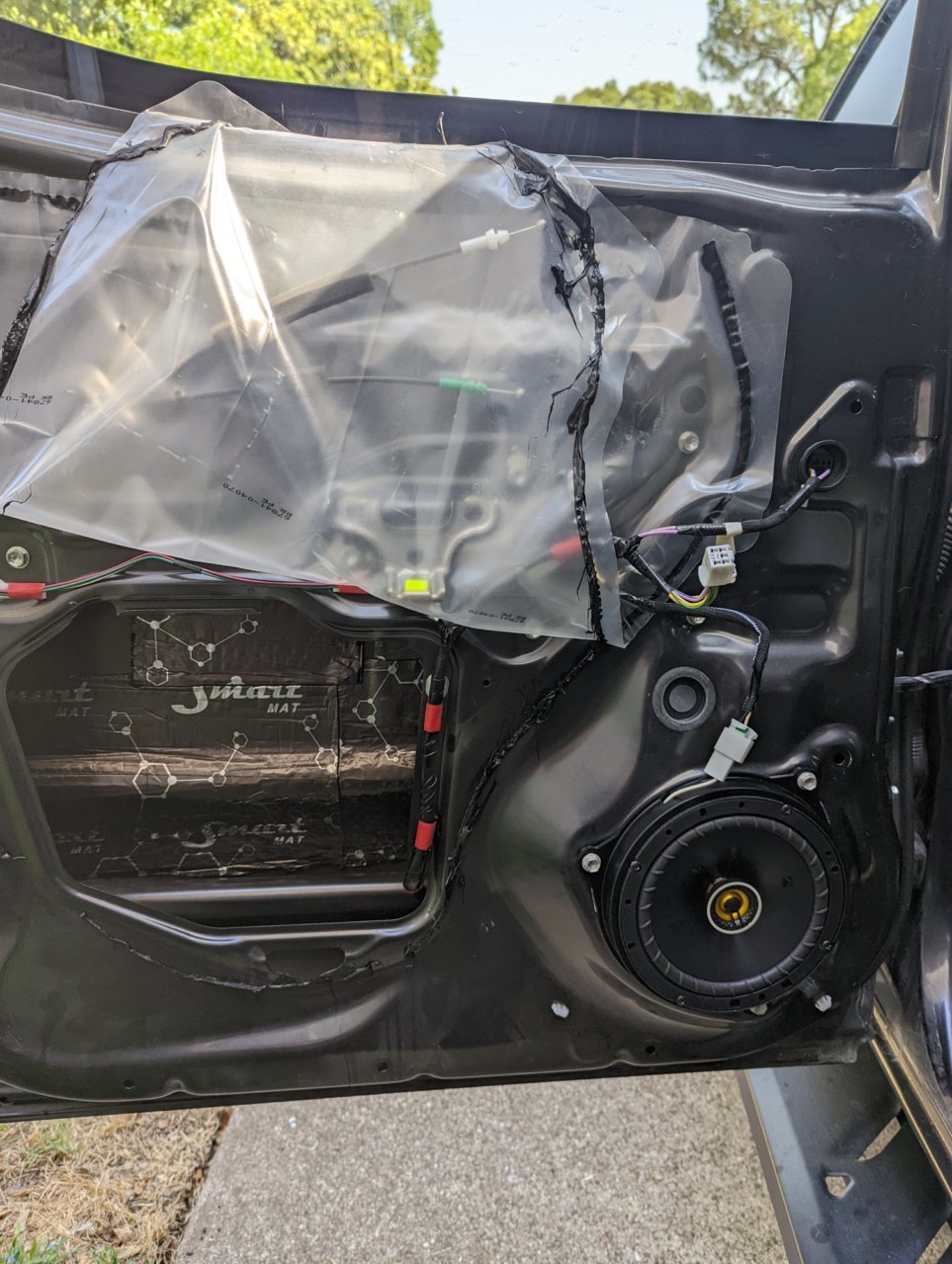

    Speakers: the CSC series, 6x9 fronts, 6.5 rears. Subaru tweets that I had installed a few years ago.
    These... They are alright. Not bad, not fantastic. Truth be told I'm actually happy with their performance despite acknowledging that they are far from perfect. Mine came in a box of parts that another TW member was trying to unload, and if they hadn't found their way into my garage like that, I honestly would have chosen another set of speakers. Other experts are right - the CS aren't bad speakers, but there are better speakers out there for the same price. Having said that, I'm satisfied enough to live with it, I have no plans on upgrading further. Especially after break in, they aren't nearly as ear piercingly harsh as they were when new. Again, not my first choice, but I'm happy.
    Here's the big bad secret:
    ^^^ you are already in the door anyways, so take a few minutes to install sound mat inside and out. That in my opinion makes a bigger impact on sound than the speakers. Huge difference. Yuuuge.

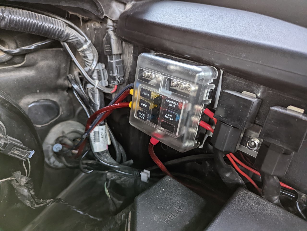

    And one final note: running a separate fuse box for all aftermarket bullshit keeps the wiring clean and easy to troubleshoot. It's a definite recommend if you ever have an inkling to run more than one accessory.
