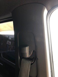

    Hi All, I would like to add the following speaker on the center pillar right above the seat belt shoulder anchor. Can I just screw in the bracket and be done with it or do I have to remove the plastic and support it some how? I've never taken it apart so I'm hoping the screws can hold the speaker but worried the screws might come loose due to the vibration. Any help is much appreciated.

    have you considered putting in car speakers instead. that thing would look terrible, likely sound terrible, and pull out of the plastic. just a terrible idea all around

    Yeah, bad idea. Your truck has built in slots for speakers that will be better than that thing...what's wrong with them? Is that for a comms radio or something?

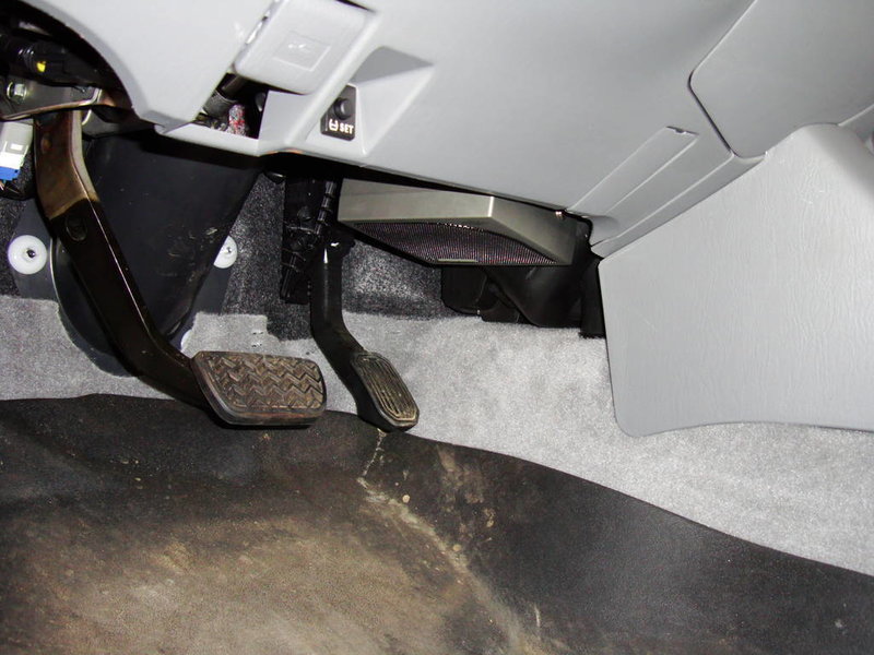

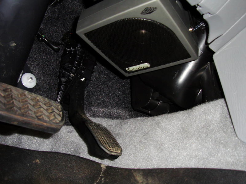

    Benson X
    Benson X My build thread sucks...
    Nov 13, 2010
    #46123
    5,680
    Ben
    Olympia, WA
    '11 MGM DC/LB
    If you don't draw blood, you're doing it wrong!
    LAMCKMA007, 12TRDTacoma and ST77 like this.

    Could your head (or a passenger’s head) hit the speaker mounted to the b-pillar trim? I don’t like the idea in general.
    Were one to do it, it would probably be a good idea to mount the speaker with bolts rather than screws, and to use a thin metal plate behind the trim to distribute the load.
    But you’re getting some good suggestions for alternative mounting positions and I hope you’ll see options that make sense for you.

  10. Nov 20, 2019 at 10:40 AM
    Benson X
    Nov 13, 2010
    #46123
    5,680
    Ben
    Olympia, WA
    '11 MGM DC/LB
    I don't recall exactly what hardware I used to attach it to the plastic, but (knowing me) I probably just used some self-tapping screws. I may have used a small machine screw with a nut & washers on the back, but I doubt I would have worked my fat hands behind the plastic to make that work. Maybe I did :notsure:
    Thank you - I've since upgraded that CB to the Anytone Ultra-Compact 10M CB. The thing is SUPER small and powerful (15w) - the only downside is the fixed mic cable. I've seen a German fella who modified his with a standard 4-pin mic. and added a rotary channel knob in place of the mic. cable port. Seems like a lot of work just to have a standard mic. though.
