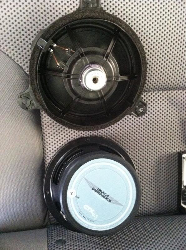

    I kept my stock head unit as well since I enjoy the factory look.
    I installed this...
    Using this...
    Turned out nicely. Only drawback is the slight hum at low volumes. But that is the price I pay not using aftermarket HU for a cleaner source.

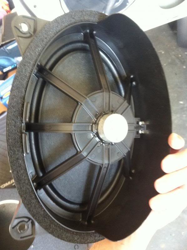

    btw the stock speakers have a magnet the diameter of a quarter- its so small!
    but i chose to switch out to jbl oem speakers and they fit exact, plug right in, and sound really good- with these (but any heavier speaker) the door now sounds more like a lexus when closing, not so much tin canny

    ^ factory front speakers
    ^ rear factory vs after market
