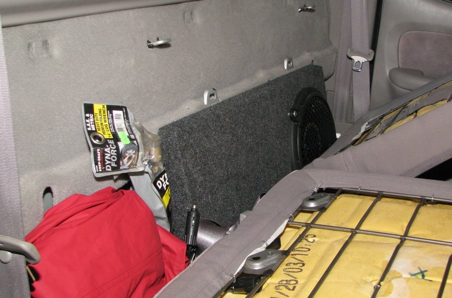

    It is tight, but you can add a sub without losing passenger space and still have some room for storage behind the rear seat.
    Here is a 10" Pioneer shallow mount in my 2003 double cab. Still plenty of room for a jacket, lug wrench, 12V air compressor, tie downs........
    I went with inexpensive coaxial Infinity speakers ($70 a pair). Some people have done some nice installs with component speakers. They normally have to get custom with the tweeter since the stock location is pretty shallow. If you stick with just door speakers, I suggest sealing up the door access holes with flashing and using plenty of mass loader (Dynamat or similar). My door speaker bass got much more solid after sealing the door access holes (even with the crossover set to 80Hz).

    Thanks for all of the info guys! Matt, where did you get your pioneer sub and box from?

    I bought it from Car Audio Factory http://caraudiofactory.com/2001-toy....html?osCsid=8112a6e2134986b9faa64f82b1701be4
    Here is a thread with some more info on it and pictures.
    http://www.tacomaworld.com/forum/1st-gen-tacomas/97001-doublecab-subwoofer-trouble.html
    One more. Note the filing/Dremeling needed to get the 10" in there. It isn't too much work..... a lot less time than trying to build a box with my lousy woodworking skills :)
