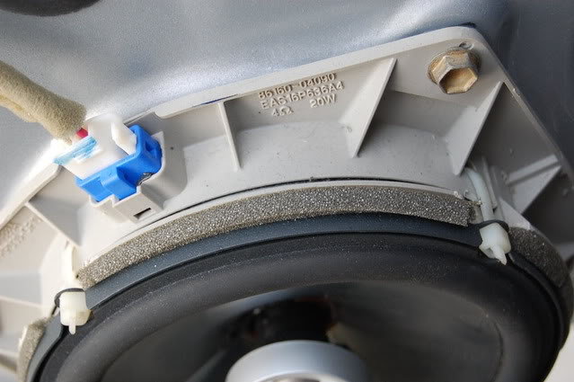

    I cut out my factory speakers so I had just the plastic housing. It has bee a few years but I believe some dremeling was also involved. Then I drilled holes in the sides of them and attached the speakers with zip ties to the housing. Then I just bolted the housing back in like original. I know the zip ties sound cheesy but it worked great and has lasted 5 years already. The factory housings protect from water drips.

    That sounds like a good idea. Did you replace the 6x9's with 6.5"? If so did the 6.5's fit over what you cut out without gaps? I'm replacing the rear 6.5's. Did you swap them out to? And what about the tweeters?

    I did the rear just like I did the fronts.
