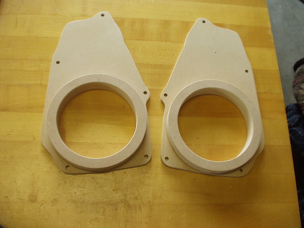

    6x8's, 5x7 and 6x9 are oval speakers and when you see a single number such as 6.5 it is a round speaker
    edit: component speakers mean the mid and tweeter are separate and usually have an external passive crossover
    I may have missed it but what year truck do you have?
    To fit any aftermarket speaker you will need the proper baffle/adapter however there are limitations. As soon as I find out what year truck you have I can expand on that.

    OK I just realized if you drag the mouse over the box below your screen name it tells me the year of your truck. :eek: Pre 2005's are very limited as far as what you can fit without modification. In order to fit a 6.5 you will need to do some surgery to the door metal as well as the inner door panel. If you want to "keep it simple" my suggestion would be to get a set of 5 1/4" components with the proper baffle/adapter as shown below.
