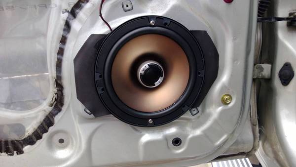

    I have the Polk Audio 651s also. Best bang for the buck IMO.
    I am powering them with a 2-channel 75 watt amp (Sound Ordinance, got it on sale for $50).
    Great speakers. But do yourself a massive favor. Sound deaden your doors properly. It makes a world of difference.
    The Polks won't give you bass like you expect from a subwoofer but with properly deadened doors they give some great sounding/hard hitting mids.

    Which Polk audio 651s y'all have?!

    Of course "what's your budget" is the first and foremost question.
    I was just giving insight to my experience which is on the low-end of what you could spend on a system.
    And no matter how awesome the speakers you put up front paired up with a head unit and/or amp... they're not going to give you ultra clean sound if you don't do anything about how resonant the doors are... or to break up the backwave a bit.
    I hope you're talking about $5000/pr for home theatre speakers because spending that much on audio speakers is asinine IMO. But hey, if you can afford them (for either home or car) then all the power to ya.

    The difference is night and day. I spent $120 on sound deadening material (covered both doors, rear wall and rear quarter panels), $90 on a head unit, $50 on an amp, $100 on a pair of speakers... spent my own time installing everything and it sounds great.
    Could it sound better? Of course but for under $400 total I feel like I got the absolute best bang for the buck.
    In due time I will add another pair of Polk 651s in the rear and an 8" sub in the rear passenger side storage cubby, powered by a 300 watt amp.
    Once that happens my system will sound amazing.
