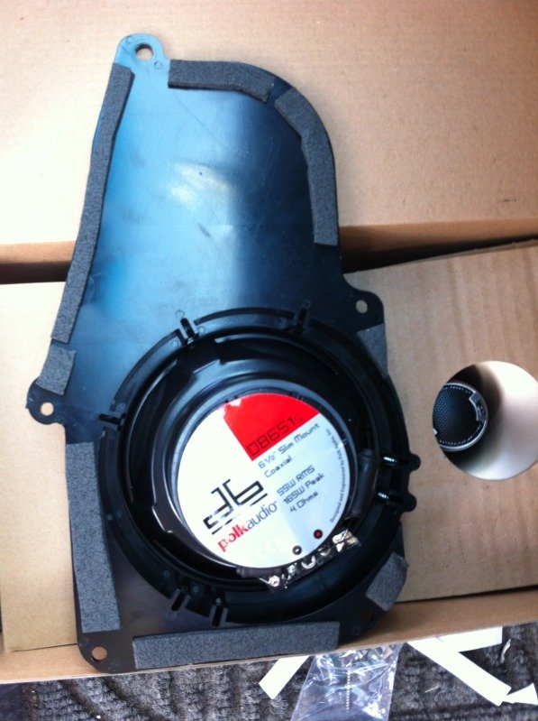

    I took the rear speakers out because the sound from them are awful compared to the Polks up front. I've always been a proponent of "music is to be played in 2 channels, 3 if you count the sub" train of thought. For now the rear speakers are not needed but I will definitely add them in the future (after the amp-sub) for some back fill.

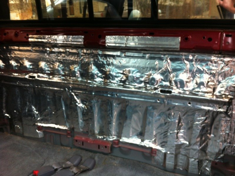

    Some insight: That package#1 Rick sells is perfect for sound deadening the rear wall, two doors and strategically doing the rear quarter panels (the former two being the most important as they are the most resonant). After a TW discount and speaking with Rick it came to about $120+ delivered to my door... within two days.

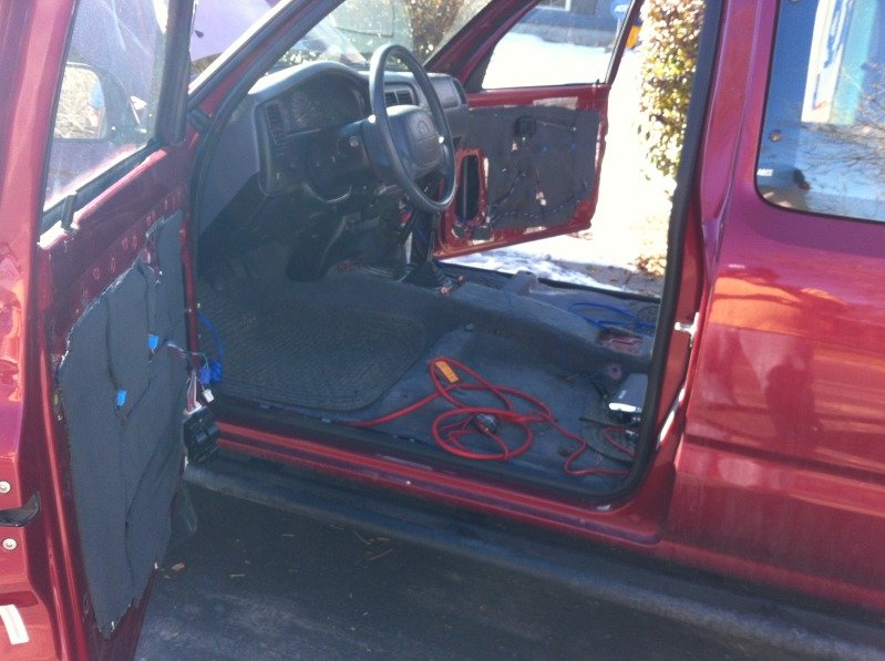

    I don't have many pics from my adventure but it is pretty straight forward. The raammat (BXTII) is used to stiffen the panels that are very resonant. The more play a panel has, the more vibration is has the more road noise, etc resonates through your cab. So the rear wall and our doors (both inner and outer panels) are very prone to this. I went overboard with the raammat and still have some left over.

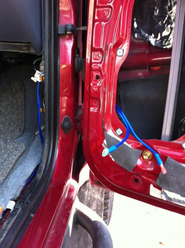

    I don't have pics of the door panels getting covered in the raammat but this one shows two valuable things. One: You need to reach up in between the inner and outer panels and apply the raammat on the outer panel. Rick said 50% coverage in there is sufficient, I did more like 75-85% coverage. Two: Cut a 6"x6" piece of Ensolite and place it on the outer skin directly behind the driver of the front speaker (and the same for the rear speaker if you're going to run them). This breaks up the backwave without sacrificing any mid range. What this essentially does is make your mids so much tighter/cleaner

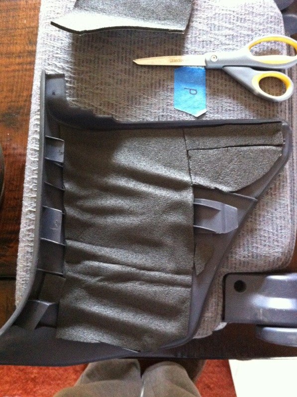

    Once you are done stiffening all the panels with raammat, cover everything in Ensolite. This material really reduces a lot of road noise.
    And like I said, I still have a bunch of material left over so I also strategically covered a few places with Ensolite. Namely the back of the kick panels (which is an area prone to road noise) and I also lined the back of the speaker mount so there would be no rattles between the plastic and the metal door panel when I'm really driving the front speakers.
    The difference is truly night and day.
    Before any of this if I was going 45 or 50 mph or more, I really would have a hard time having a conversation with someone in the passenger seat at a normal speaking volume. And I would have to crank the stereo up if I wanted to hear the music... and even then it sounded drowned out and muddy. Now, if the music is off and I'm on the highway (with the windows closed of course) it is very quiet inside the cab. It's not like a Bentley quiet, but it is a vast improvement over stock.
    Not to mention the doors now close with a solid "thud." A clear indication that the inner and outer panels are solid.
    Before deadening, take your fist and bang on the outer door panel from the outside. It's like beating on a drum. After deadening do the same thing. It barely makes a noise... and it's a very dull thud with no resonance at all.
