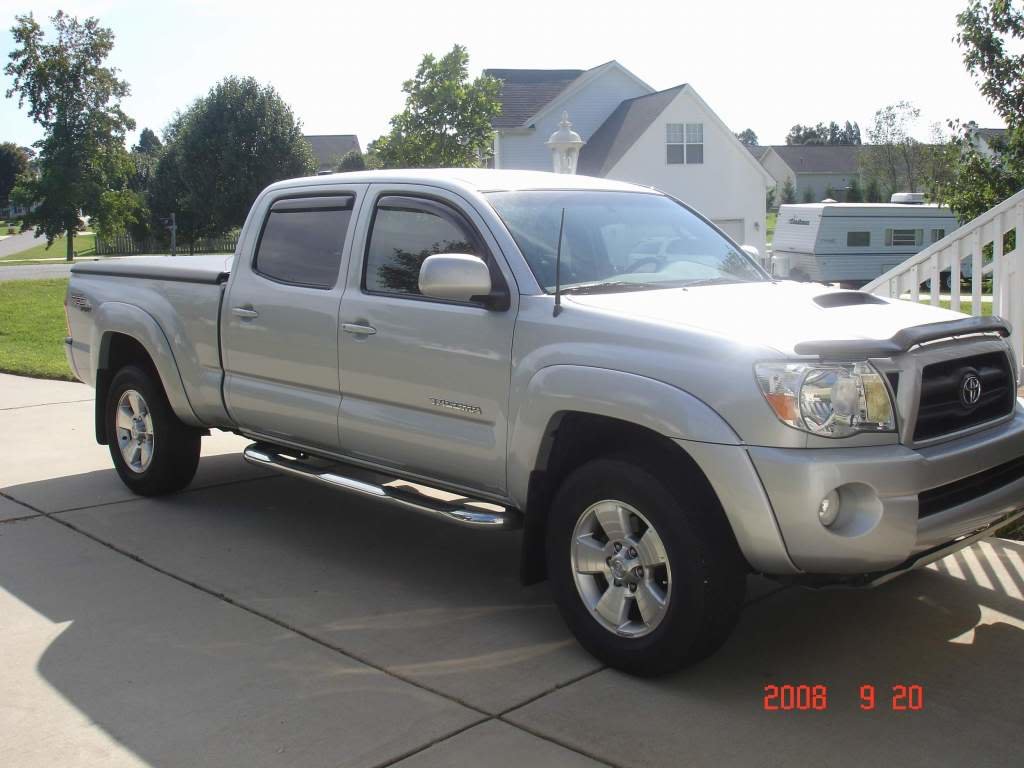

    Got it certified from a Toyo dealer with just under 30,000 miles on it - was looking at a black 06 Off Road 4x4 DC but I they would not come off for it like they did this 05, the price was too nice. I really am glad I went with a LB, love the silver, and now dig my non functional sport scoupe :cool: This is my 4th taco and first 2nd generation model. I was surprised how much lighter the pre-runner really feels than the 4WDs I have had before.
    This truck also has no seatbelt chime, nor does the horn sound when locked with the remote- so I assume these mods were done or are all 2nd Gens that way..?

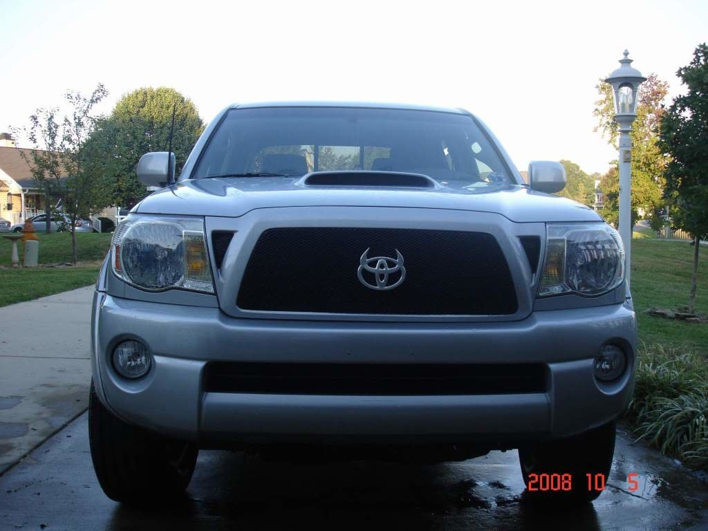

    First I had to do something with the factory grille, get a short stubby antenna, remove the hood protector and debadge the tailgate
    Thank you Grillcraft
    If you haven't done this yet and do not have a sawzall to cut out the plastic insert, invest in this $8 beast from Lowes-makes nice precise cuts and made for very little sanding

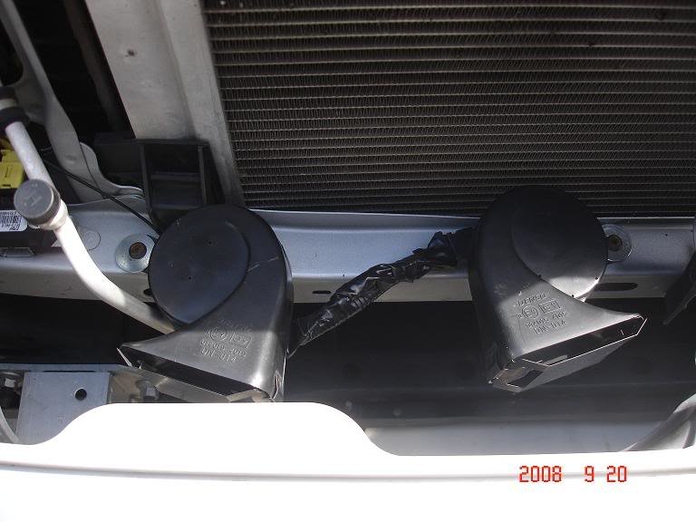

    moving the horns and painting the inside with a high heat flat/low gloss black spray makes a big difference, too IMO

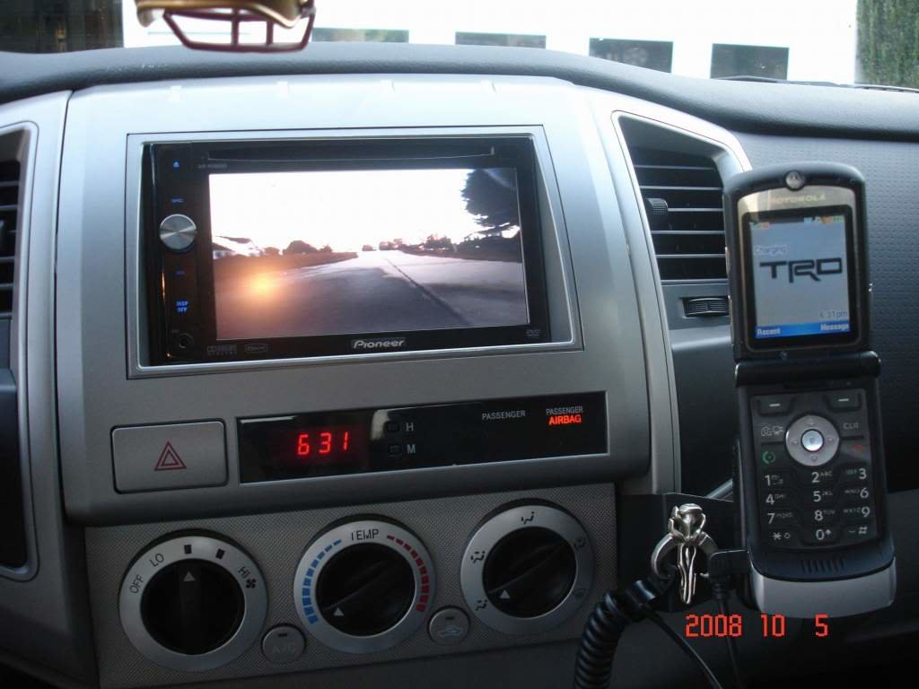

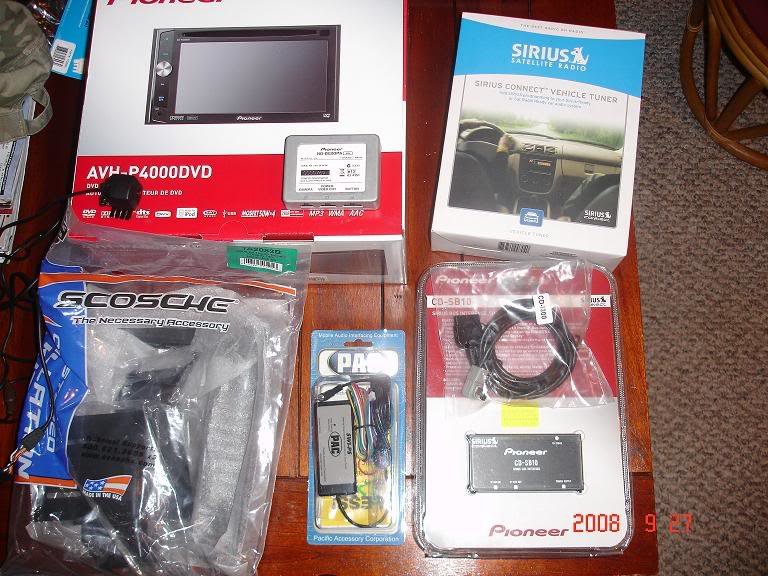

    I wanted to utilize a rear view camera system with this LB so I went with the Pioneer AVH P4000 DVD HU for the video, iPod ,and Sirius capabilities. Its also pretty easy to navigate and has excellent sound customization for the $
    Inventory:
    Scoshe Double Din kit
    PAC SWI PS
    Pioneer CDi 1200 iPod adapter
    Pioneer CDS10 Sirius interface
    Pioneer NDBC20 Mobile Camera
    Infinity 6022i 6.5s
    Infinity 9622i 6.9s
    ProFit VSM bracket
    HU

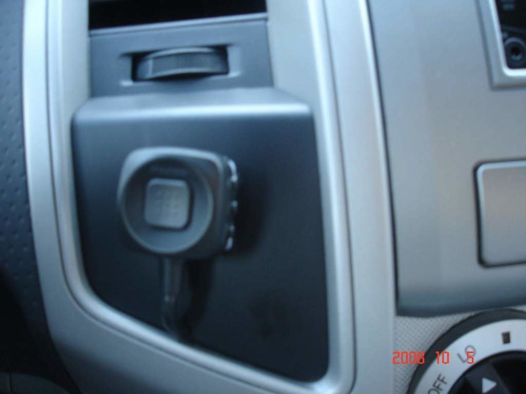

    Camera Multi Function Wired Remote

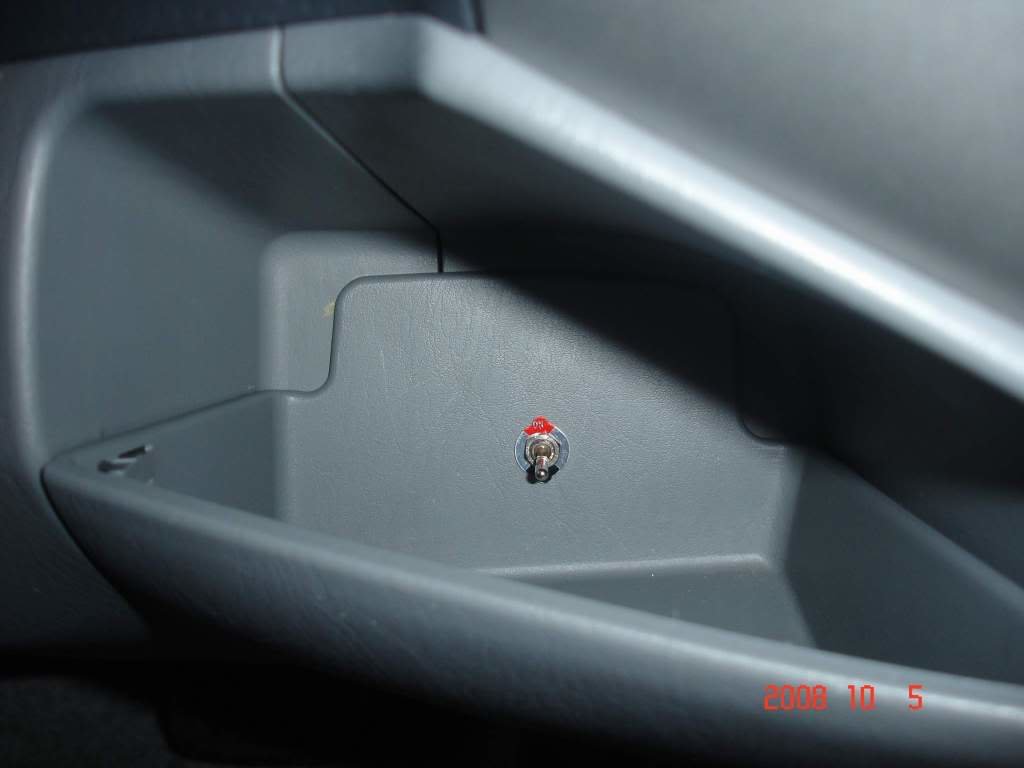

    Toggle for Rearview Video Feed

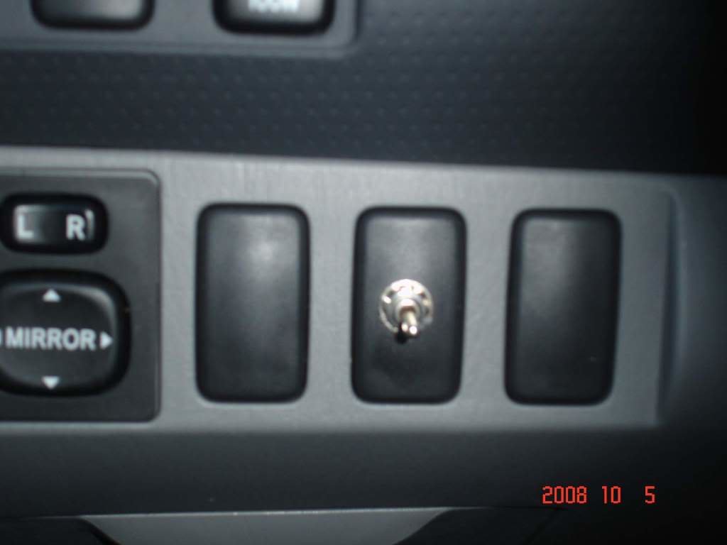

    Toggle for DVD Source access(I grounded the E-Brake wire from the HU and ran a switch)

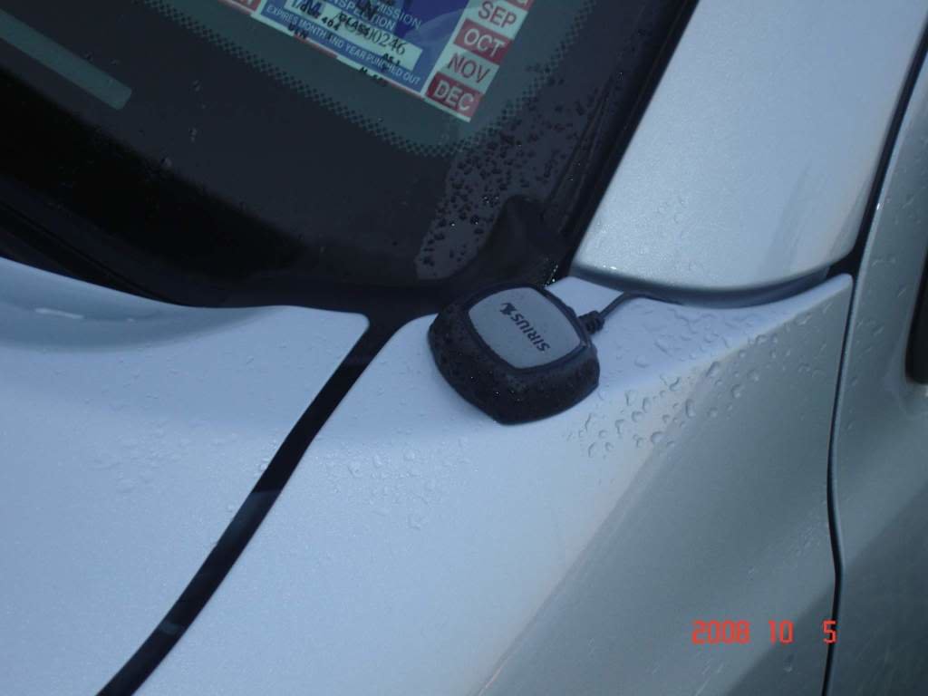

    Sirius Antenna Placement

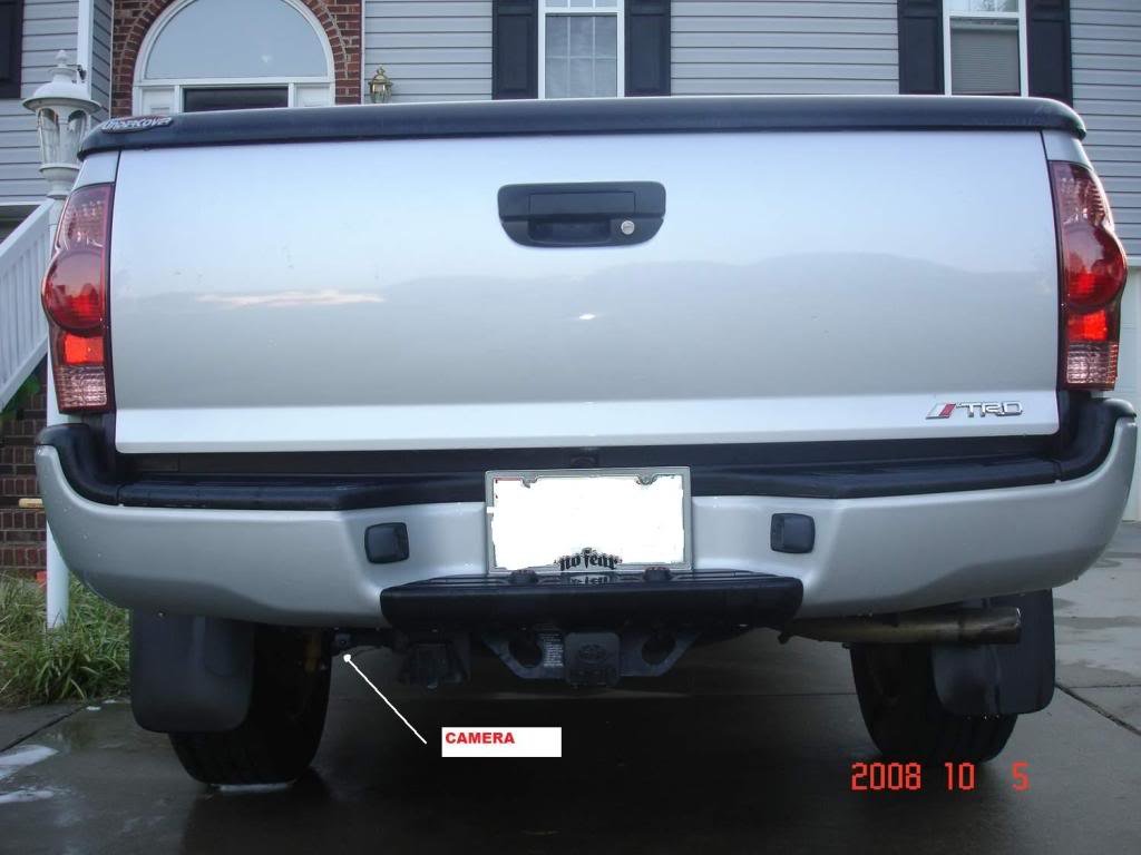

    Camera placement (I don't have a clue how Pb mounted his camera lens INSIDE the license tag lamp housing, he is my hero)

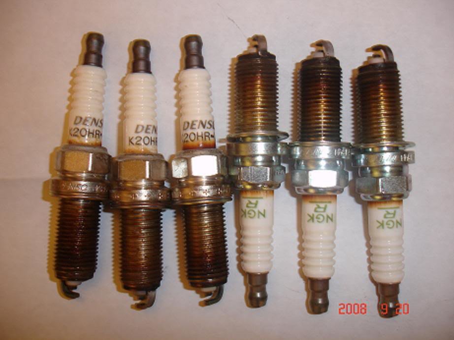

    I also had the dealer do the 30000 mile maintenance and they replaced my plugs with 6 of the the copper standards and with good reason:

    where'd you get those horns
