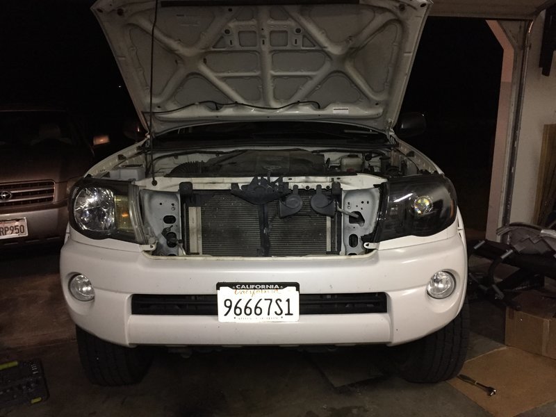

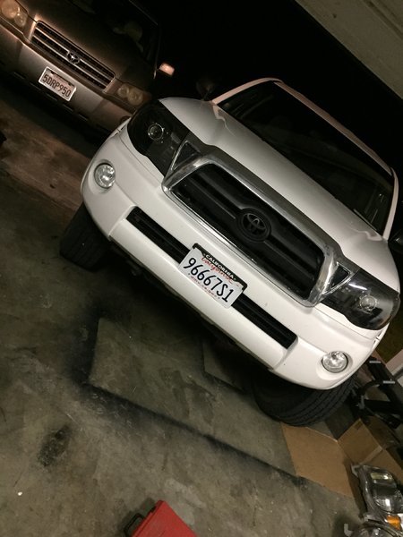

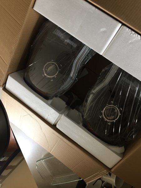

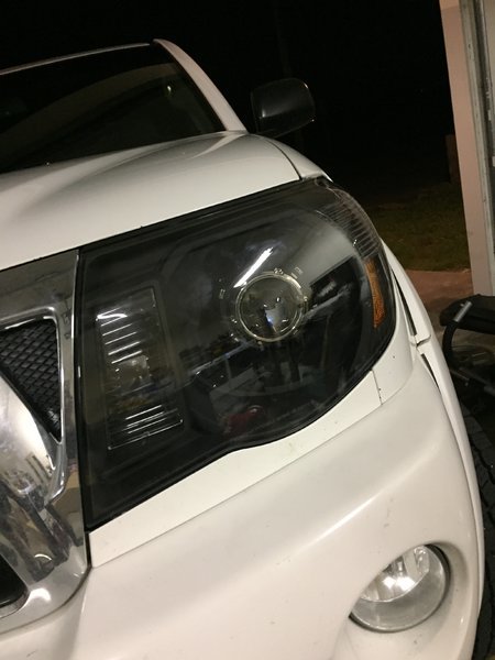

    Installed my Spec D Black Projector Headlights, I like the look except I thought there was led halo around the projectors and I asked an employee at car.id before I ordered and he said yes then when I turned them on nothing. I wanted them to send me led bulbs but they would only give me $25 gift card so going to look for some led lights today to give it a more mean look! Also need to align them some more

    Does the halo light light up at all? I've never seen a picture of the halo light on

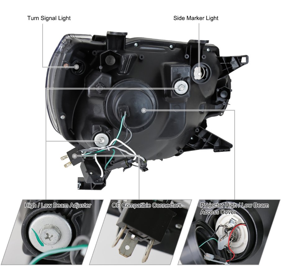

    Curious how the projector is mounted in there. Would love to go the lazy route for my next retrofit and buy these to take apart and put a better quality projector in there. And how good the outer lens is. Would hate for then to haze or yellow in just a year. I've had good luck out of my depo lights so far.

    This is just a guess based off seeing other Spec-D lights taken apart. The front shroud around the headlight bucket is usually separate from the bowl. My guess is that a MH1 HID projector or a D2S would be able to be bolted in pretty easily as well. Not sure how they have the projector mounted, but its either shaft mounted or bolted in. Either way it would be easy to install a real projector.

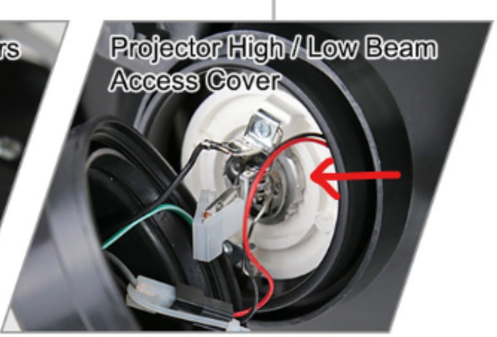

    I went on their site and noticed the projector appears to be a shaft mounted projector. So that is at least compatible with other shaft mounted projectors easily. I cannot confirm that the surround is separate from the bowl, but I would assume (99% confident) it is separate form the bowl as adjusting the headlight would only move the bowl and not all of the internals. This would be the same for the black and chrome "retrofit style" headlight housings. Hope this helps.
