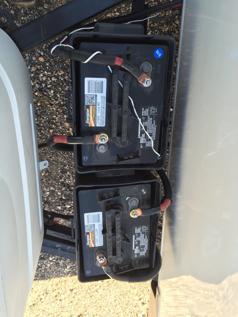

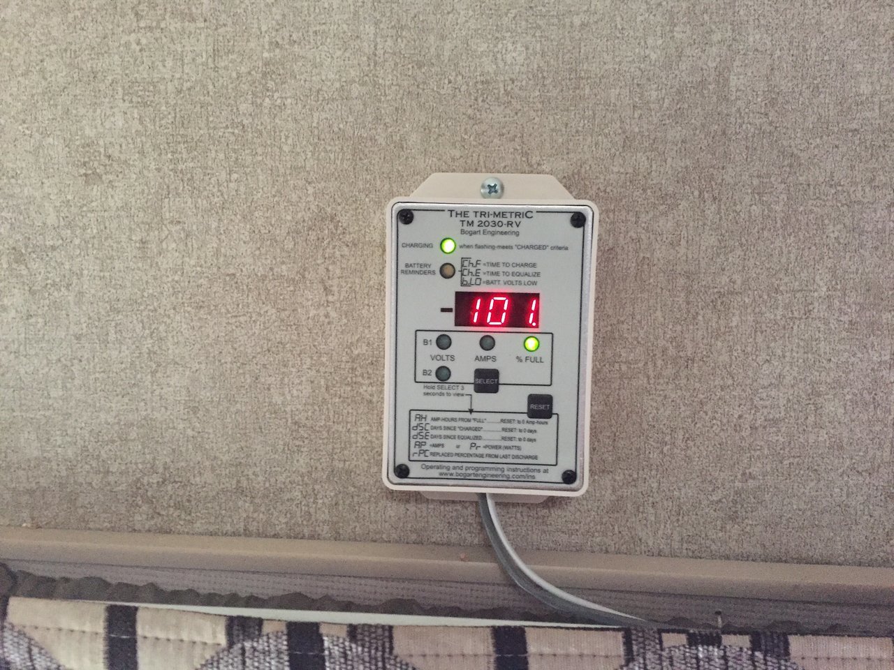

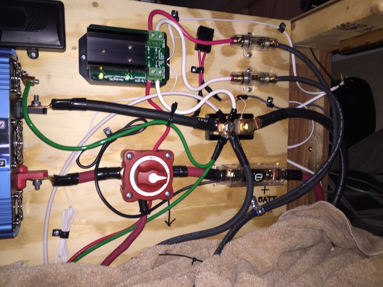

    Here’s a battery system example, my off grid camper rig. No generator needed. You could make a simpler version but you’d need to put a battery box and some contoller gear, fuse, etc in the back of your truck. Would be a fun project!!!9B4C4E04-FC35-49FB-A5CD-E54BA6DAABC6.jpg F5F252CE-FD1A-4E38-8C0C-CDBDB78BBAE1.jpg 032693DF-764E-4945-BBFB-7AA252D94769.jpg ECC203A9-1FC7-4B50-BC08-87F09B746619.jpg

    https://www.tacomaworld.com/threads/off-grid-engineering-dual-battery-system-q-a.468553/
    Above is a thread on dual car batteries. I think I cut/pasted it right. I don’t know the ins/outs of the forum very well yet. Might be worth looking into but I’m not sure how many amps you can fit in under the hood. If it worked, You’d need to hook an inverter up right to the car batteries, and make sure you used thick cable to avoid voltage drop.

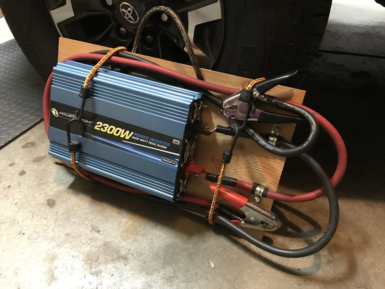

    0B320BB7-3512-48A0-B9D1-730376918A0E.jpg Here’s a portable inverter I rigged up onto a piece of plywood with a rope handle. Rigged up soldered connectors with 00 welding cable. Just one example.Just need the amps to run it!:benchpress:
