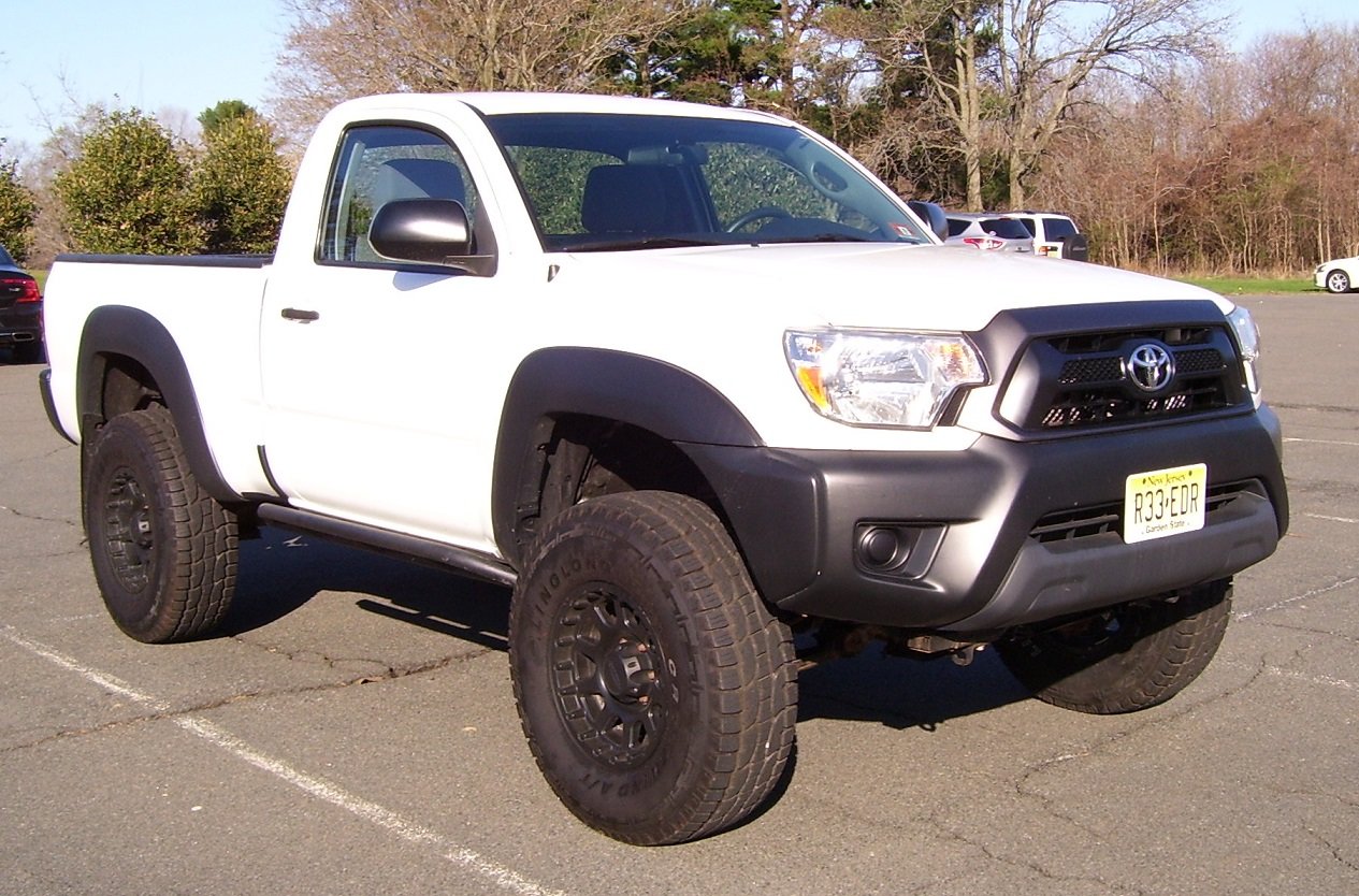

    If you're planning on running 285/75/16 tires you would want the wheels to be around 16x8 with 0 offset (4.5" backspacing). Remove the mud flaps, trim the flares, beat in the pinch weld, run some SPC UCA's at position D or E to push the tire forward and then you might still need to do the cmc. No guarantees since every truck is different (and tires all measure out differently between brands) but that might be a good starting point. I'm not sure if 2.5" of lift will be enough or if you will need 3", but when my truck had that combination (3" lift but no cmc) I had no rubbing with daily driving. I never got it offroad with that combo so I can't verify no rub with it stuffed. I'm running 305/65/17 now and I get a little rub on the cmc at full lock but that's wider tires/rims with different offset.
    Here's the truck with the 285/75/16 with 16x8 0 offset wheels, 3" lift.
