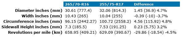

    The ScanGauge does allow the user to add or subtract an "adjustment" (a percentage) to compensate the results it displays. You would have to know how much the speedometer is off, then input that into the SC as a percent change number.
    For instance, going from a 31" diameter tire to a 32" is about a 5% change (in revolutions/mile).
    from the online tire size calculator
    I used this example because it is what was true for my situation. In my case, what was interesting is that after going to 32"s, the Garmin GPS showed my speedo was reading exactly what the GPS said for speed. :eek: What this indicates is that the speedo was under reporting from the factory with the stock wheel/tire combo.
    I have since read that stock speedometers are allowed to be under by up to 5% but not over.
