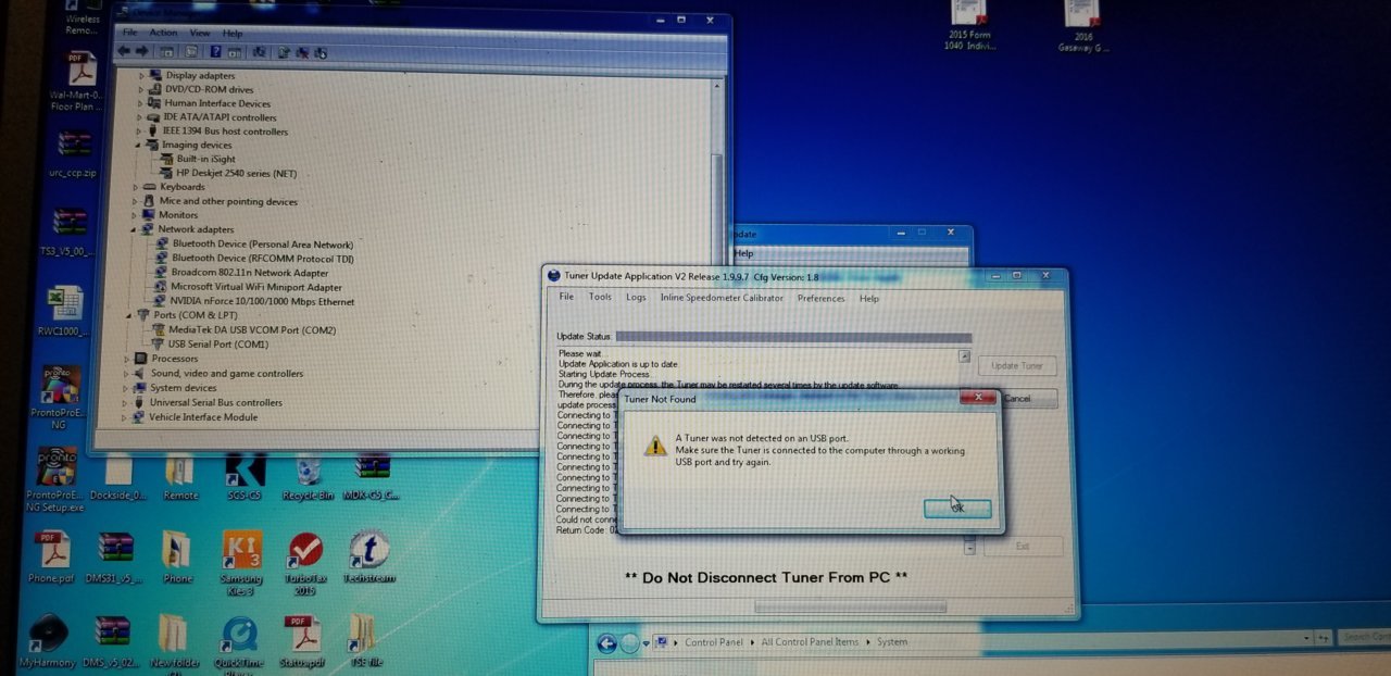

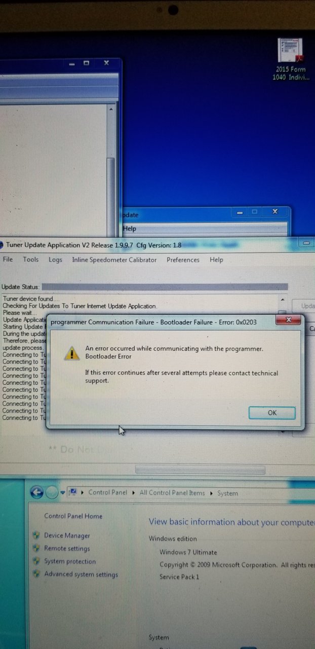

    I'm trying to program getting this error::

    Also what is the default gear ratio for a 17 TRD offroad 6 speed manual. And do I put the size tires in inches or the size 285/70 17

    leave the gear setting alone, do NOT change anything.
    for tire size you will get a more accurate reading if you put in the actual tire size of stock and the new ones.

    I'm putting in 4.88 gears. I don't have to tell it that? And do I put in the tires in inches or the whole tire size?

    Leave the gear setting alone, doesn’t matter if you are switching..
    Use inches for better results. Look up the factory tire size and whatever your new size is.
