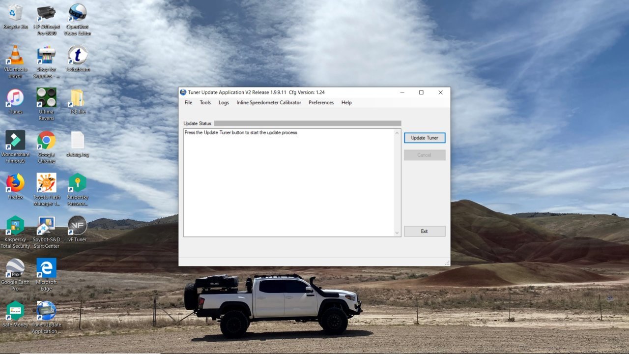

    For what it’s worth I just installed this on my 16’. When I was programming the module I noticed that 2019 - 2020 are listed in the software. I bet they will have an option soon.

    As far as i know it's the same one as the hyper tech just different sticker on the box. It is programmed on the computer speedo.jpg
