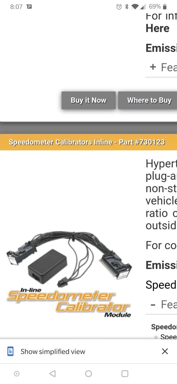

    I apologize in advance if this has already been answered, but now that these work with 19 and 20, what's the difference between the RC speedo calibration device and the hypertech that's damn near double the price?

    That's what I though but they are visually very different based off the pictures online and the prices are drastically different.

    Hypertech on top and RC on bottom. The hypertech is $229 on their website.
