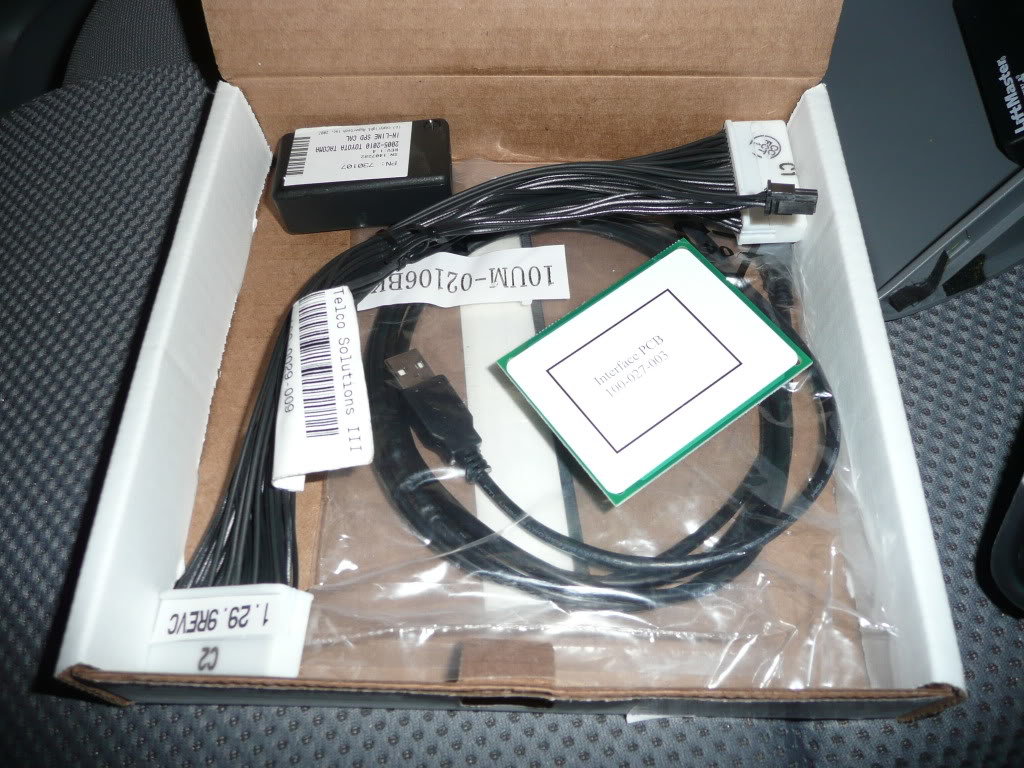

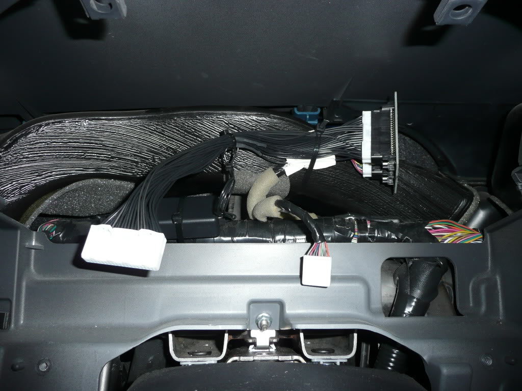

    I have been running one for about five years. Hadn't thought to leave the cable attached for easy access in the future...Might have to plug it in next time I have the dash apart. Here is a pic of how mine is installed. I think it was worth the money!
