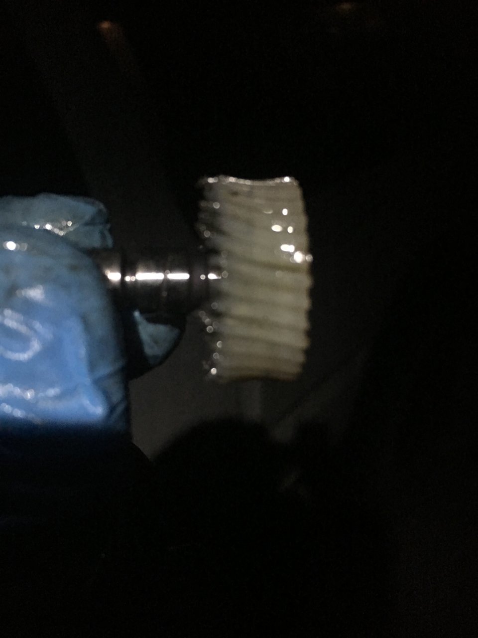

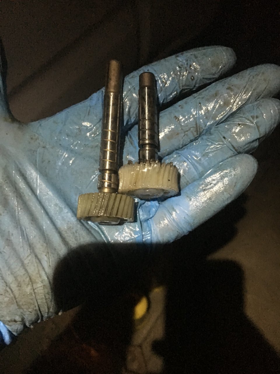

    Well, this is what I get for being distracted when doing car work. Forgot to compare parts. The new gear was significantly shorter than the old gear. And then, on top of that, it puts it in the wrong location so the drivetrain destroyed the speedo gear. Going to have to find one the correct length! At least it wasn't the cable...
    Also, so the one that's in there is 30T, and I'm right about 10% off. Would 33T be correct or should I go with 32T? I figure with 33, it starts decreasing the amount of correction per additional tooth each tooth size you go up since it's adding a shrinking ratio to the diameter of the gear.
