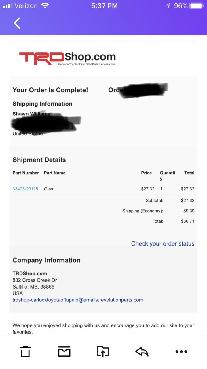

    Where'd you get your gear? Mine was the wrong part. The shaft was too short!I'm thinking that instead of just topping off my gear oil I'll just change it since I'll have had to crack it three times lol

    A74F17F4-1DE4-49F4-A062-861BAD1624F7.jpgTrdshop.com also shows the part number for the 33T gear. I ordered this a couple weeks ago. It was back ordered for 2 weeks. Got it today.
    ZrowGz[QUOTED] likes this.
