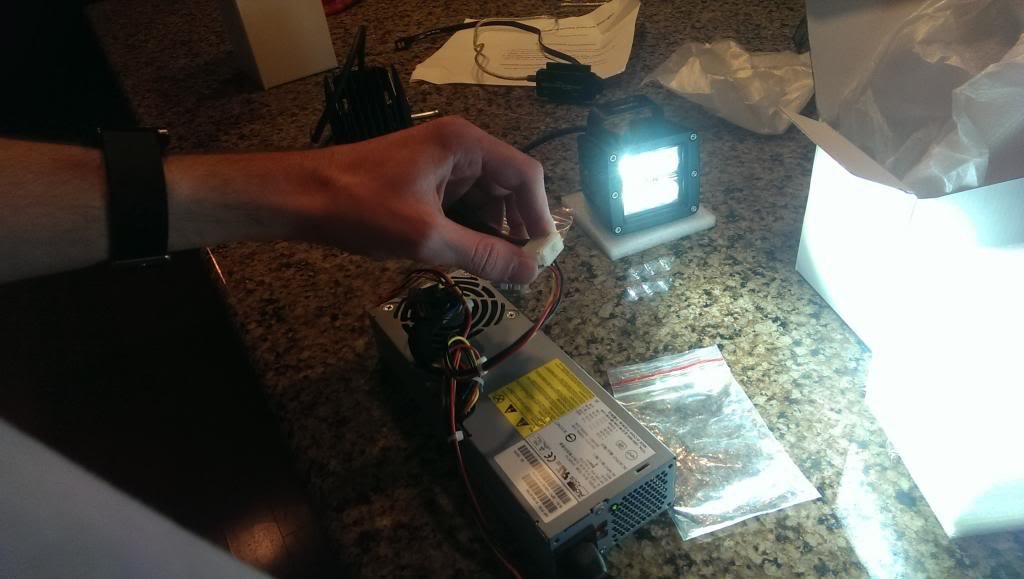

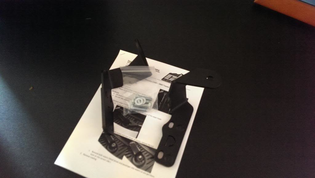

    Today, I got my Totron Cube lights and I just ordered a pair of CBI ditch light brackets. Friday I will probably install them, until then I leave you all with a picture of the light running off of a computer power supply.

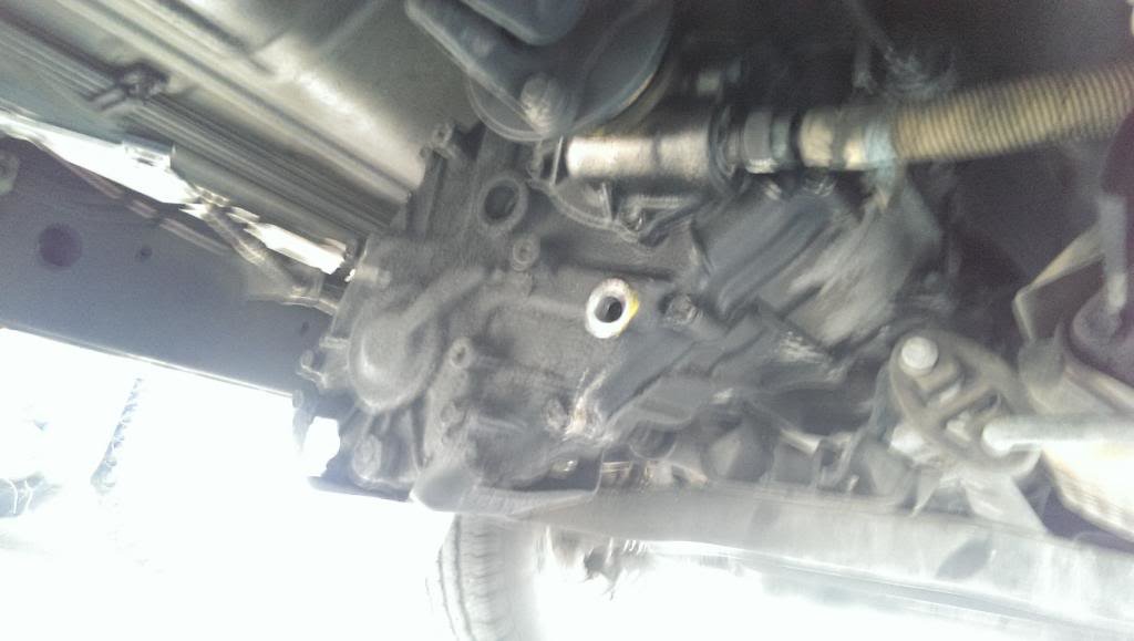

    I guess I'm just in the mood to post things (probably because I actually needed to do something). When I went out into my dorm's parking lot to install my Ultraguage I let the vehicle idle while I adjusted its settings and got it all adjusted/mounted. After I had finished my install I did a quick walk around of my truck and saw a large wet spot underneath. The wet spot was nothing more than a normal sweaty muffler from cold weather, however it prompted me to look under the truck and find a more serious problem. As I was doing a cursory check on the under-body I spotted a clean spot on my transfer case. This clean spot had threads and a sealing compound on it, that's right, my fill plug had fallen out somewhere. I promptly freaked out and decided to trip over to the Toyota dealer to get a new plug and crush washer, that all went well and I headed to a local auto shop to have them flush the T-Case and put new oil in. Someone came out a bit later and told me the plug would not stay in as the hole was too stripped.
    Immediately I knew what had happened, the idiots at Oil Can Henry's had stripped (probably over torqued) it the last time I went in for an oil change (because they check every freakin' fluid for no reason). Anyway, I ended up telling them to tap the hole over to the next size they had available and they ended up threading an SAE size into it.
    My Baby on the Lift:
    All Fixed:
    Overall it ended up being fixed for $65 bucks, but it still sucked that I had to do it. I got lucky because the auto tech said that the T-Case oil he drained was free of water and not very dirty. Here is the picture of it after being fixed.
    Picture of UG as well,

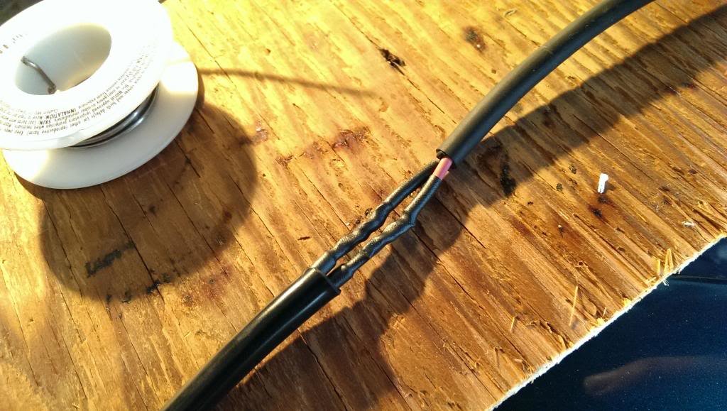

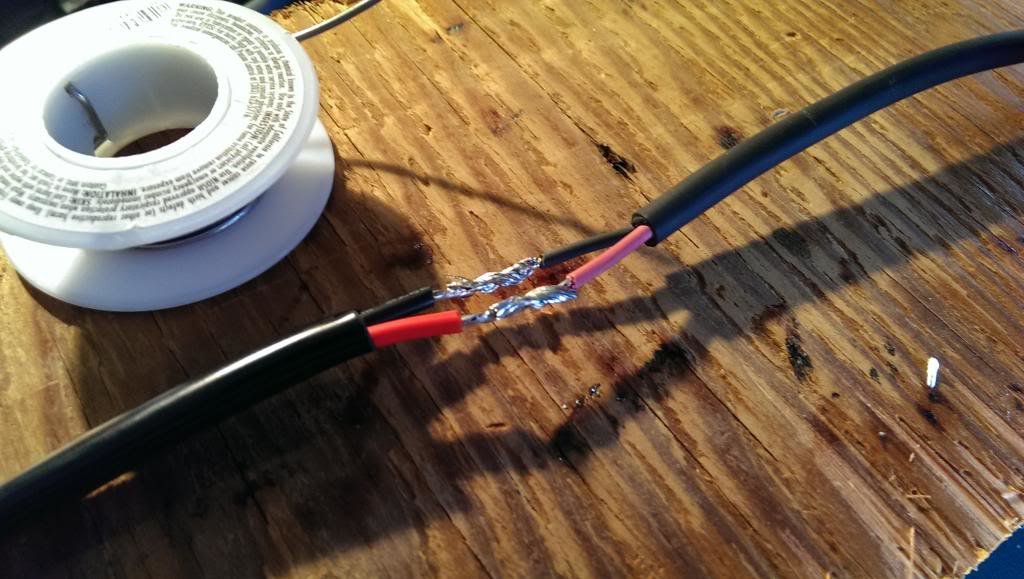

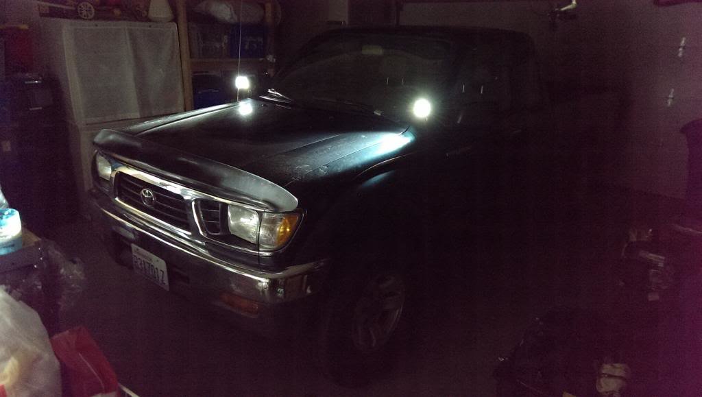

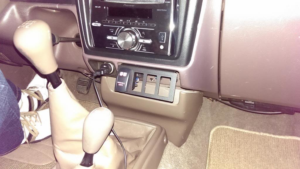

    I got the CBI ditch light brackets all installed with the help of my dad, also wired it all up and installed my first OTRATTW switch. Don't tell anyone, but I think my hood lines are a bit off. :gossip:
    Getting the first bracket all mounted up...
    Little bit of solder...
    And some shrink-tube to cap it off...
    A quick test...
    Final alignment...
    And a switch to finish it off...

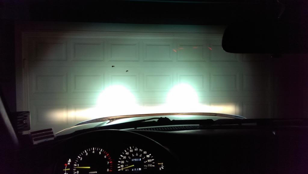

    Got some fun stuff coming up in the next couple of weeks. I ordered a flashlight, quick fist, and charger. Plus, I have a fire extinguisher and some lighting waiting to be installed. On top of that I am going to make a satoshi grille. Lots of fun in the near future.

    Oil Can Henry's screwed up my fill hole, Cheney Auto Care was kind enough to tap the hole for a measly $10 and the rest was spent flushing the TC incase anything had gotten in there while the plug was missing. But yeah the OCH tech prolly did strip it knowingly.

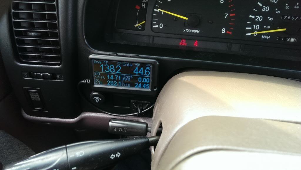

    You'll definitely enjoy having an UltraGauge. Funny story, it sorta saved my bacon once. I was headed up a massively steep hill that was just off an off ramp. The truck was driving fine, but had a bit of a vibration at the bottom of the hill. I had a bed literally full of moist soil and as I'm going up the hill I lose all power and the truck starts flashing the check engine light (when it flashes it means the engine is running so poorly it is doing catalytic converter damage). The Ultragauge beeped at me and gave me the Cyl 2 misfire code. Looked under the hood and my spark plug had backed out of the hole (couldn't visually see it but I knew where to look and that was very helpful) I used the plug wire to loosely screw it back in and drove home.
    Turns out I had been down on power for quite a while as the spark plug had been loose for a long time. It was great because when I changed all of my plugs and wires it drove like a new truck.

    I can't wait to get one, I am looking at all of the features that this scan tool offers and it sounds like it will be a very useful tool to have! Not just for my truck, but for any vehicle OBDII. I've been fighting a P0420 code lately and I want to get to the root cause of the problem, like tracking Stoichiometric AFR to see if I need a new cat or to determine whether or not the O2 sensors are functioning properly.

    I'm pretty sure that's your upstream o2 sensor. The one before your cat
