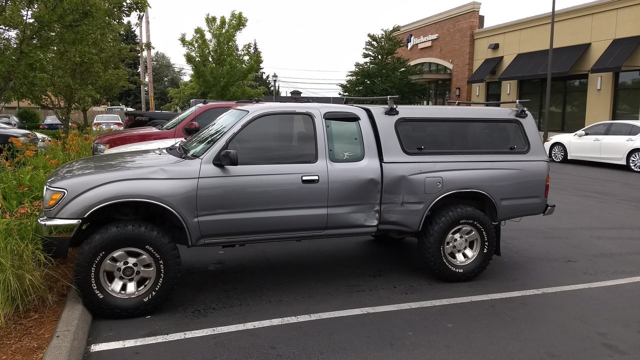

    Aw man do I have to make a new page, it's basically the same truck haha

    same color and everything lol?
  19. Jul 1, 2017 at 8:40 PM
    #99
    Speedytech7
    Feb 20, 2014
    #123587
    57,991
    FCQM+VG Cheney, Washington
    It's less Tacoma and more mod
