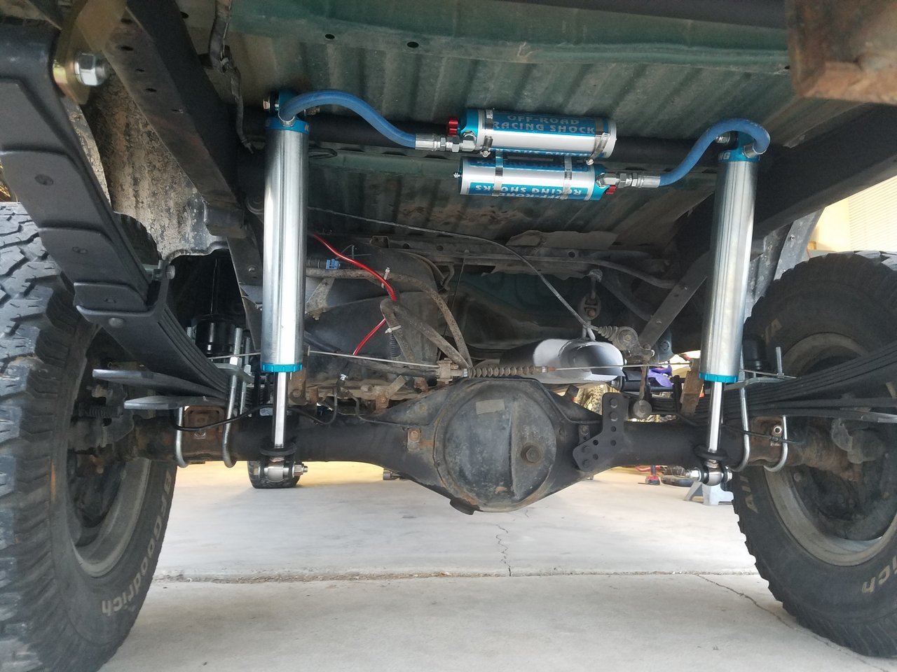

    Intervention! Yeah that's probably a good idea. I don't typically post anything in here cause no one reads it as evidence by only six pages in 5 years haha. I'll hopefully have something to add to it soon, coilovers get back from SDHQ on Thursday and so do my FOAs (which need to make it for one more trip). Rear Kings will be here at the end of March so I can feel what a real tuned shock is like. Then we'll see how long it is before I go front Kings to match or ADS with the long travel... Right now my wallet is tapped out between shock rebuilds, new shock mount fab, new welder, new rear shocks, and gassing up the cruiser while it gets 10-11MPG haha

    Oh yeah and I forgot all the rear end stuff too, ubolt flip, and new leafs and shackles. I got the Superbumps today, excited to make some mounts for those this weekend so I don't bottom out on the shocks. Funny thing though, apparently bottoming and topping out on the shocks isn't as bad for them as we all think it is, Ben from Filthy Motorsports was telling me it is more likely that bottoming on my shocks would cause me to rip a shock mount off rather than hurt the shock itself. Just thought that was funny and it is nice to know the accidental bottom out isn't much to worry about but like all things that involve high force it isn't a good idea to make a habit out of it.

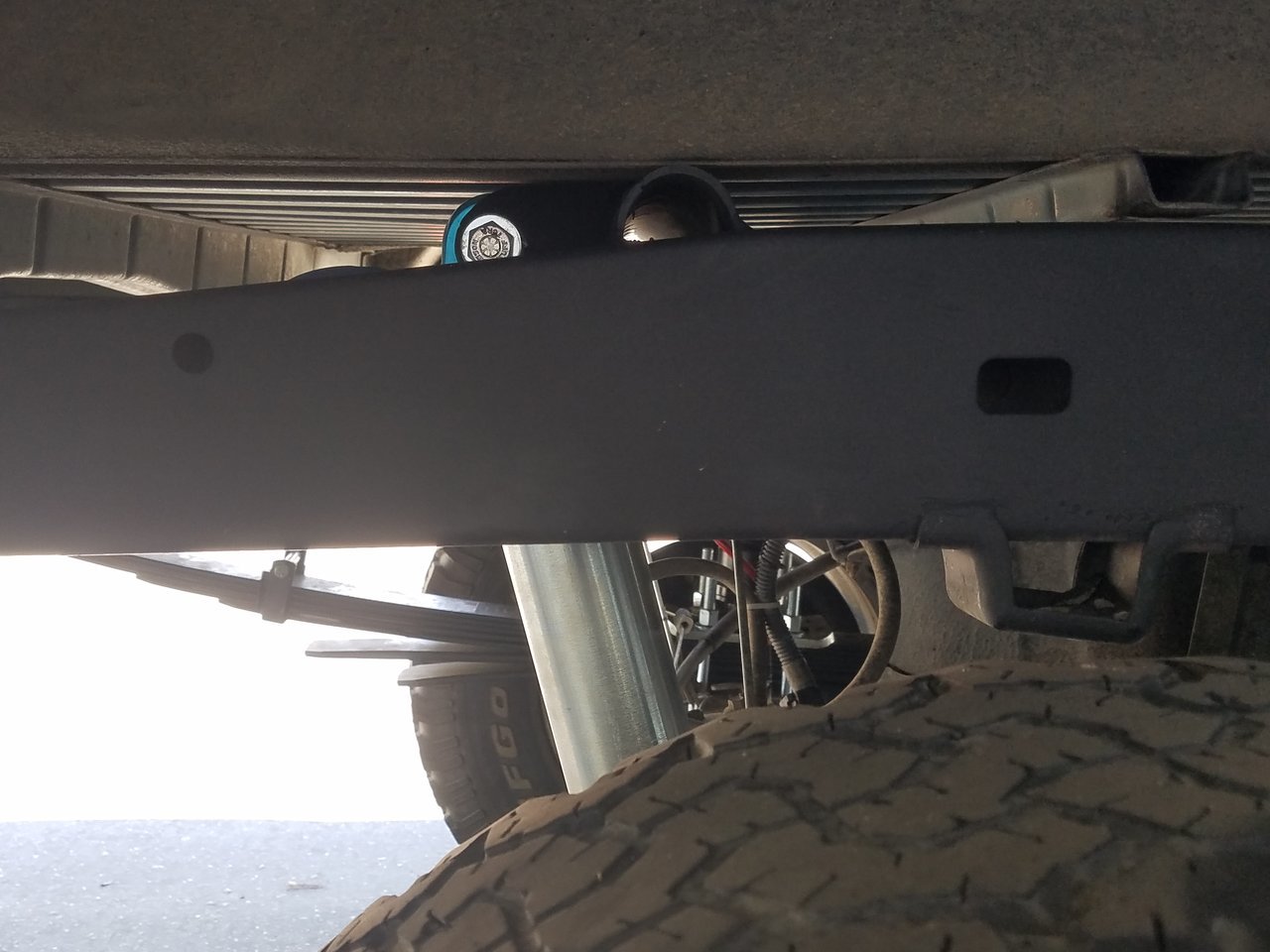

    Just finished mine today thanks to a buddy. Good luck on yours man. Your photos helped us a bit
  15. Mar 11, 2018 at 10:43 PM
    #115
    Speedytech7
    Feb 20, 2014
    #123587
    58,548
    FCQM+VG Cheney, Washington
    It's less Tacoma and more mod

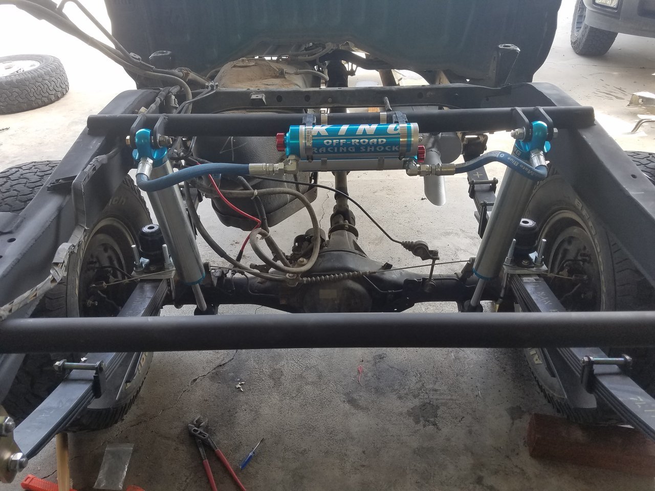

    That's awesome man! What kings are those and who set them up? I ordered 10" 2.5dia smoothies with resis and welded ends like those but they haven't arrived yet. How does it all ride and how far angled back are your shocks?
  16. Mar 12, 2018 at 7:42 AM
    #116
    waldeeeeen
    waldeeeeen Well-Known Member
    Sep 10, 2014
    #138016
    427
    Walden
    Mosquito CA
    01 Tacoma 4x4 SR5 TRD 5sp

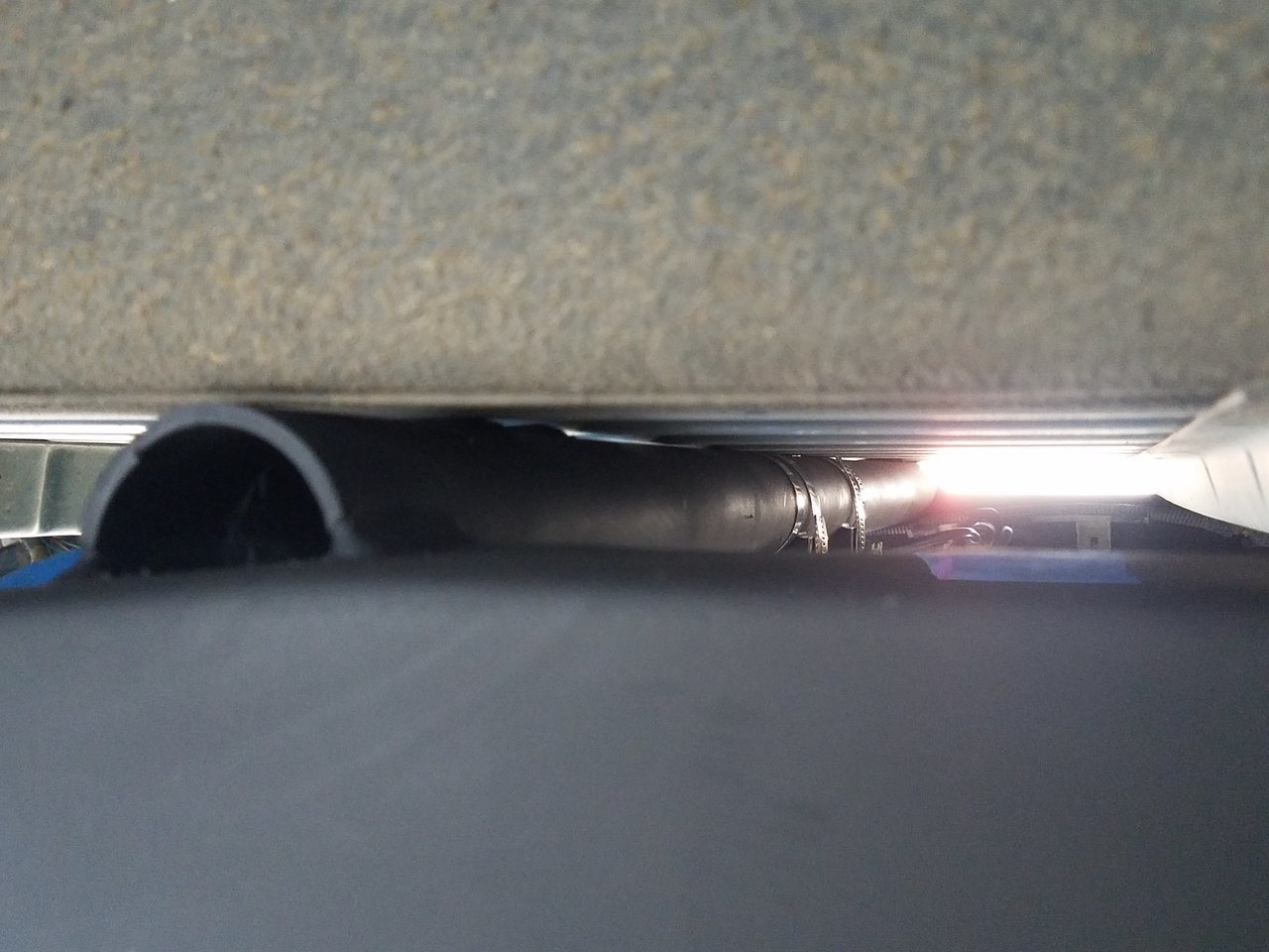

    Got them from filthy motorsports and they set em up 10/12 (2.5 smooth remote resi and adj). We didn't really have a science to it, just measured how much space under the bed for the dom, we wanted 4 up travel 6 down or 5 and 5, and I haven't even driven around. Just got the front bumped up so it's almost level. I'll try and add more photos later but the dom cross member was 1" and at most with the tab 1.25 and it barelyyyyyy clears like buh barely lol but the angles are good bottom tabs don't hang too low. Seems like it'll work
    Speedytech7[OP] and jubei like this.

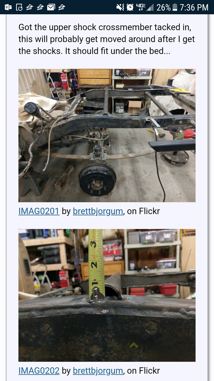

    We tried to use squeekypenguin's photos too as guide. Mine ended perfectly under the bed like less than a mm

    Update, I did the toytec ubolt flip, Dakar leaf, and trail gear axle relocation. If you do this you have to drill a hole in the ubolt plate to mate the relocation.
