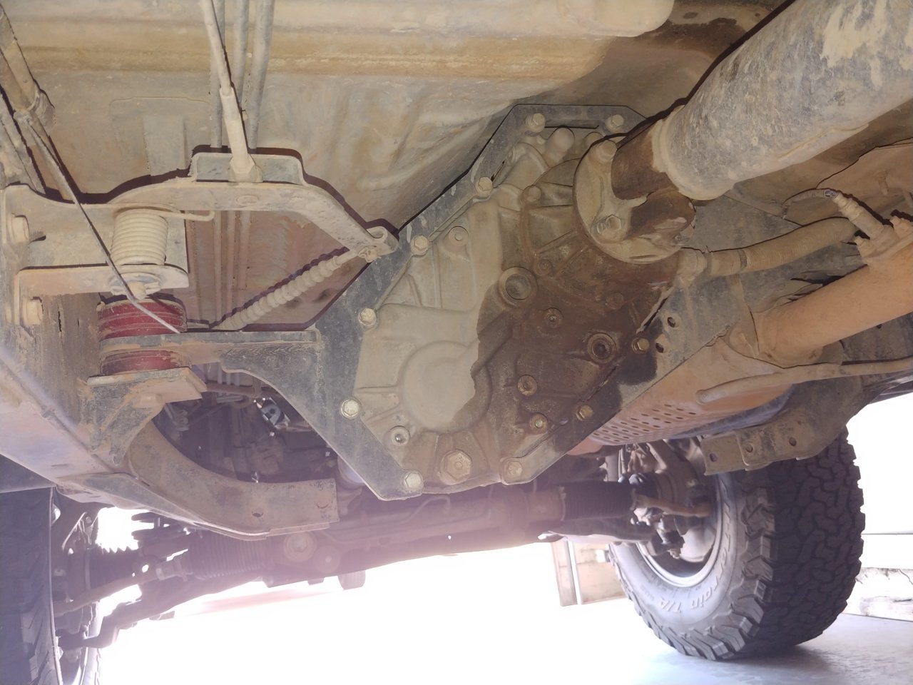

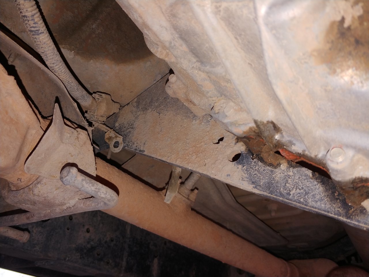

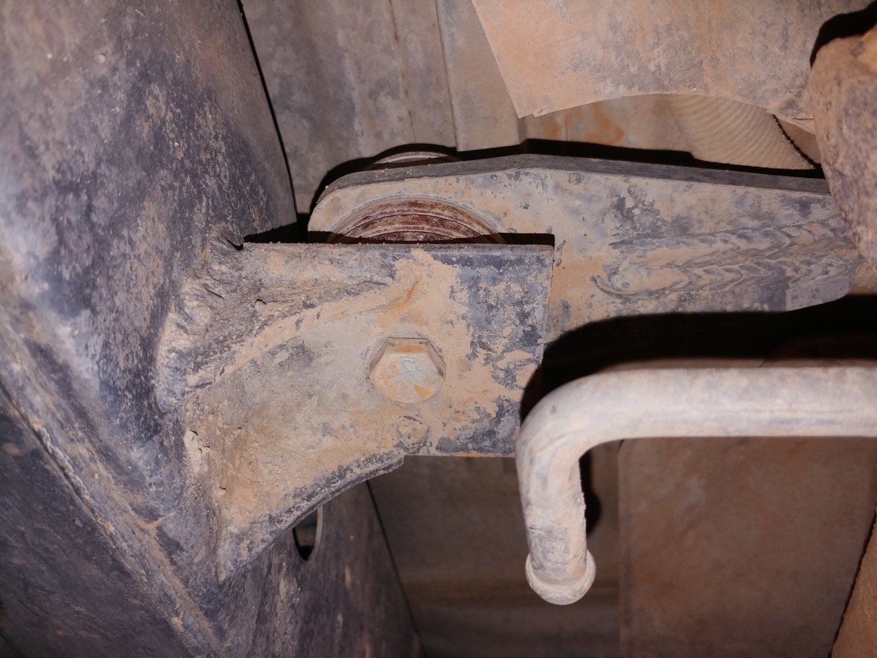

    Hey Zane, am I imagining this, or are you running the FROR t-case crossmember?
  7. Apr 29, 2018 at 1:32 PM
    #127
    Speedytech7
    Feb 20, 2014
    #123587
    58,548
    FCQM+VG Cheney, Washington
    It's less Tacoma and more mod
    Yup I'm running one, why?
  8. Apr 29, 2018 at 1:36 PM
    #128
    jubei
    jubei would rather be doing something else
    Mar 17, 2016
    #181549
    6,066
    Jason
    NoCo
    White 2002 XC TRD and Yellow 1971 JEEP CJ5
    Stuff. Also things.
    Just in the stock position, right? No dual cases?
    How are the vibes? Did you eliminate the bottom mount altogether?
    Thanks!
    ETA: I’m hoping to install my crawl box sometime this year, and it seems like a really good way to get a new mount in and support both cases. The other option is a new crossmember and bottom mount for the crawl box and let the j-shift hang out cantilevered like it does in stock form.
  9. Apr 29, 2018 at 1:44 PM
    #129
    Speedytech7
    Feb 20, 2014
    #123587
    58,548
    Yeah I'm running with one case and I eliminated the stock crossmember. But I wouldn't say stock position, I pushed the case up until it was 3/8" from touching the body. That's kind of the cool part of the design is you can move the mount how you see fit. It comes with two stiff but not unyielding poly bushings that hold the weights of the case, trans, and engine well. But I would recommend that you have poly engine mounts as well so it only has to hold the weight vertically and not the torsion from acceleration and deceleration. I have some minor vibes from the mounts being more firm but idle is smoother than ever and cruising under 3500 is plenty smooth too. Above 3500 it is small vibes not driveline just engine.
    Wulf and jubei[QUOTED] like this.

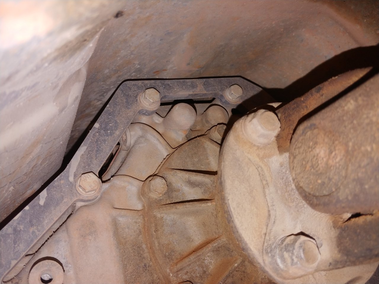

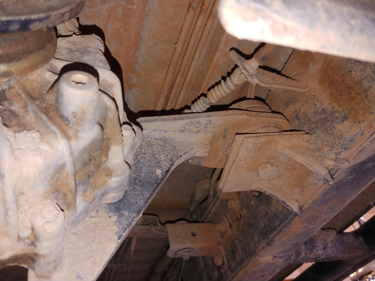

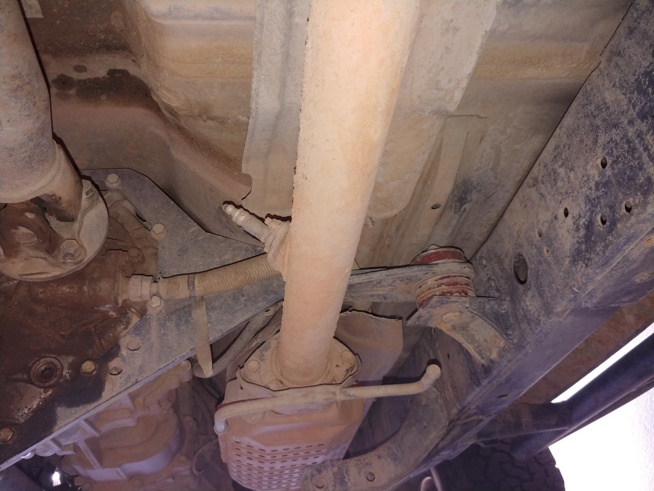

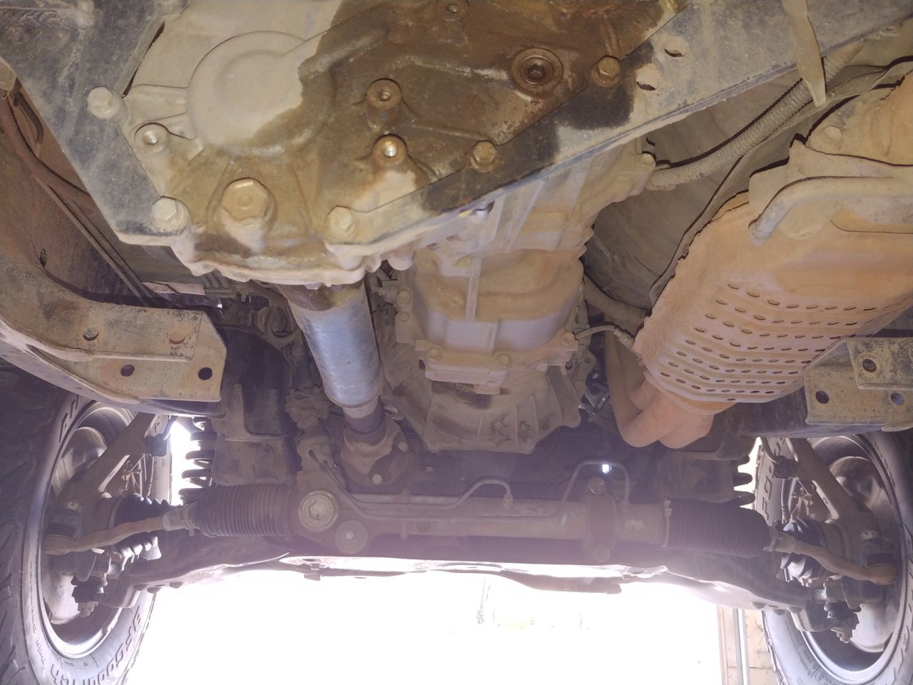

  13. Apr 29, 2018 at 3:15 PM
    #133
    Speedytech7
    Feb 20, 2014
    #123587
    58,548
    Sorry it is so dirty, the mount is pretty easy to line up, you just jack it up and weld in the mounts where you like it. It is self centering. The engine mounts were much harder to install.
