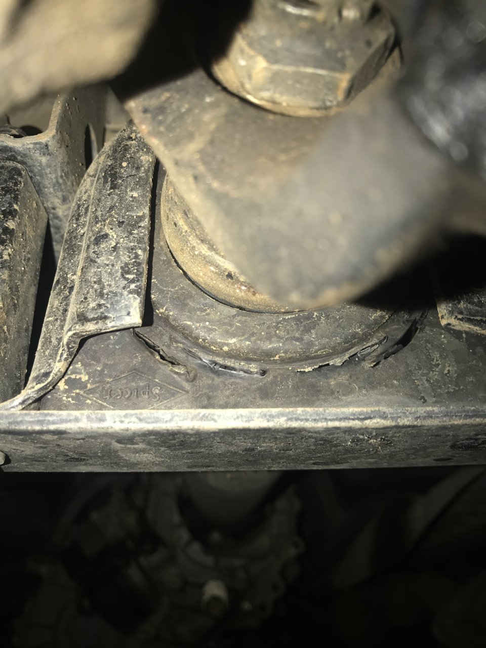

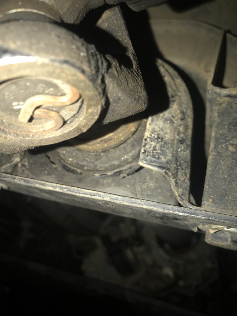

    Well looks like mine is rapidly failing....

    I’m not too sure what I’m gonna do about this. I seriously dread doing it all over again

    Any idea why this has failed so soon? Was there some unusual stress on the rubber? I have one here and it looks like a pretty robust part. When you pull it out, some pics of the failure would be nice.

    No idea it does seem very unusual. Could just be a fluke. I might just keep s close eye on it and leave it. I just don’t have the time to re so all that work.

    I’m starting to think that the ripped marks that I’m seeing in the rubber is actually relief marks that it came with?
    Anyone have pictures of this side of the XC carrier bearing to confirm?

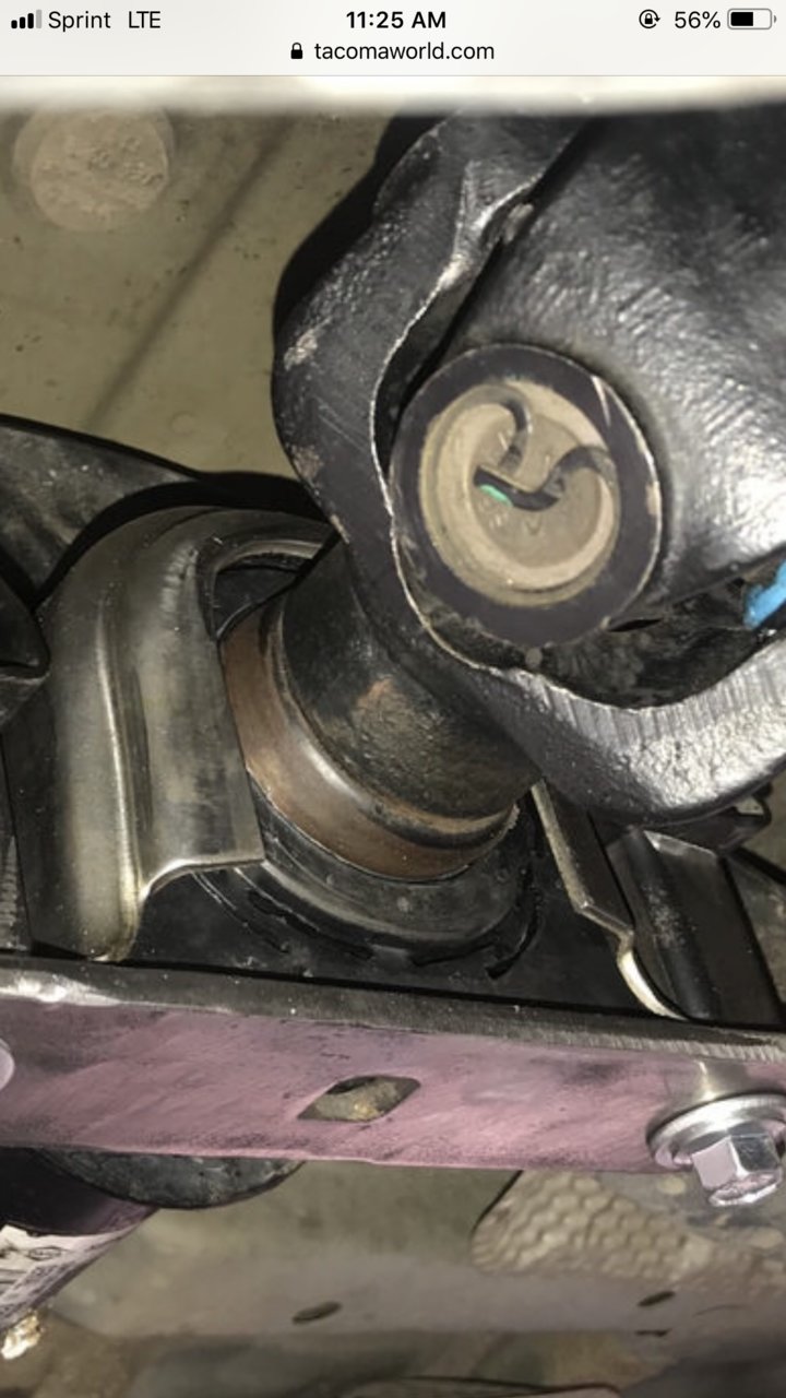

    Looks like the rubber may not actually be torn. Another member posted this photo and it looks like their is relief cut in the rubber the same area mine looks “torn”

    If you are talking about the slots in the rubber, yes those are molded in.

    So maybe mine isn’t torn then. It looks like those are exactly where the slots are that come molded into the rubber

    Yea, I have a new one here on my desk to look at. Unless you are seeing something I can't, I think you are fine.

    Awesome. From the pic I posted it looked torn, forgot there was factory molded reliefs in the rubber on this side. I know the back side has more relief cuts.
