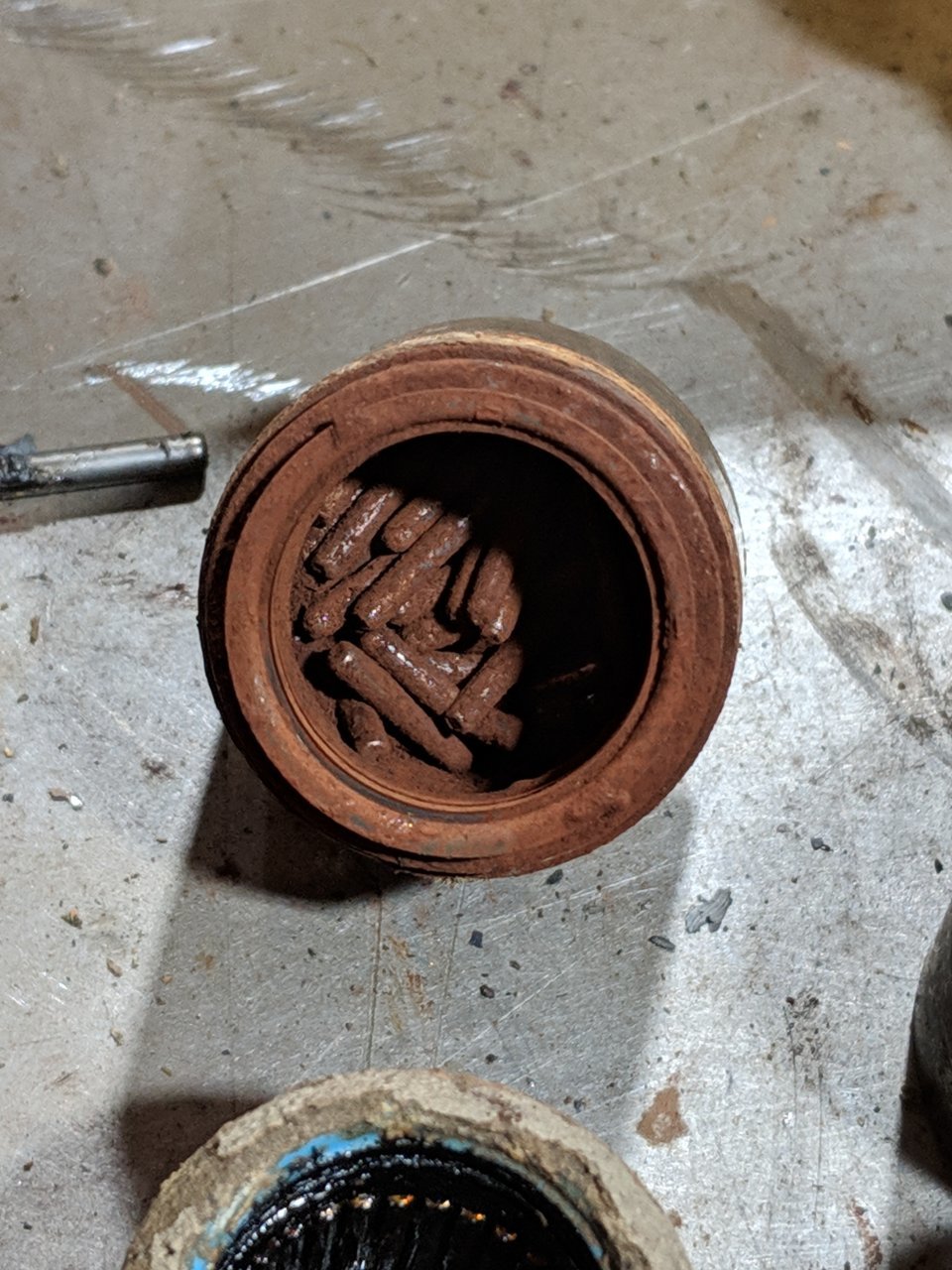

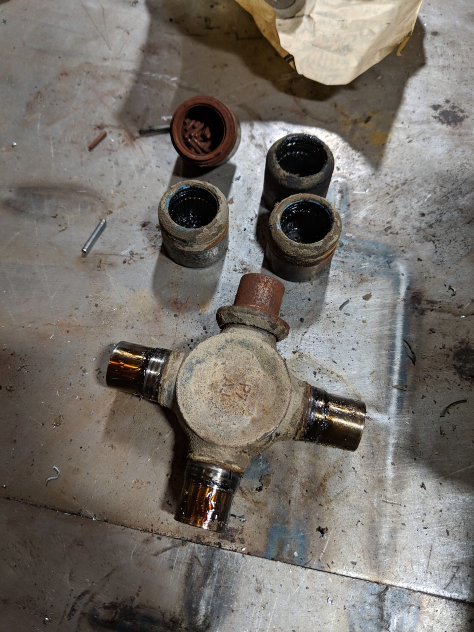

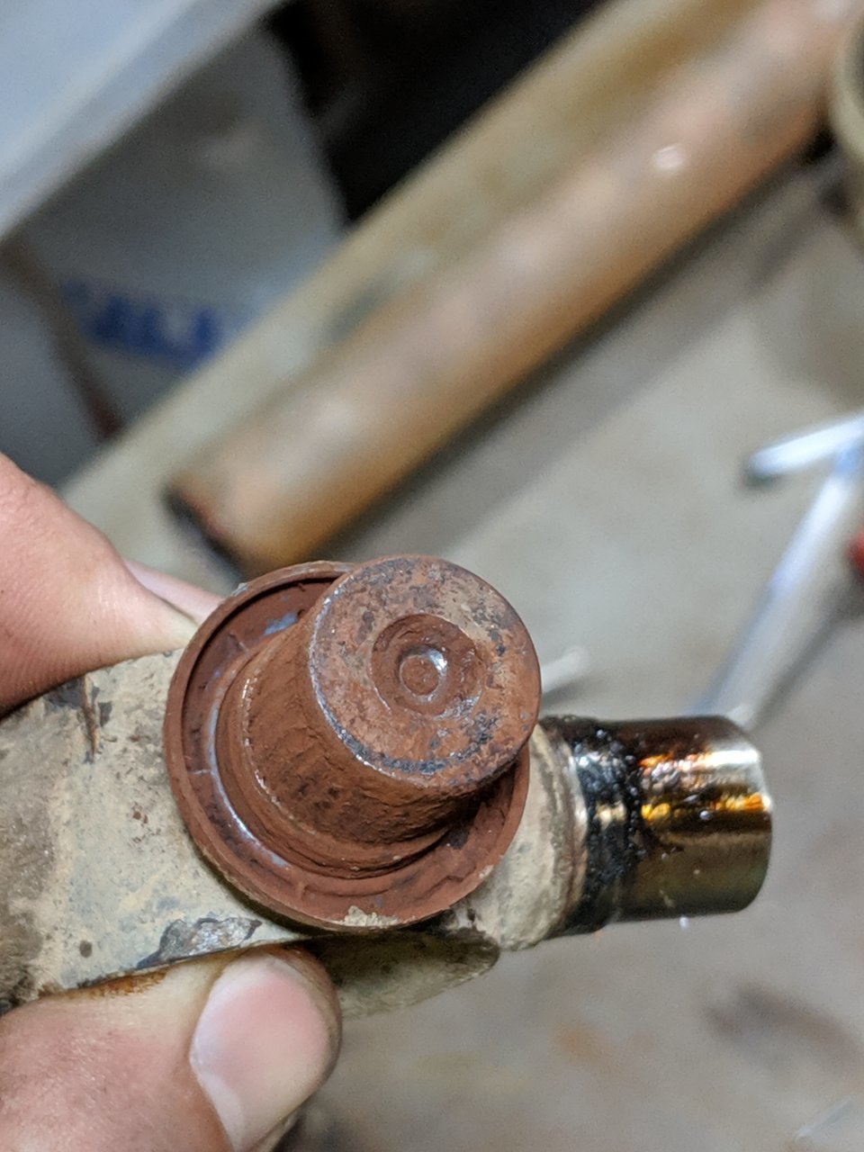

    Just installed this one after my last purchase went to crap in a matter of weeks. Found a slightly messed up center joint and a roasted and seized rear joint, on the grease zerk cap no less.... Still have vibes on takeoff with 2.25" so I may try a little more spacer...
