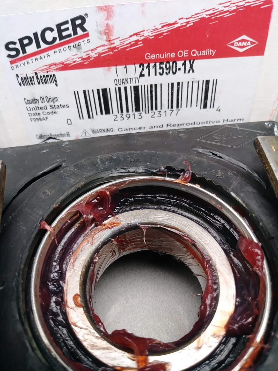

    What did the bearing cover look like? Shield or seal? I have one in the garage i can clean up and post some photos

    Looks just like the IEDLS one minus the yellow poly

    Sounds like it's a sealed bearing, weird that it has grease on it

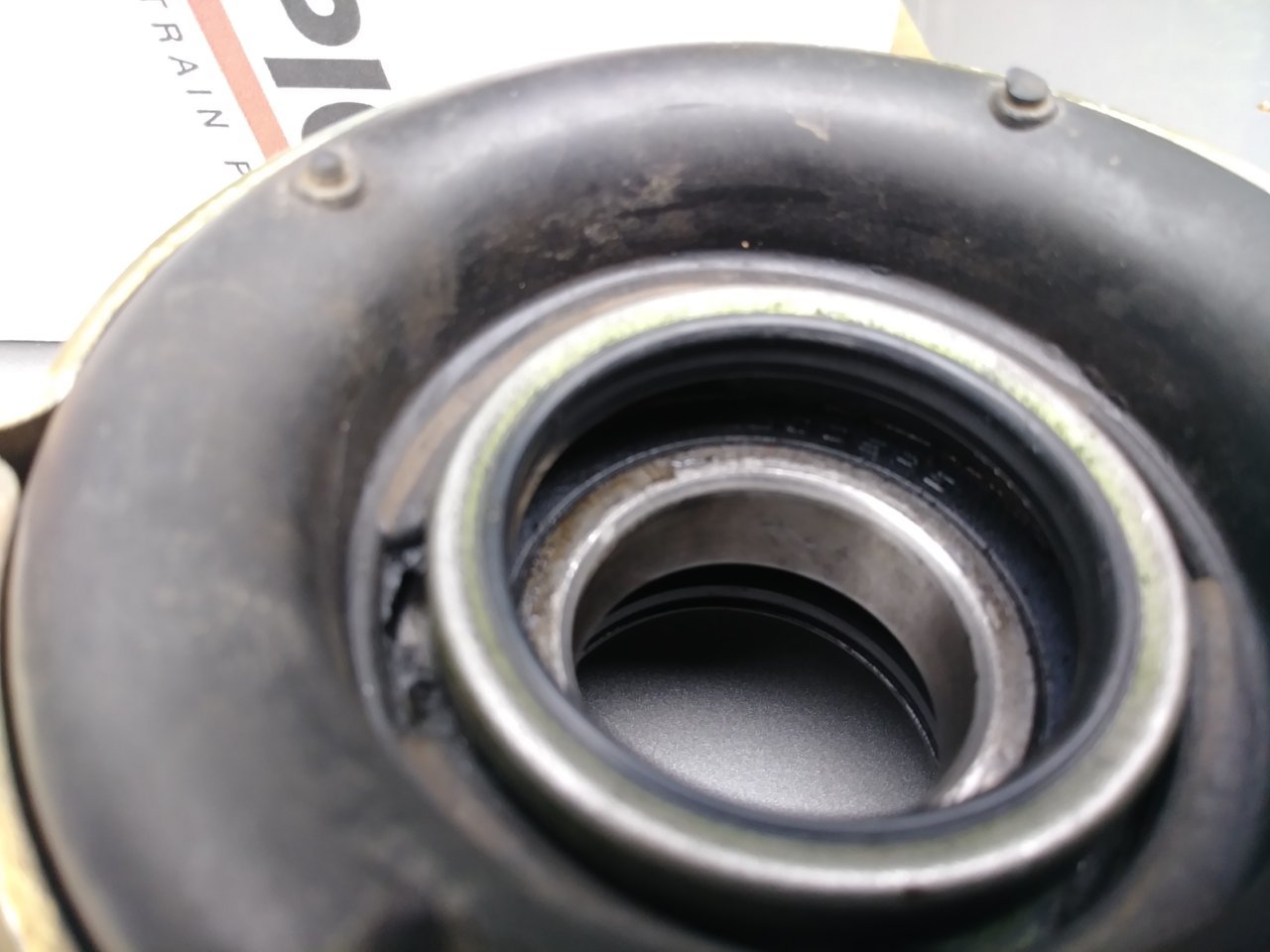

    DirtyBlueToy
    DirtyBlueToy New Member
    May 14, 2020
    #328045
    4
    2006 DC TRD Off Road 4wd
    Here's both the Spicer 211590-X bearing and the stock Spicer 5002007. Seem to have similar-type internal bearings.
    Seems as though they felt the need for a protective boot on the stock piece.
    Their new XC bearing literature (
    https://spicerparts.com/en-emear/pa...cial-off-highway/xc-center-bearing-assemblies
    ) brags that it's a sealed bearing which has no need for a dust cover...but according to Spicer the 211590-X is not an XC.
    Very confusing. Wish Spicer would be more helpful.

    What would answer this question 100% is if someone could remove the grease from their Spicer 211590 bearing and get the model of the bearing itself. We could then pull up the spec sheet and verify if it's actually sealed or just has a plastic/rubber shield which I've seen on some unsealed bearings.
    I can do this on mine but it might take a few days

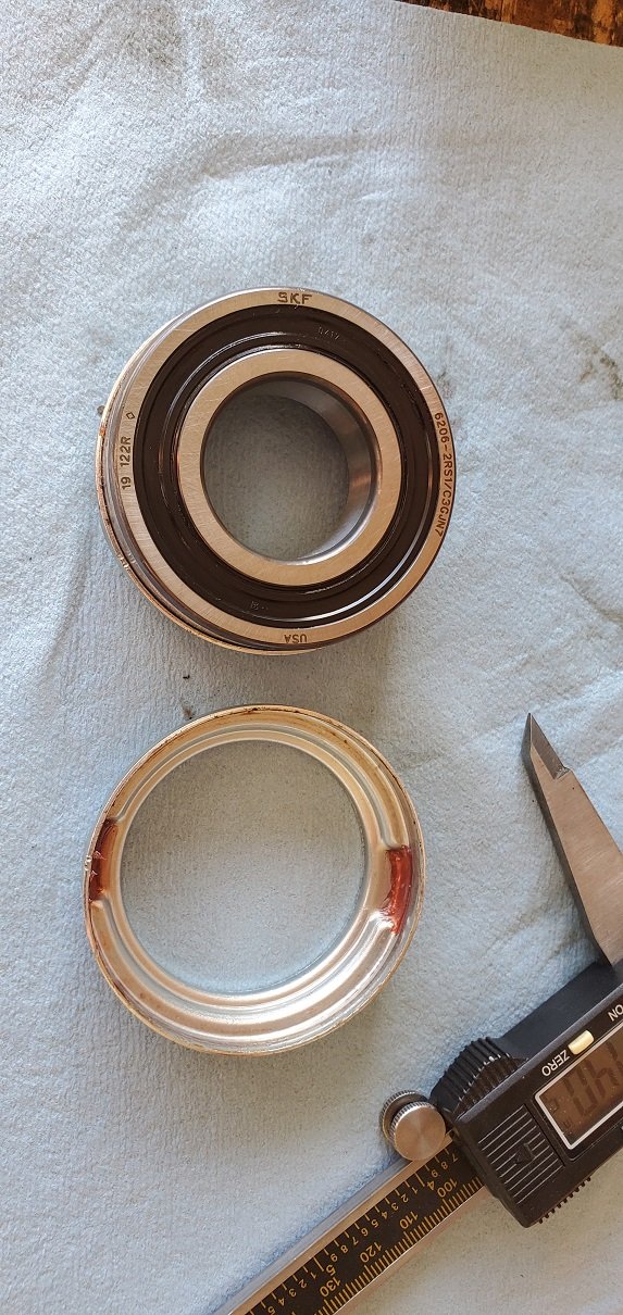

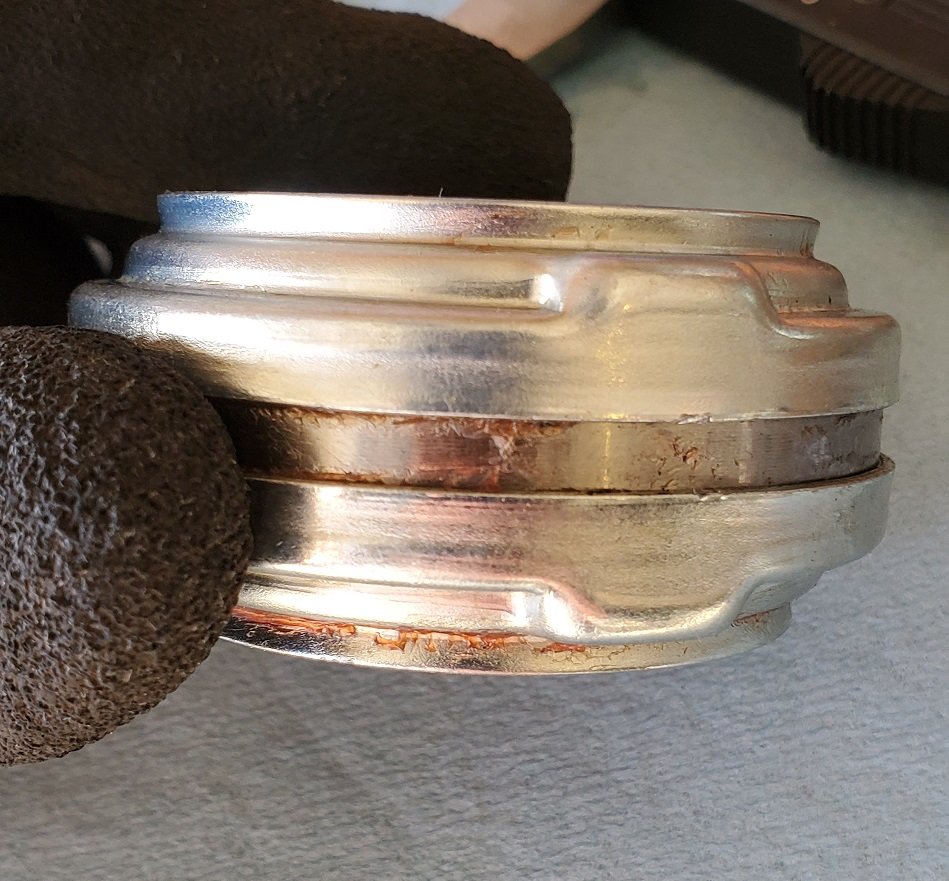

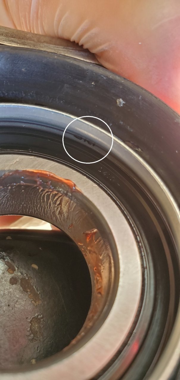

  9. May 27, 2020 at 6:41 PM
    #109
    mikalcarbine
    mikalcarbine Well-Known Member
    May 5, 2017
    #218236
    499
    Phoenix, AZ
    2015 AC TRD OR
    Got some good news, had some time today to clean up the grease. Unfortunately the seal didn't have any useful markings on it, just two numbers that brought nothing up online but I then noticed a stamp that looked like the bottom of "SKF"
    I decided to spray some silicon lube around the bearing and pry it out of the rubber, revealing a bearing inside two clamshells
    I tapped off the side with the SKF marking revealing the full model number
    According to the SKF bearing catalog, bearing 6206-2RS1/C3GJN7 is a two sided NBR (nitrile) sealed bearing with high temperature GJN grease. The catalog states "Bearings capped on both sides are lubricated for the life of the bearing and are virtually maintenance-free"
    Not sure why spicer would even bother putting grease around this but I had to quiet my brain before installing it.
