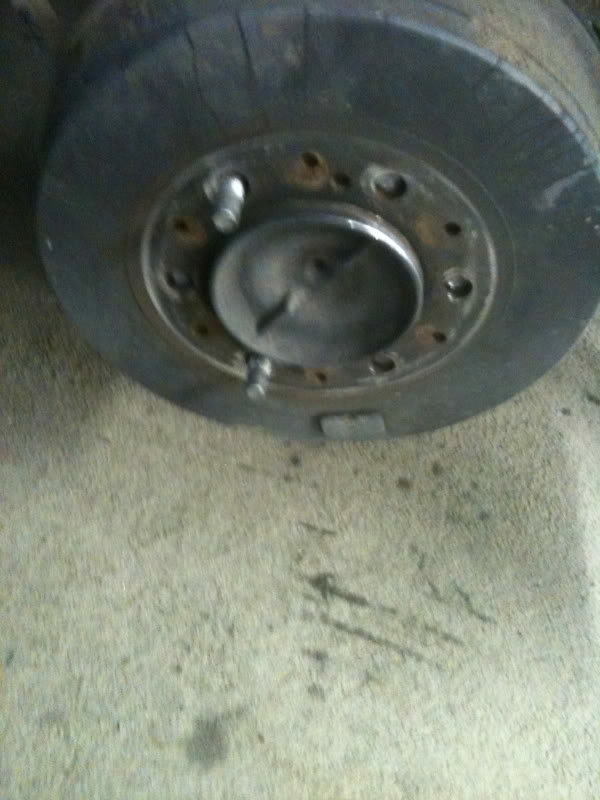

    Just an little FYI, adding spacer puts alot more stress on the stock lug studs. And as you can see from the picture I snapped my studs, 4 outta 6 on the left and 3 outta 6 on the right. For those who plan on not pushing their truck hard off road I'm sure this is a none issue, BUT if you plan on hard romping I would advise against. I had the spacers on for no more than 8k miles.

    I dont see how that happened if there installed properly and regularly checked for there torque settings every 5,000 mi or so. Spacers are not set it and forget it. Ive had mine for 3 years and no problem and I do wheel hard for stock...broken skid plates, damage transmission pan and dented cross members up front....my fault dont have a lift lol...but hey anythings possible i guess :)

    It really shouldn't put much more stress on the lugs. The spacer is still hub centric and that hub circle will bear a large amount of the load. The lugs are really just to keep the wheel from coming off the hub I believe.

    It's best to have the load resting on the hub and not the wheel studs. Hub-centric is without question the way to go if you don't want your wheel studs sheering off.
