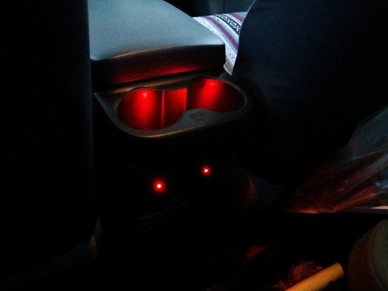

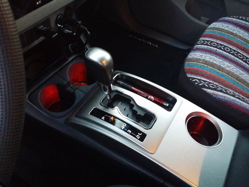

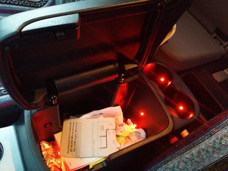

    Well been on the forum for a while and noticed some good ideas. So I pulled the center console apart and installed some red LED's in the cup sections, three in the inside of the center console and two on the back side pointing towards the rear cup holders.

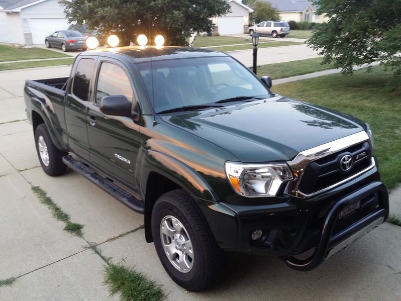

    And finally got four of my KC lights on my McFly light bar wired up. Still waiting on my two bull bar fog lights. The company I bought them from sent me used ones......They are suppose to be on the way now, and they threw in two KC stone guards for the trouble...

    10 LED's cost $6.99 free shipping http://www.ebay.com/itm/390795548456?_trksid=p2059210.m2749.l2649&ssPageName=STRK:MEBIDX:IT
    10 Led holders cost $2.99 free shipping http://www.ebay.com/itm/390909879324?_trksid=p2059210.m2749.l2649&ssPageName=STRK:MEBIDX:IT
    Wago lever nuts cost $7.95 shipping $1.95 ? http://www.ebay.com/itm/140374632242?_trksid=p2059210.m2749.l2649&ssPageName=STRK:MEBIDX:IT
    Very easy to pop the sections out. Drill 1/4" holes. Pop in the retainers, slip in the led's. Use the Wago connectors to hook together. Connect all the wires to the bulb at the shifter, and they should be able to dim...

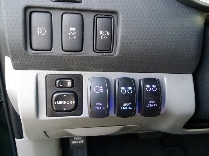

    were did u get your "spotlight" switch for dash they look oem and thats what i need. thanks!
