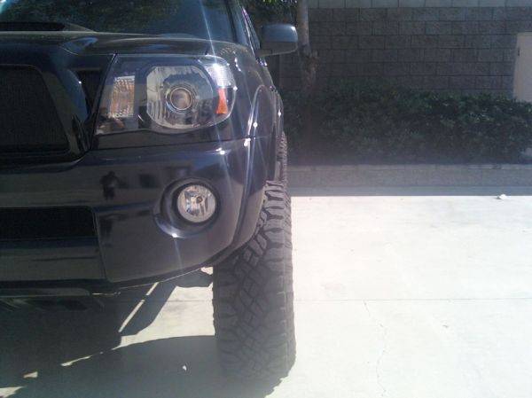

    1BlkT

    Well I snapped a quick cell phone pic must of had a shaky hand cuz my alignment looks a little off here.
    As you can see the front sticks out more than the rear. I'm not positive but when I bought my Allied Spindles the guy told me the stuck out 1'' per side. IDK if that's true or if they are the same as Camburgs now but hey you get the idea. 285 tire with 4.75'' backspacing.

    Thanks 1BLKT!!! Yeah it looks pushed out about an inch or so more than the rear.
