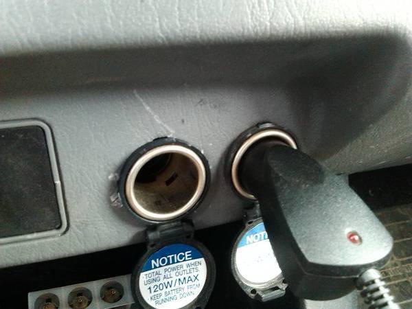

    I just tapped into one of the 12v outlets. Had to wrastle with her a bit, though...
