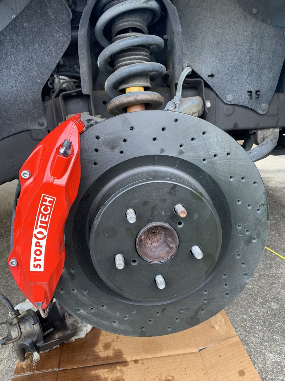

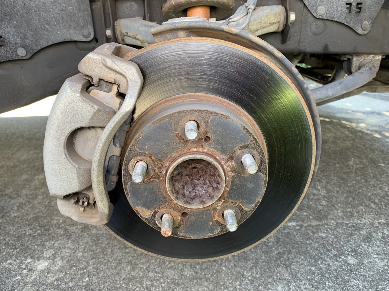

    My 2008 X-Runner's brakes were exactly the same right off the dealer's lot. It drove me up the wall. I took it back to the dealer, but was assured it was "normal" for my Tacoma. I bled it multiple times, but that never corrected the crappy brake pedal feel. It still felt like I was stepping on a mushroom (or whatever the NASCAR people say...lol)
    I finally installed a BBK about a month ago, and that finally corrected the issue. No idea if it was the tiny front caliper, the rubber brake hoses, or what, but it finally feels right.
    I went from this crappy set up:
    To this fantastic set up:
    The 6-lug Tacomas come with much beefier brakes, where the 5-lug Tacomas got the crappy front brakes.
    Lumberjackcoma likes this.
