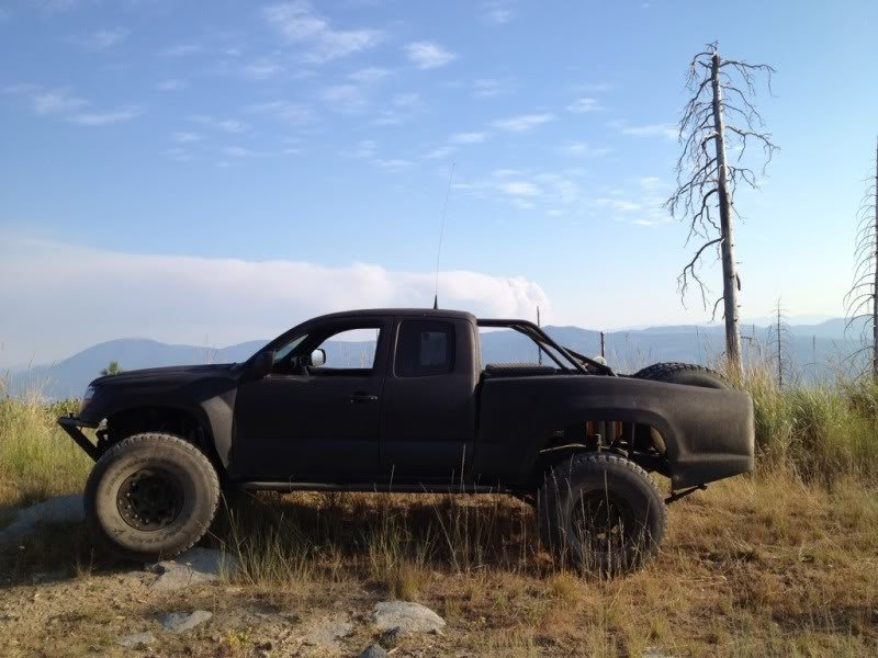

    I'm not condoning this by any means, but you can go whatever speed you want with your rear locker really.
    I've engaged mine doing 40ish mph granted I am on auto so it is a little smoother. I've driven 80+ with it engaged on a trail or two.
    This guy has engaged his doing over 100 mph, just let's off the throttle and maybe depresses the clutch not sure) and has ran it right up to the speed limiter when he is out in the desert:eek: That is with the factory e-locker and 4.88's and yes those are 37's on there.
