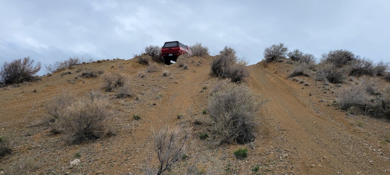

    Get a tune. Seriously. No issues or even slip at about 40deg:

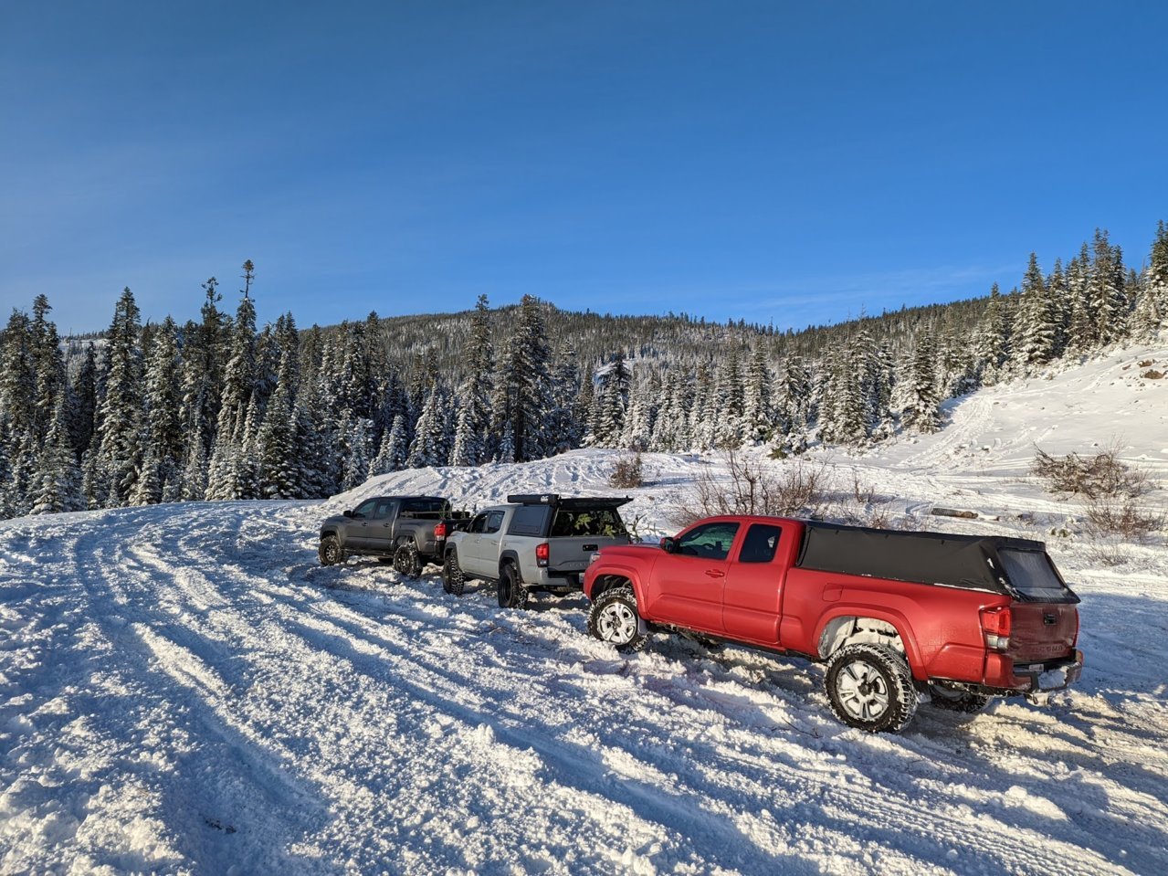

  17. May 23, 2022 at 10:36 AM
    #17
    tonered
    tonered bartheloni
    Sep 25, 2017
    #231055
    31,188
    tony
    Lynnwood, WA
    We were for sure not struggling to get anywhere on this Christmas Tree Hunting day.

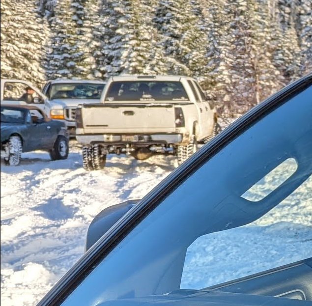

    But, yeah, Miata:

    Lookit them knobby tires on that Mazda. I seriously want that car. Imagine floating across a technical with the top down, skating past those that are winching out due to its light weight and high momentum. That's a riot of a good time.

    It had either a factory LSD or welded diff.
    The thought of taking it up some tougher trails did cross my mind. It is supposedly running around that area pretty often.
