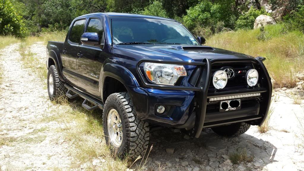

    Now understand..LED light bars will never have the throw that traditional "Old School" off road lights have. They produce a much smoother & intense beam at closer ranges. The nice thing is they barely use any electricity and the bulbs never break or burn out. I spent a lot of time on South Texas Ranches and over the years on our ranch trucks we used. KC, Dick Cepek, Bosch, & Pro-Comp off road lights, so I like to think I have a fairly educated opinion.
    I originally bought a Rigid 10" SR Combo (spot/Flood). I was not that impressed with it. My 35W HID headlights washed it out, you could barely tell it was on. I did some testing without the headlights on..where I blacked out the spot or flood LEDS with electrical tape. When I blacked out the flood, you could not even tell the difference. When I blacked out the spot lights, the flood lights were about as bright as my DRLs(I am not joking). I removed it and never even used it. I am sure a 30" or 50" produces a light more light, but I am not going to spend over $1000 for offroad lights. I try to buy American, but MY wallet comes first.
    I did some research lately and I discovered just about everyone of these imitation Rigid Lights you see on Ebay with no brand, or some popular vendors on TW, or "Cree" or another brand like Hanma....is made by Totron. I found 30" SR SPOT light bar on ebay from http://stores.ebay.com/eg-motor?_rdc=1 for $180(free shipping that came in 3 days from china! & this store had a 99.6% rating)...I got it and I was really impressed. I doesn't throw as far as my Hella 700 HIDs, but it fills in everything very nice. And by itself, this Spot LED is more like a "Eurobean" or narrow flood light.
    These LED lighst are real popular with the Razr & Can-Am ATV crowd...and many of their forums say They can see no difference in the beam from a Rigid to a Totron bar.
    I have notice the Spot on these LED bars come in either 8 Degrees or 30 Degrees. I have the 8 Degree bar.
    If I were you...go with the Spot or Combo.
    If you end up buying a Totron bar off ebay, be careful. The first Gen do not have Cree Bulbs in them and are much cheaper, but look the same...be sure you are purchasing the second Gen with the "Cree" bulbs. There are some new 10W CREE bulb coming out, but those bars are slightly larger.
    Good Luck with your project.

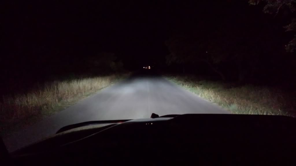

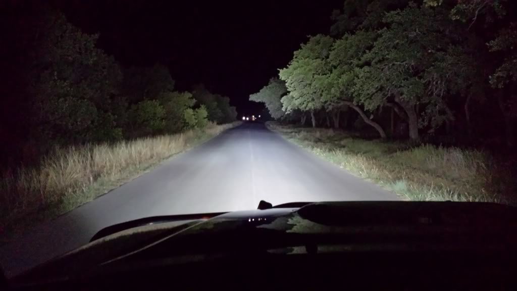

    ^^^^ Exactly what he said on the spots are basically flood.
    This is where I got my LED light bar..they have a 99.6% rating and have a ton lights to offer. http://stores.ebay.com/eg-motor?_trksid=p2047675.l2563
    35 HID headlights only
    Headlights & 32" Totron LED (Spot)
