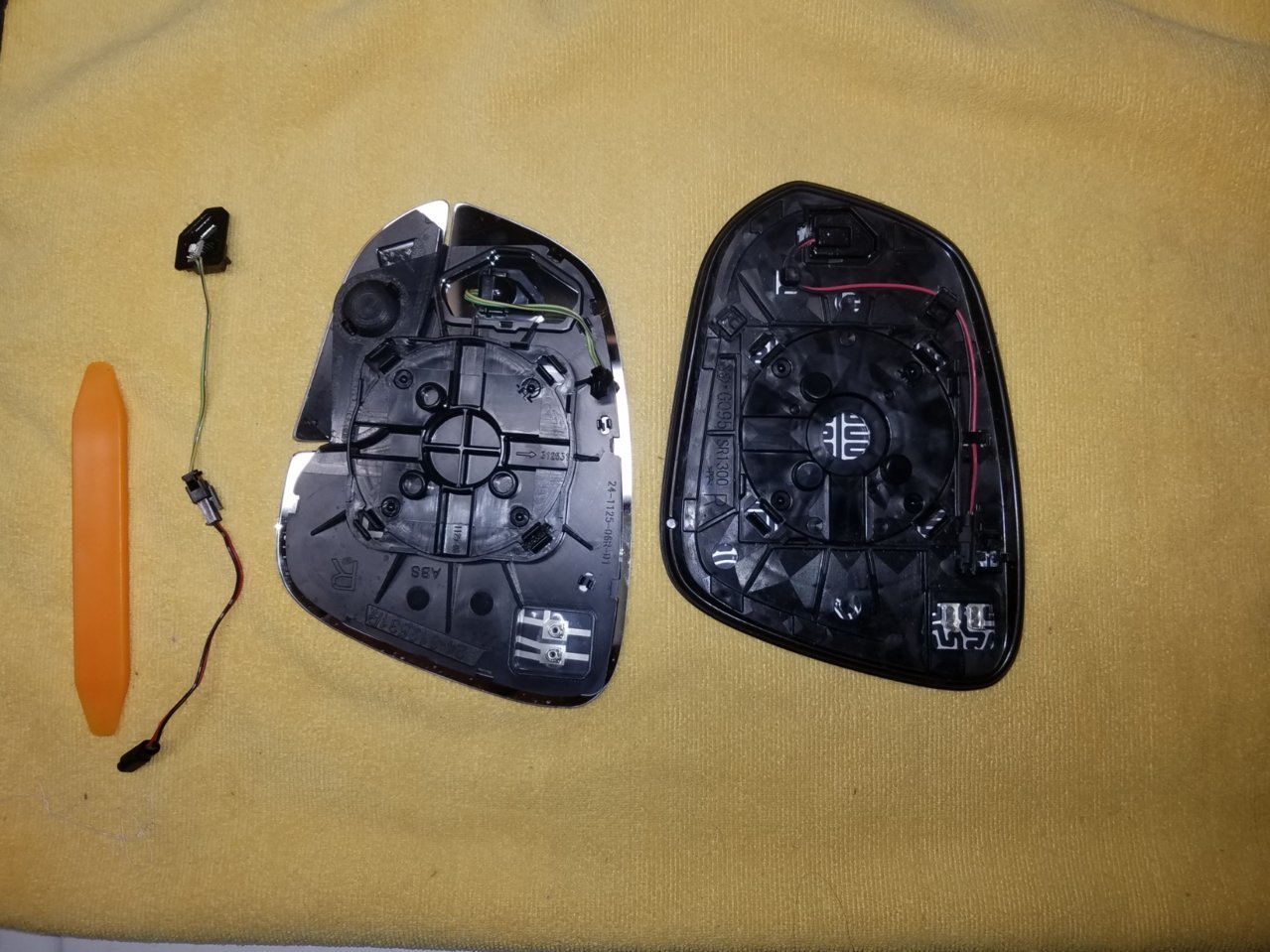

    Spotter mirror with the BSM can be found here, but the light output for the *older BSM alert is much less than the original OEM light output. *Edit: Spotter Mirror recently upgraded their light. Apparently, the new Spotter Mirrors Blind Spot Alert achieves the same brightness as OEM. :thumbsup:
    This can lead to a false sense of cars not being in your blind spot because the light doesn't flash like normal, especially in direct sun conditions.

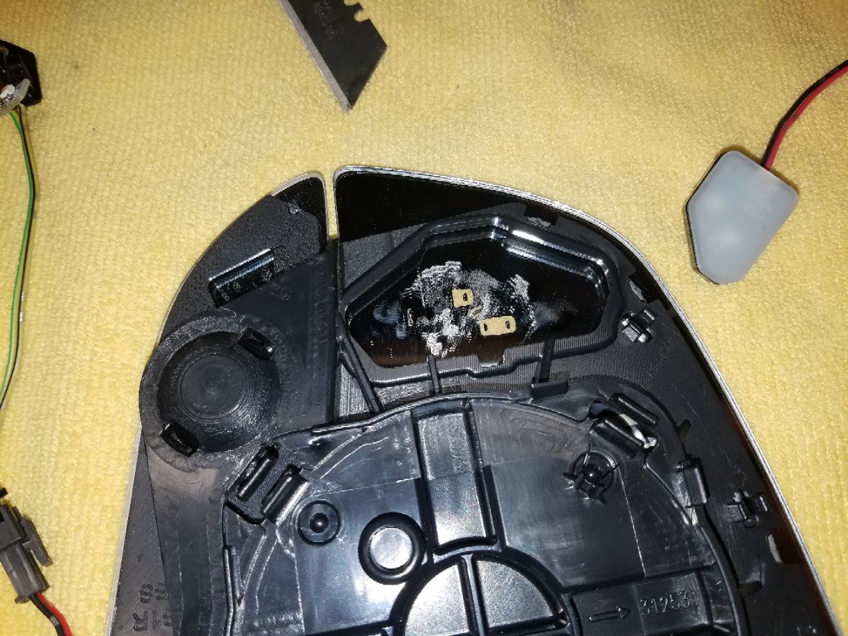

    My solution was to remove the Spotter Mirror light, and replace it with the OEM light.
    Spotter mirror light:
    OEM light:

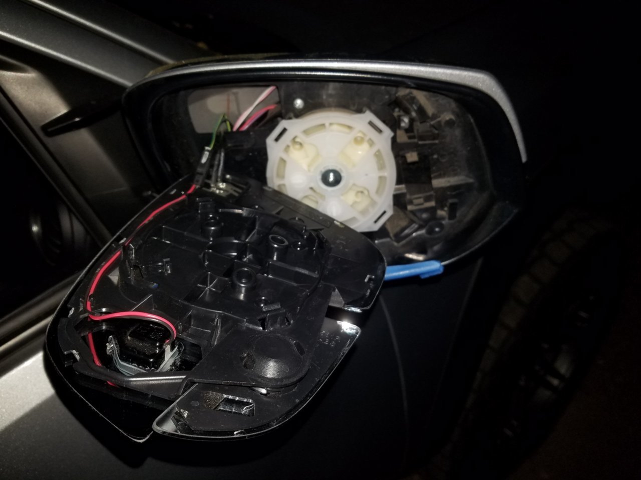

    Remove the Spotter Mirrors:

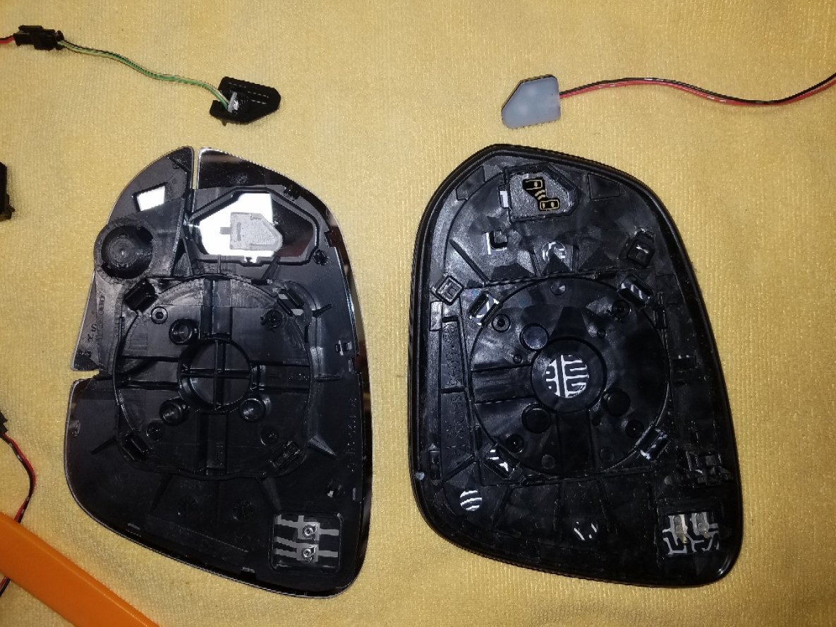

    Here's a comparison photo of the passenger mirrors (OEM mirror is on the Right): 20210418_190745.jpg

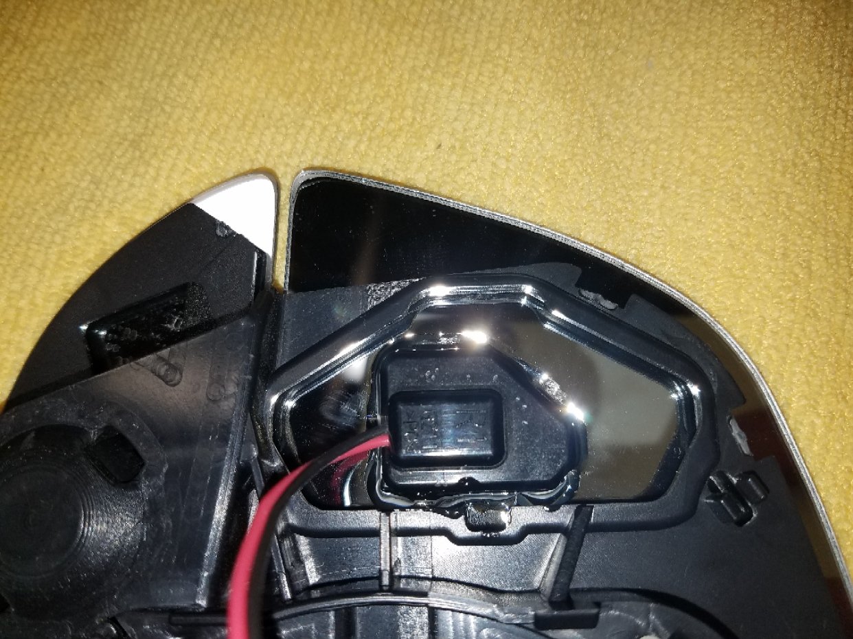

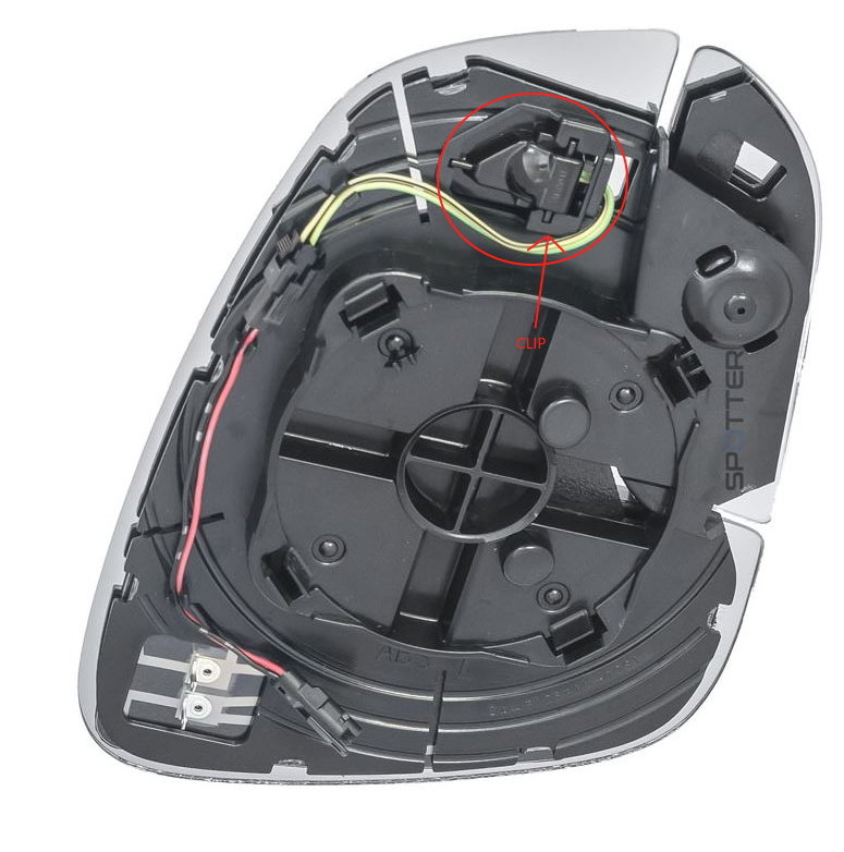

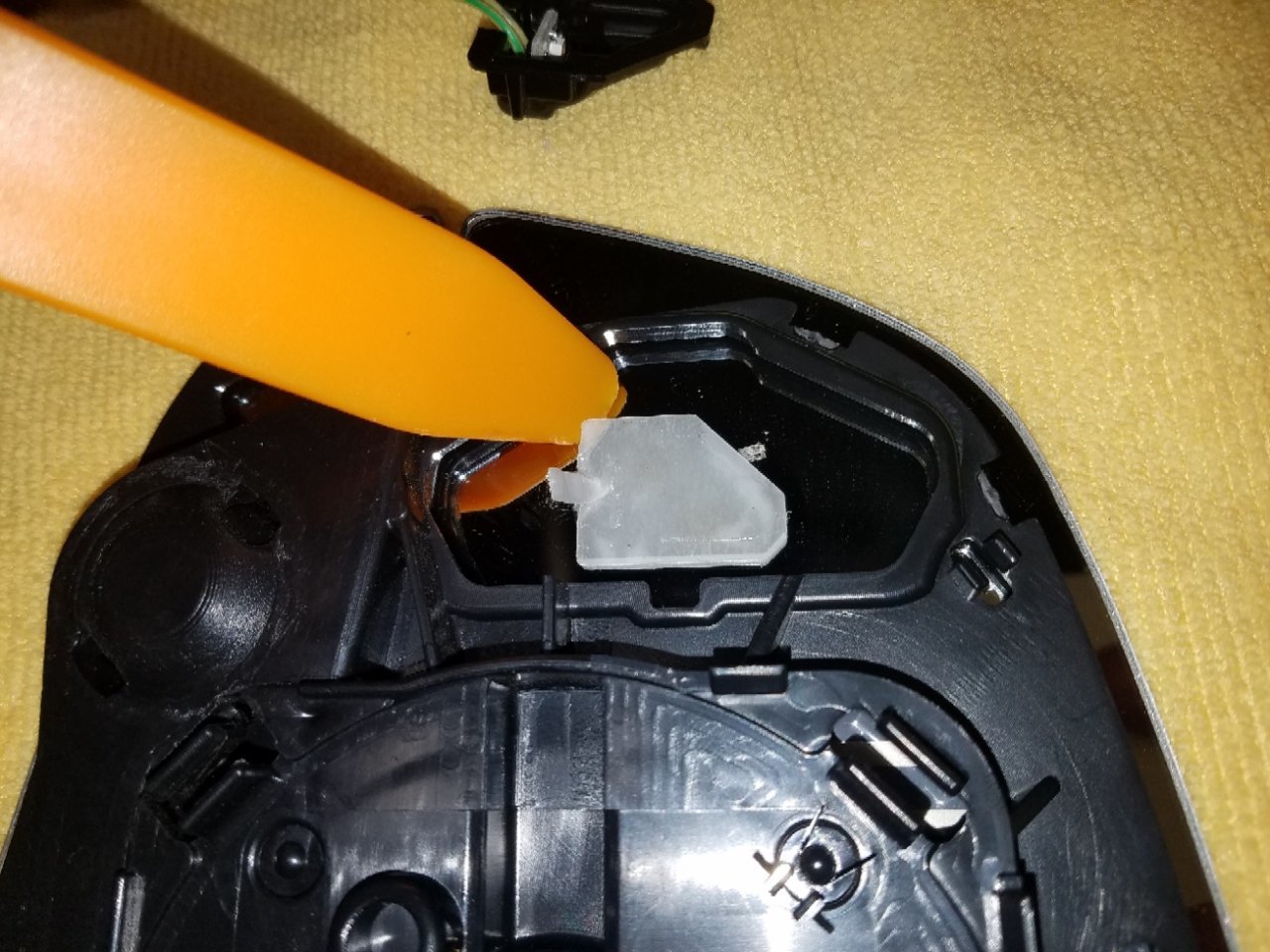

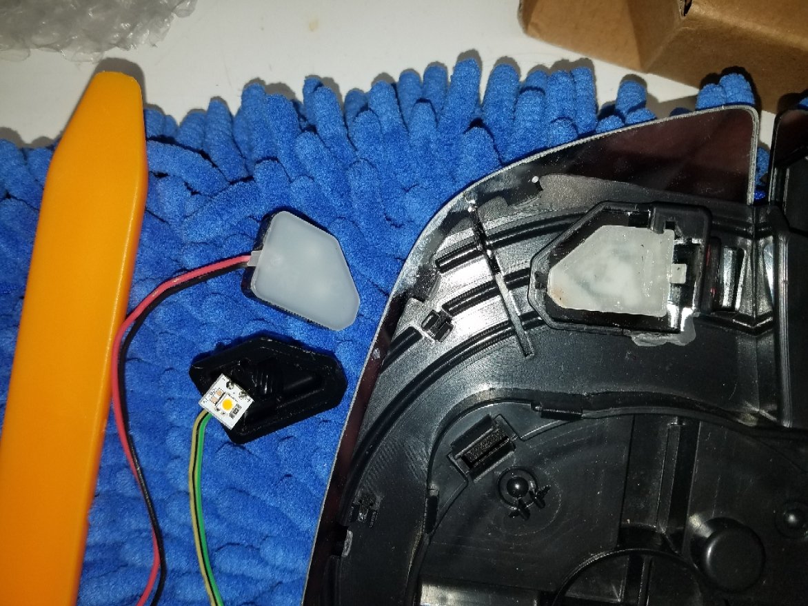

    Start by removing the Blind Spot Monitor (BSM) lights from the OEM mirrors and from the Spotter Mirrors using a blade, pry the light from the double-sided tape (note: see picture below, the Driver side Spotter Mirror is different, and you need to break a clip to remove the BSM light):
    Again, here are the passenger mirrors for comparison, but with the BSM lights removed:

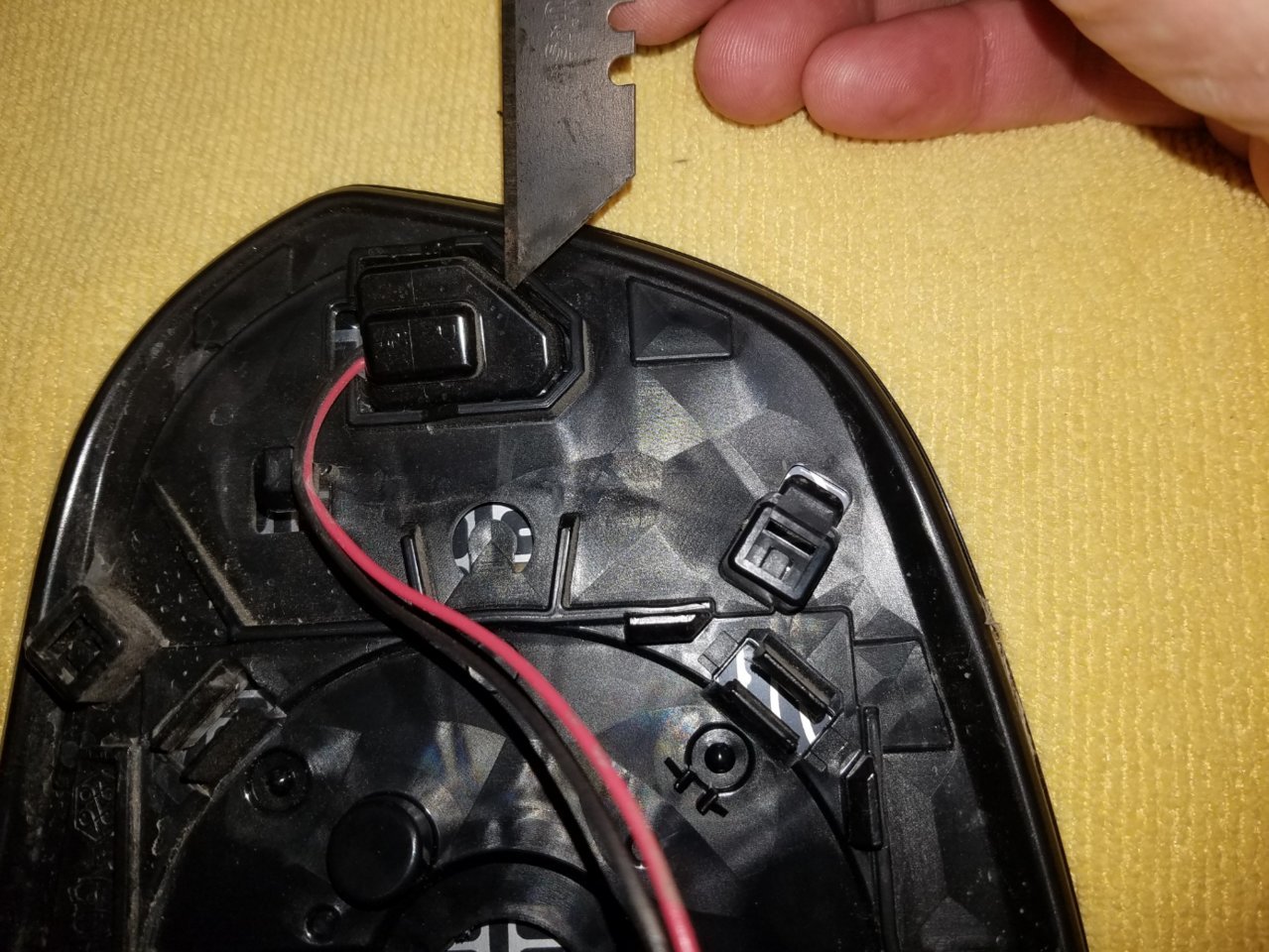

    Here is the Spotter Mirror Driver's side with the bottom clip broken off to remove the BSM light:
    Picture of the Driver's side mirror before breaking off the clip:
    Removing the double-sided tape from the Spotter Mirror:
    The Spotter Mirror should look like this when done:

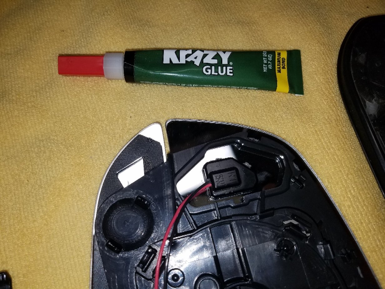

    Align the OEM BSM light over the Spotter Mirror symbol:
    Using Crazy Glue Gel, glue the edges of the OEM light to the mirror. Let it dry for 10 minutes before handling (note: the Driver Side will look slightly different - see "bottom clip broken off" picture above). Be sure to use superglue spairingly as too much will show through the opening in the glass:

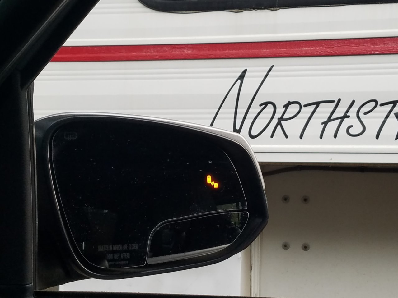

    Plug-in the mirror, and try it out:
    Spotter Mirror BSM Light:
    Spotter Mirror with the OEM light retrofitted into the mirror:

    Ok - here are some after pictures taken late afternoon on a drizzly day. Exposure sucks/blurry w/BSM on, but in person they're crystal clear and sharp. At night they really do catch your peripheral vision. Thanks again @RyanDCLB for the excellent idea and mod!
