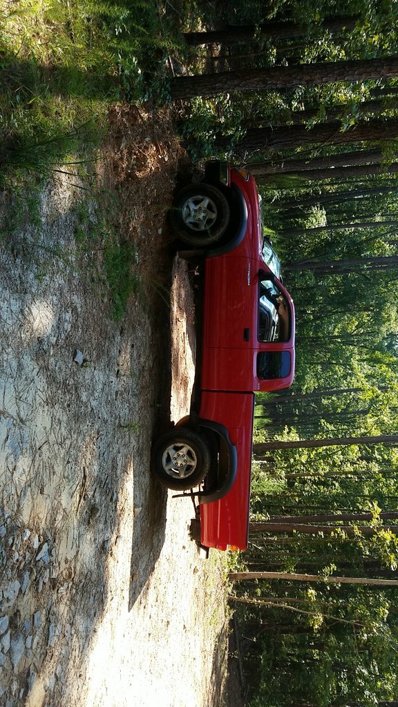

    My stock wheels are very pitted and chipped and look like crap. My tires still have a lot of tread so I am going to delay buying new wheels until I can get tires at the same time. For now I want to put a wire brush to them and sand them down and paint them black. I was thinking like a matte black Rustoleum but I've heard good things about plastidip. What would be easier and what would come out better and last longer?
