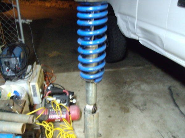

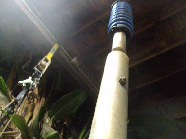

    Believe it or not, this is going to be a spring compressor when I'm done...
    (hopefully..:D)

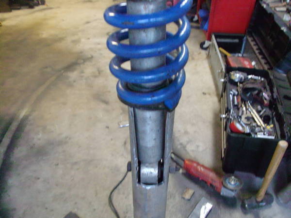

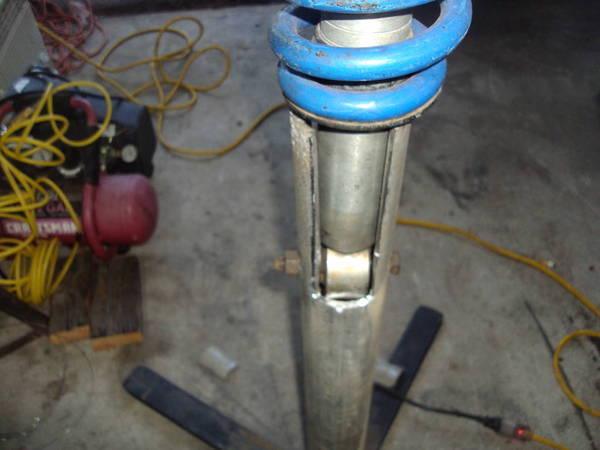

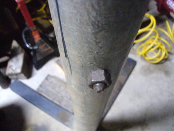

    I need to open this one side, the hole & retaining bolt to hold strut eyelett is already centered & drilled out...

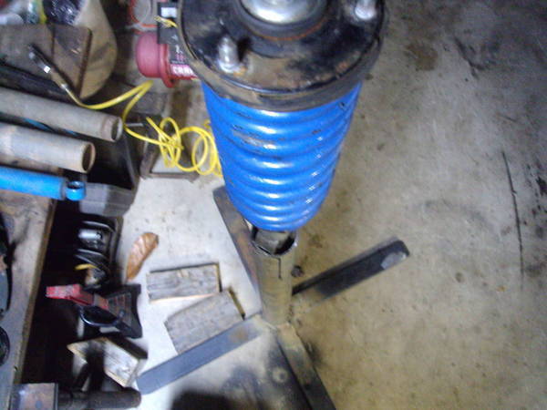

    There will be another stand attached to the strut pole which will be centered over the strut with a 3 ton hydraulic bottle jack for a ram & attached to it will be a 3" dia. piece of black iron pipe w/1 windowed side so you can put the srtut nut on while compressed..

    Haha, hopefully not straight into a wall....:D

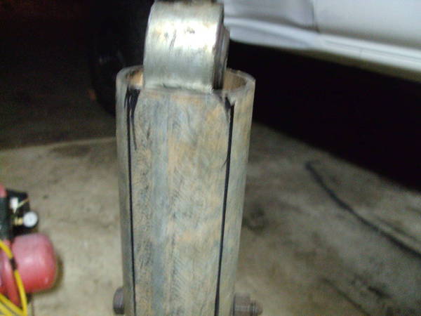

    Starting to shape up.....
