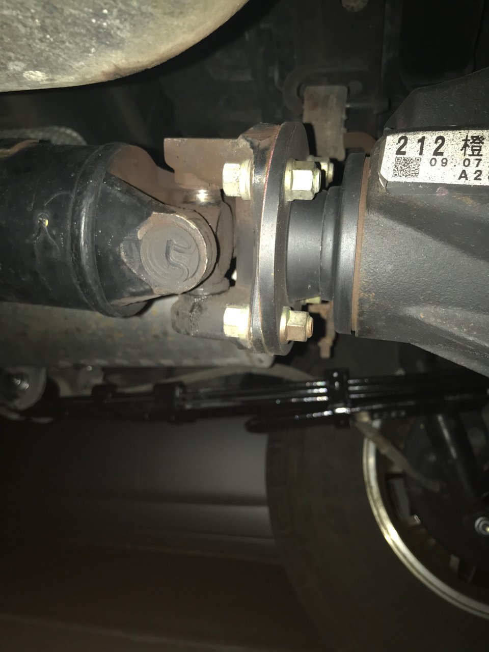

    pic#3 the shiny bare metal is where its bad, the rust colored dust is coming off the roller bearings inside from losing the seal to hold grease in.

    How many miles ago was the center support replaced?
    I wouldn't reccomend going back to this shop, I think they overcharged you on the center support part and the labor, and failed to inspect the other u-joint when their first recommendation was to replace the u-joints. But I'm not sure fixing the rear u-joint takes care of the noise you are experiencing. That could be it, but a some members have had aftermarket center support bearings fail on them with only a few hundred miles. I would almost go back and have them do the last one, then replace the center support with a Spicer if the noise persists. IMHO I think it will.
    Either that or go to a trusted reputable shop and get a second hands on opinion. But the first shop should really try to make it right if they are a reputable place.

    They might just replace the u-joint and charge you the $20 for the part, but I still think the noise is coming from the Anchor carrier bearing, and that should be replaced without labor for sure. You should only cover the cost of a replacement part over the original part cost. I'd pay someone else to replace it rather then pay them twice in two weeks to replace the same part.

    If you drive that go slow and do not do any high speed driving. That joint could let go at any time, I wouldn't want to hear about you getting in wreck or that shaft causing someone else to.
    I cannot believe that they didn't see this when doing the other two. The best rule of thumb is if one is bad they are all probably suspect and should be replaced.

    So I got that rear u joint replaced today and the squeak seems to be gone! Thanks for all your help, everyone! I really appreciate it.
