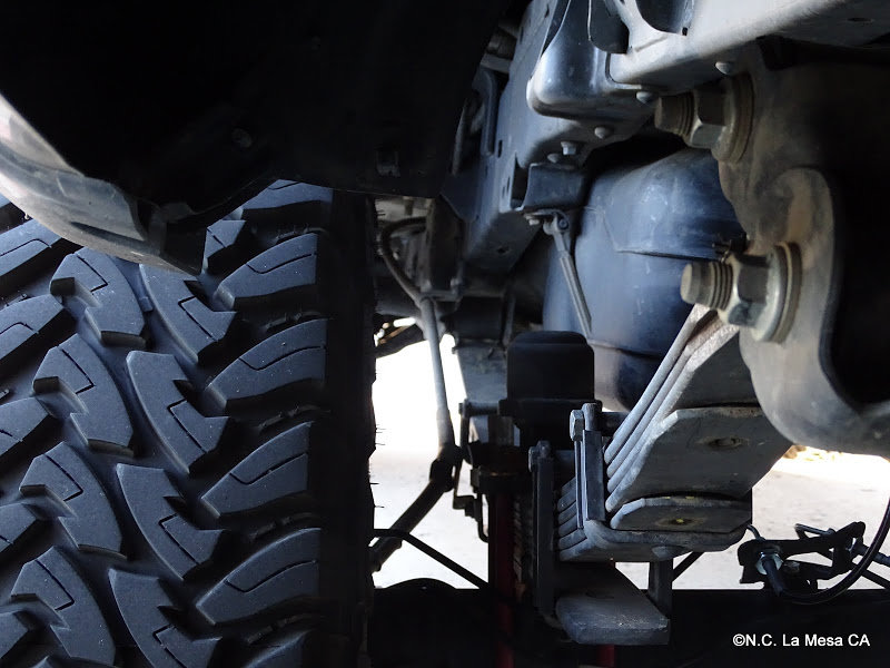

    I thought this was a picture just showing that the zip ties walked their way down.

    Ya know, that could very well be. For some reason, I didn't think that they could have "walked" down that far on the leafs...

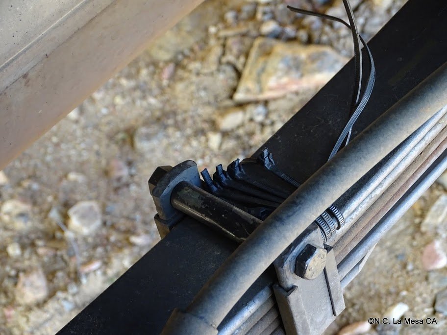

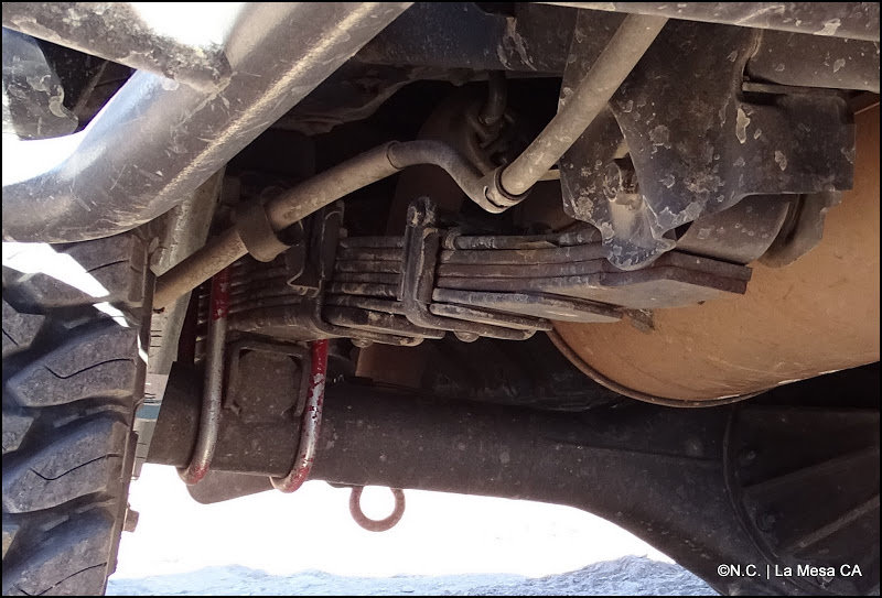

    Great. I would recommend trying it the way Cape Codder did his. He wove the zip ties around the second leaf. I don't know if he off-roads, but in his report, his zip ties did not move in 7 months.
    I did mine a slightly different way by only wrapping the main spring. The issue with that is, the zips will walk down the leaf when the spring pack flexes. I solve that by tying the zips to the bushing eye. The issue with that is they don't hold forever, and will break.
    Cape Codder's example:

    But you better not cut the ties like he did or else you'll get internet flaming. Make sure to use the twist method! :facepalm:

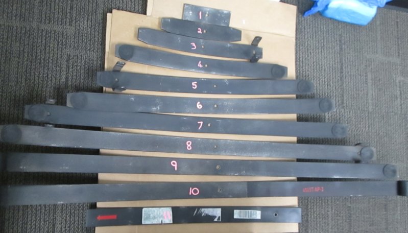

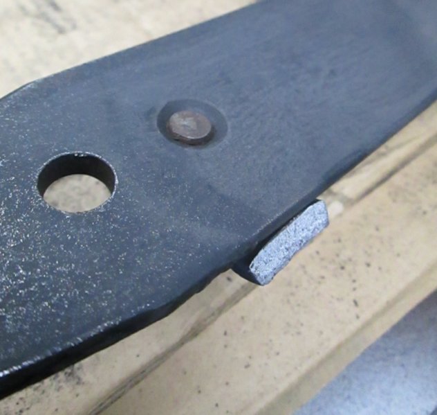

    I've said this before, but if I was doing this again. I'd cold drill the ends of the leafs and install leaf spring spacers. Many OEMs do that. My Toyota Leaf pack which I ran for 5.5 -years 55K miles never made one squeak in it's entire useful life.
    Here is an example of an All-Pro leaf pack. See the hole drilled?
    Photo Credit @tyfoon11
    Spacers / Silencers go into the holes. Look at All-pro disassembled leaf pack, every leaf's end has one.
    The Dakars squeak because they are missing that in their design / assembly, specifically, the leaf under the main spring.
    If drilling holes is too much, Zip tie / ty wraps method and dry molly lube spray.
