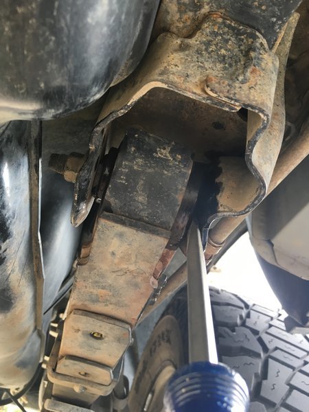

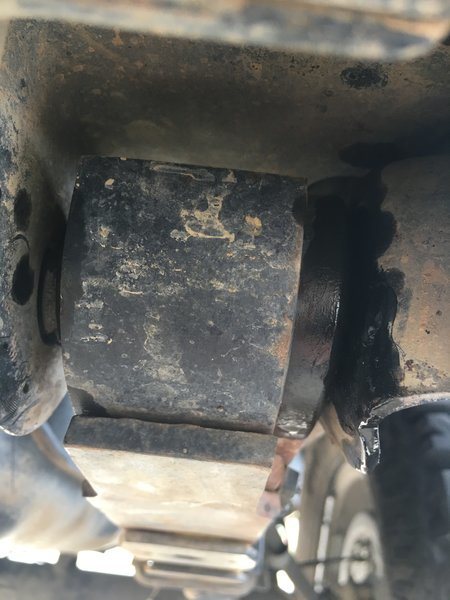

    I think I found out why my Dakars are so squeaky....the bushings in the rear are moving around. They are also squeaking from the front as well. I ordered a new set of bushings for the front & rear from Wheelers.
    We'll see if they continue to squeak after I replace the bushings.

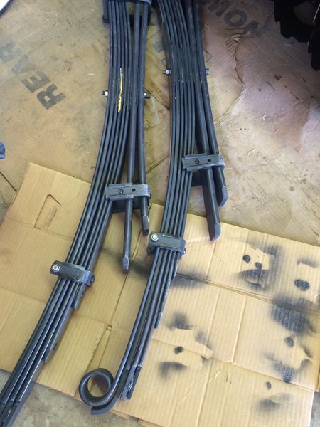

    New set of Dakars with isolators already installed. Added the aal but had it drilled and isolators put in before installing into the pack. Had to make a spacer (from plastic ice cream pail) for the center of the leafs as there are thin metal plates already also installed from ARB/OME.
    I needed longer center pins (which I had already ordered) so I could install a pin collar for the 3* axle shim I'm putting in. The new pins are the perfect length for the added collar and aal. Damn leaf packs are so beefy now.

    Had a local suspension shop drill holes and install Dorman leaf spring inserts last week. Today I installed the Dakar leaf pack and so far no squeaks and I wipe it stays this way.

    Can someone take a picture of their installed Dakars utilizing their OEM Shackles. I'm trying to determine if my springs are moving around too much & if I have the hardware installed correctly.
