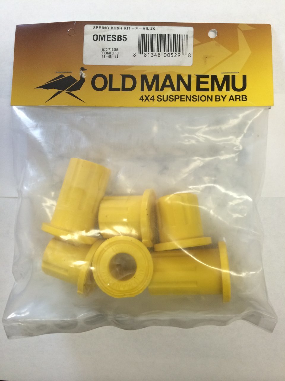

    Haven't had much time to investigate, but while pushing the truck back and forth and listening into the wheel well, it sounds like the noise is coming from both the front and rear bushings. They're the ARB poly bushings. Thinking about disassembling them, slapping more grease on them, then installing greasable shackle bolts and go from there.
    As for the updated version with isolators on every leaf, a few inches back from the front bushing, the leafs make contact which may also be an issue. Say hello to the lovely NYS salt and sand!

    I agree with you on the poly bushings. I used Energy Suspension poly bushings when I installed my leaf packs and I used the supplied grease that came with them. Mine don't look as dirty as your leaf packs but I can hear a bad creaking sound with any movement of the truck suspension. I also tried to see if I could feel where it was coming from and it seems to be felt more by the front and rear bushings as you described. I'm not looking forward to taking them apart and re-greasing them.

    So, I’m curious as to what part of the poly leaf spring bushing would be creaking.. Would it be where the bolt goes thru the metal sleeve in the bushing or is it the outside of the bushing, where the bushing and spring eye are contacting. Or could it be where the bushing rubs on the spring hangers. I don’t think it’s the actual leafs in the leaf pack making the noise. It’s gotta be the polyurethane bushings. Anyone have any ideas?
