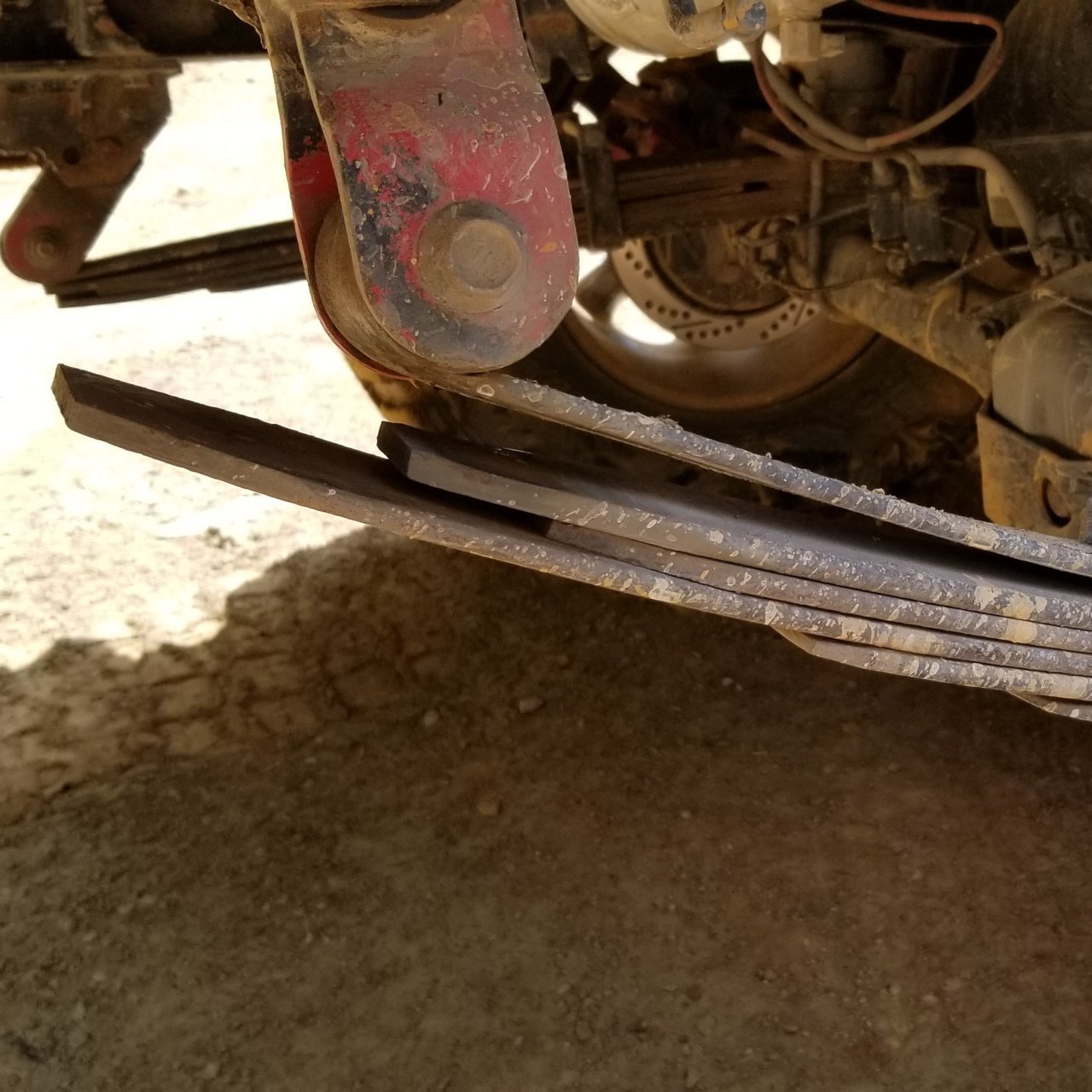

    Sooo, what exactly caused this? Nice brakes BTW.

    Too much flexing over the last two years, probably too much weight for the springs, and a good possibility my traction bar may have had something to do with it.

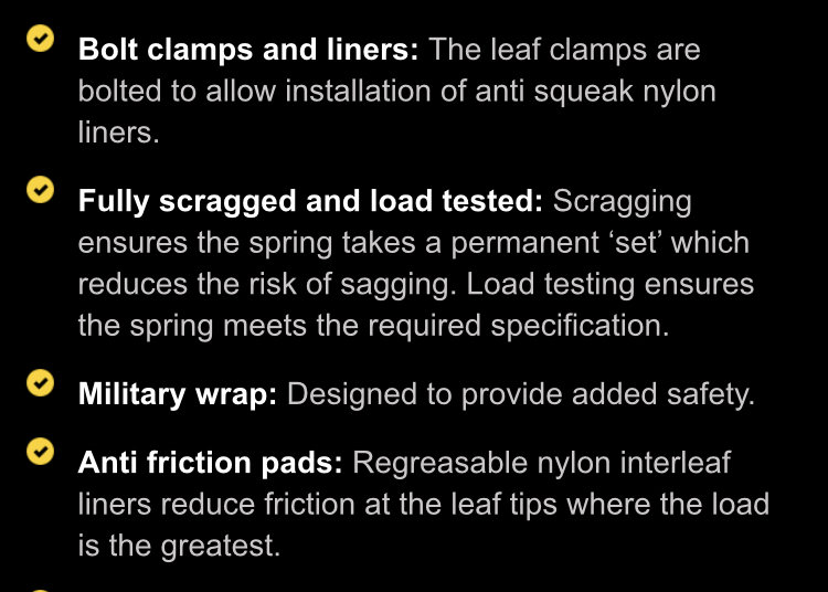

    In the same boat. Looked at mine and saw some pucks in between the leafs. On the OME site: B7EC71E4-B580-4895-A3BF-2E65160A06D0.jpg
    “To allow installation of anti squeak liners” means not there though...? Guess anti friction pads are different... What are those pucks then...?
    Edit: These are them. Doesn’t look like I need to add anything or at least take them apart for any of the other fixes.

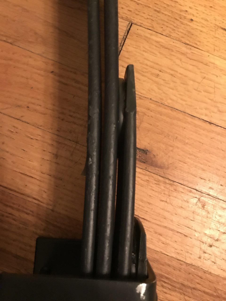

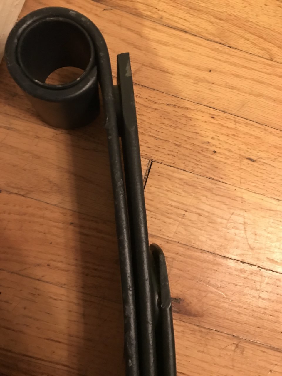

    DF1A01D8-7618-4F15-AB82-363B94D35325.jpg C1B5D5C0-EA19-405F-ACF0-D16A7CA2AB03.jpg

    I used two packs of the speedway 2 1/4” leaf liners on my hd pack I just installed and had left overs. I ran them in between all leafs from the anti friction pads to the metal plate spacer things in between each leaf.
    I also ordered a set of the dobinson greasable bolts for the front bushing. I then drilled two holes through the metal bushing spacer to let grease get to all areas of the bushing.

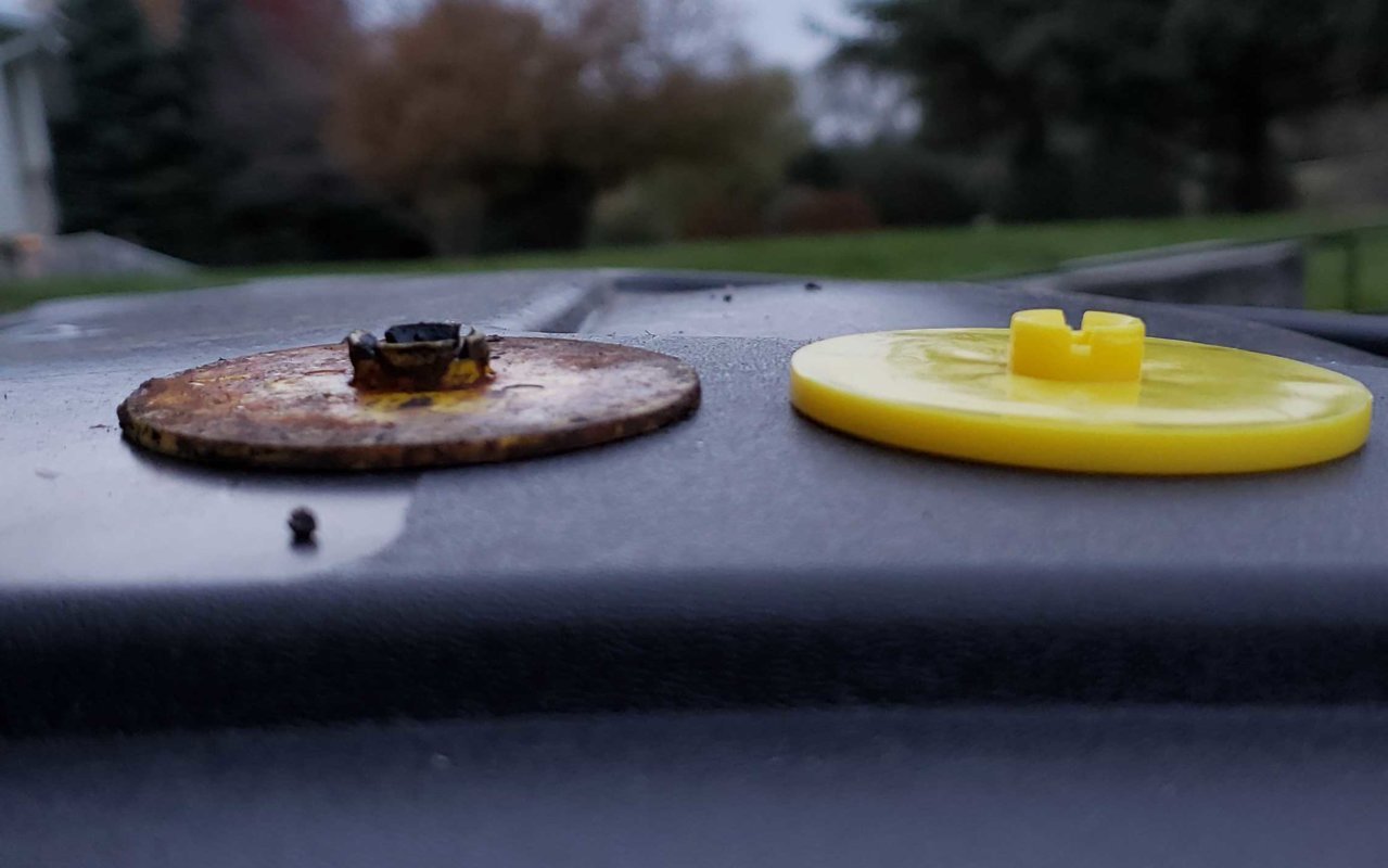

    Pop quiz. Anyone got the zerk size on the pin? One fell out right after I left the shop and installed. Probably not screwed in all the way. Need a new one....

    I had a clunk from my leaf springs..found that the spacers were junk
    bski22 likes this.
